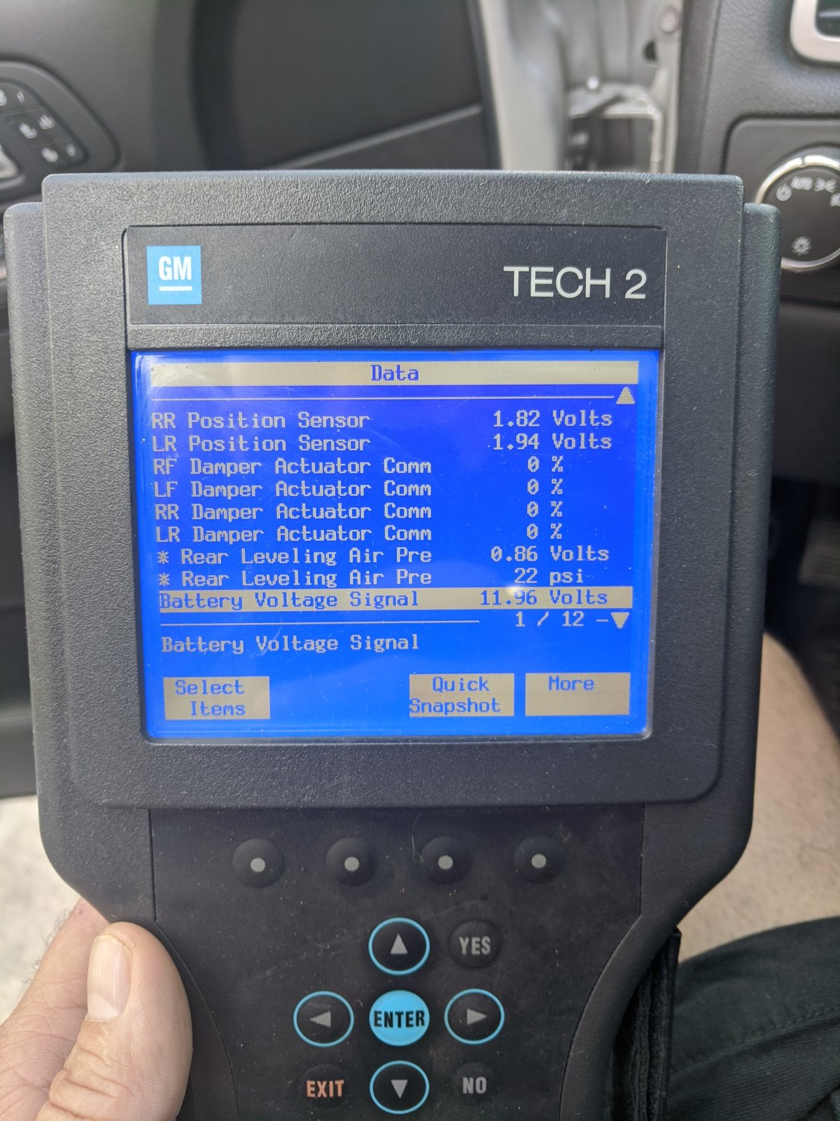

Did you try to command the new pump on with the tech2? I had a faulty ride height sensor in the rear, replaced and all senors seem to be within voltage, but i can’t make the pump come on with the trch2, but the pump will run with key on and air up as needed. The release solenoid I can hear click but don’t hear any air escaping. Is that normal?
I wasn't able to command the old pump to come on with the Tech2, but haven't tried it with the new one yet. If I get a moment today, I will go out and try it again now that the new pump is installed and working great.
Just curious - how did you determine one of your ride height sensors was bad? Was one of them outside of the normal voltage range?
