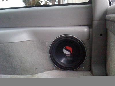

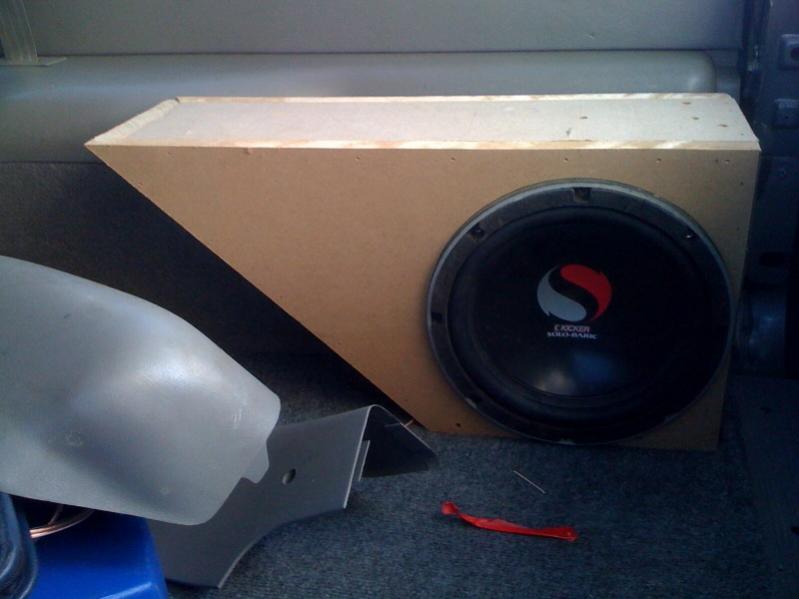

heres what i did to my 2 door.

sorry no other pics basicially measured the space thats back there, made that box and cut out the sheet metal behind the trim panel.after i got the box in there i attached the box to truck with some angle brackets then carefully cut the hole in the trim panel for the 10" sub. i got about .75 cu ft of air space
