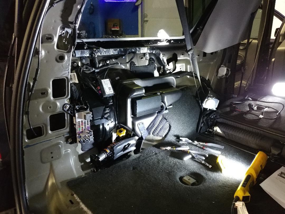

Install complete today. First some perspective. I had a 2002 Tahoe with 8volt eclipse head unit and amps, JL sub and MB Quart component speakers. It was a solid setup that had some serious punch. The stock Denali setup was pretty good in the upper range but of course lacked low end rumble. The kicker sub after only about half an hour of listening does provide the missing low end that the system desperately needed. I imagine as the sub breaks in it will only get better.
As stated in the other review, this unit will not rattle the windows out but it does vibrate the rear view mirror a bit and compliments the stock Bose system well.
I would recommend the VOX app as it is CarPlay compatible and allows you to play FLAC files would sound much better than the standard MP3 files.
A side note, Kicker now lists their part number for this kit on their site and another kit with the sub and additional amp/dsp. Part #PSUTA15. No instructions yet as it is not yet released.

Dealer did the work and they didn't take any pictures. You would never know it is there. I told the dealer about the re-program and when I picked it up, they said they were on the phone with GM tech line and ended up not needing to be reprogrammed. Not sure if they were told bad information or what. Have not heard any negative feedback yet. I did call Kicker and they said at least in the Sierra trucks with noise cancellation that with all the doors closed, rev the engine and if you hear a flutter from the sub, you need would need the noise cancellation turned off. I will give it some time and see if I do in fact need it turned off. There is no volume or gain adjustment per Kicker. My dealer in So Cal charged $280. I wasn't comfortable taking the liability of taking all the panels off without breaking something so if they broke it they could fix it. All went smooth and so far so good.

Well after a solid 5 weeks of listening, I can say that I'm very pleased with the setup. I've found it to be just right for most listening, though in some music choices I would've preferred a 10" woofer to better carry the lower end spectrum.
I have had zero problems with the Bose noise cancellation system, no buzz pops etc..
All in all a pretty good kit!
