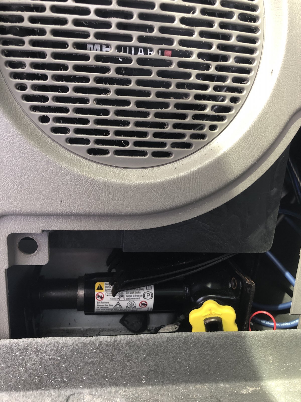

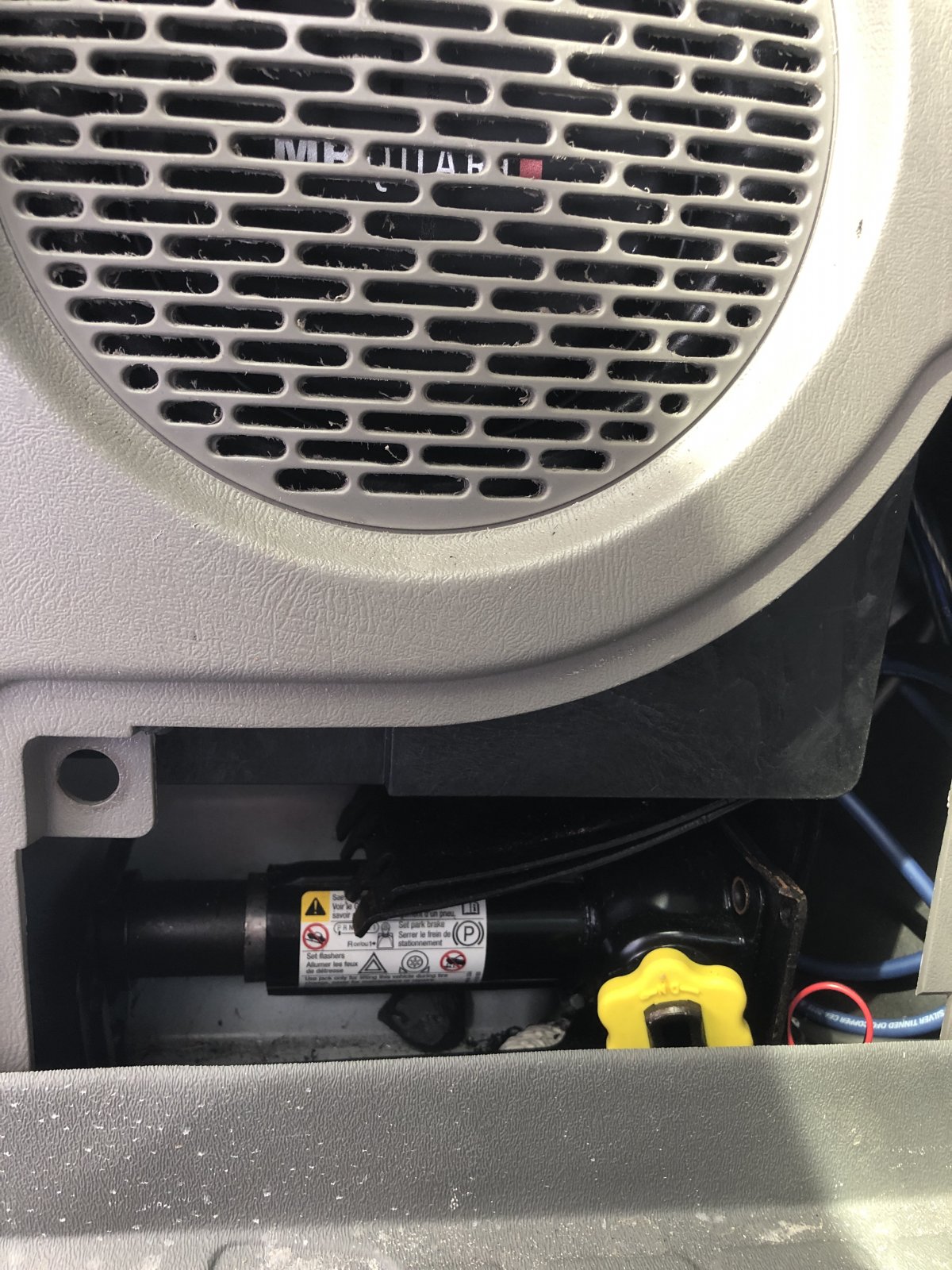

Has to be a shallow mount 8". This is the OEM box below. Those original threads had some great speakers, but a lot have been discontinued. There was a Kicker one that was recommended. Maybe a newer edition would work. I have the box, just never have put a sub in it and missed that Kicker before it went out of production.
Hope this helps a bit more. I can get some tape measurements if you want to see? There might be some dimensions in this original threads as one of the guys did a pretty thorough job of looking at the box and all options.
OEM location.
Threaded bolts that go thru the inner body frame skin. Each bolt had one of the ears break off when pulling it back thru the square holes.
OEM location minus the sub box.

Thanks for those pics, very handy. Helps me visualize it more. And darn, that's what I was fearing. I've been looking around and looked at the links you posted and like you said, most of the decent woofers that size are discontinued or extremely expensive. I have been looking at Kicker and Rocker Fosgate (I've good things about the Kicker C 8in and I have a 12in Rockford Fosgate that works well), and I may go with a Kicker in this instance. Looking at your pictures, though, makes me wonder where I'd place my amp. I currently have it on the third row floorboard but I'd prefer moving it to gain my third row back (I don't allow anyone to sit in my third row due to all the wiring being exposed, afraid someone will trip over it or meddle with it and break something). How much space is there between the top of the enclosure and the covering/panel for that side?

Not much but I do not have measurements. Another member on here I believe mounted one in the the small cubby just forward and wired through there to keep it stealth. Under the 2nd row seats but you probably already have something under there. Not sure what your setup is.
You might be able to mount it on the forward side of the box if you ditch the jack to another location. There is a bit of room not encroached by the wheel well. Again depending on how big your amp is
