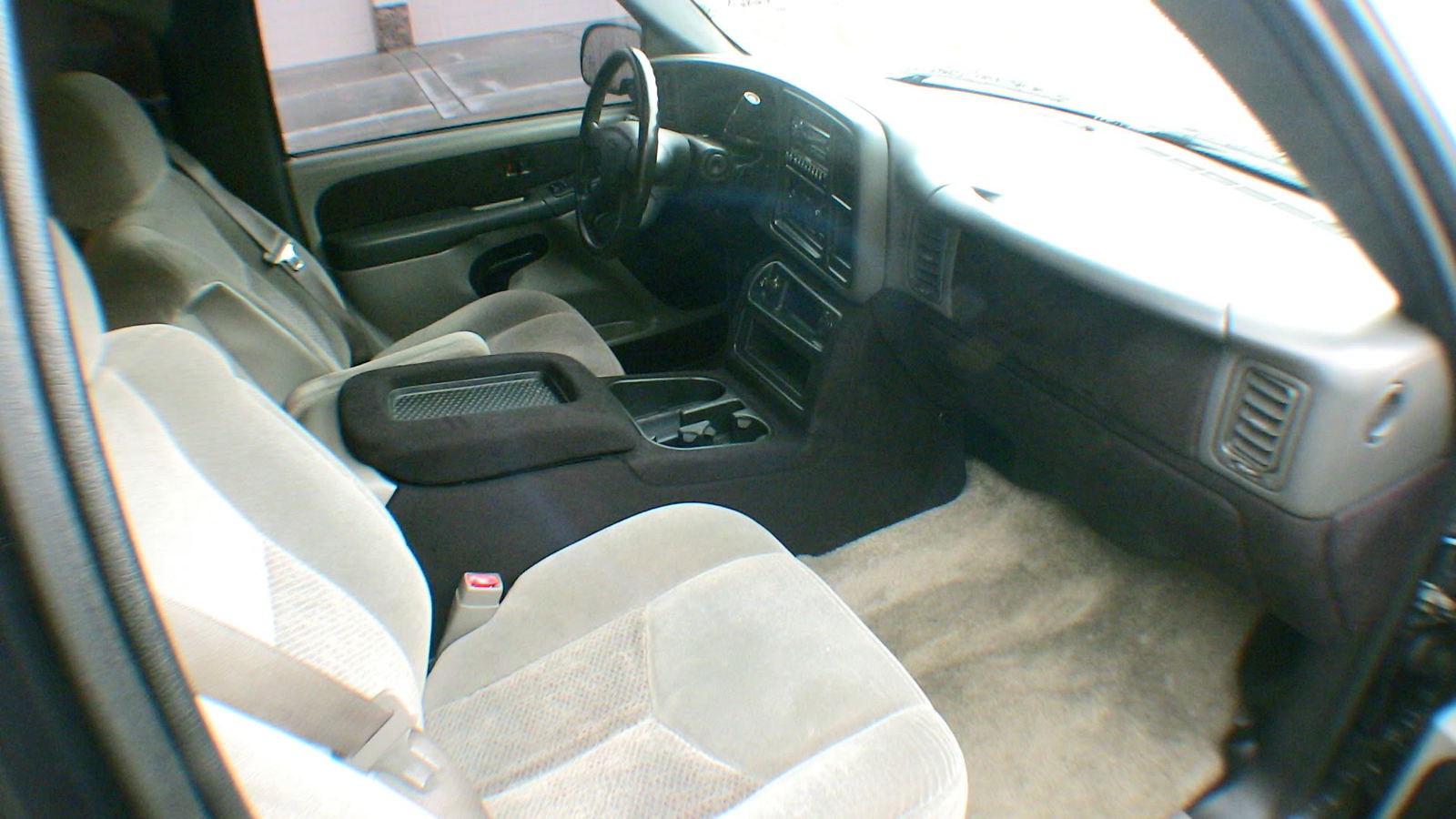

on my door I left it on to do the top part, for the carpet I took it off and masked everything off..
second time I did it on my buddies left the door panel on but still masked off the rest of the door of course..
theres his turned out WAY better than mine but then again I had practice
