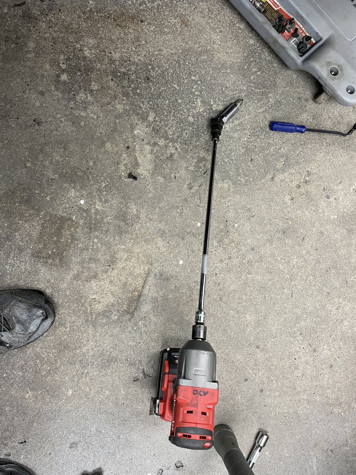

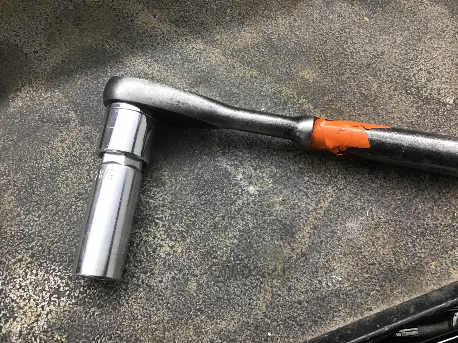

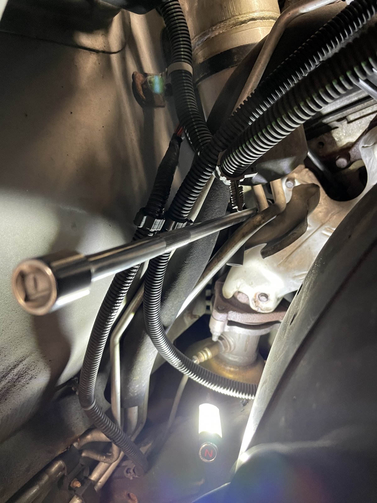

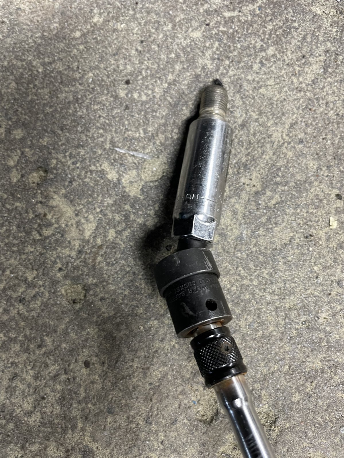

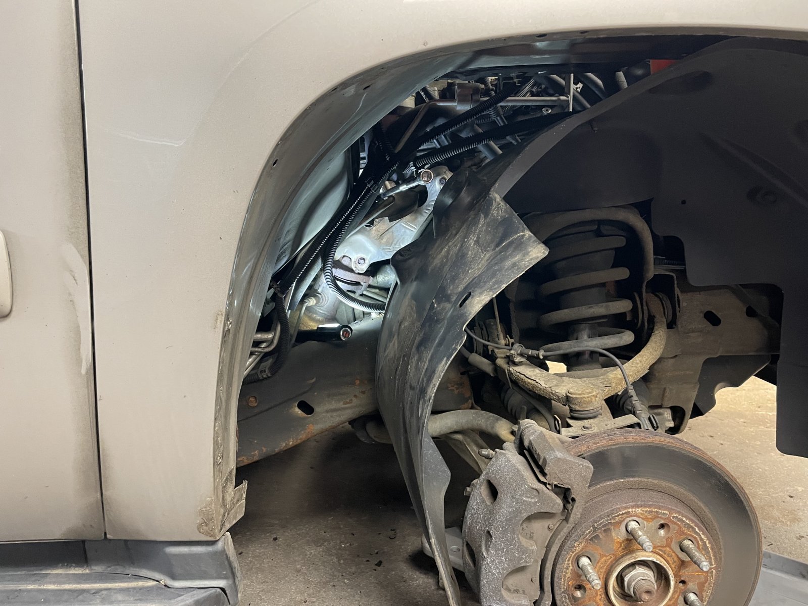

I've found this car quite easy to work on compared to others I've worked on in the past, but the #8 plug is a challange. Makes me wounder how many people over the years have paid for 8 plugs and actually got only 7. Once I pulled the inner liner it wasen't that bad actually. I used a long 3/8" Extension with a universal joint. Perhaps the pictures attached might help someone?

Put the spark plug socket on the spark plug and then use a shallow socket and ratchet to slide over the hex end of the spark plug socket and get it from the top of the motor

No need removing wheel fender, just remove the tire, use spark plug socket, plus regular 3/8 ratchet, and slightly bend A/C accumulator heat shield, the job can be done.
