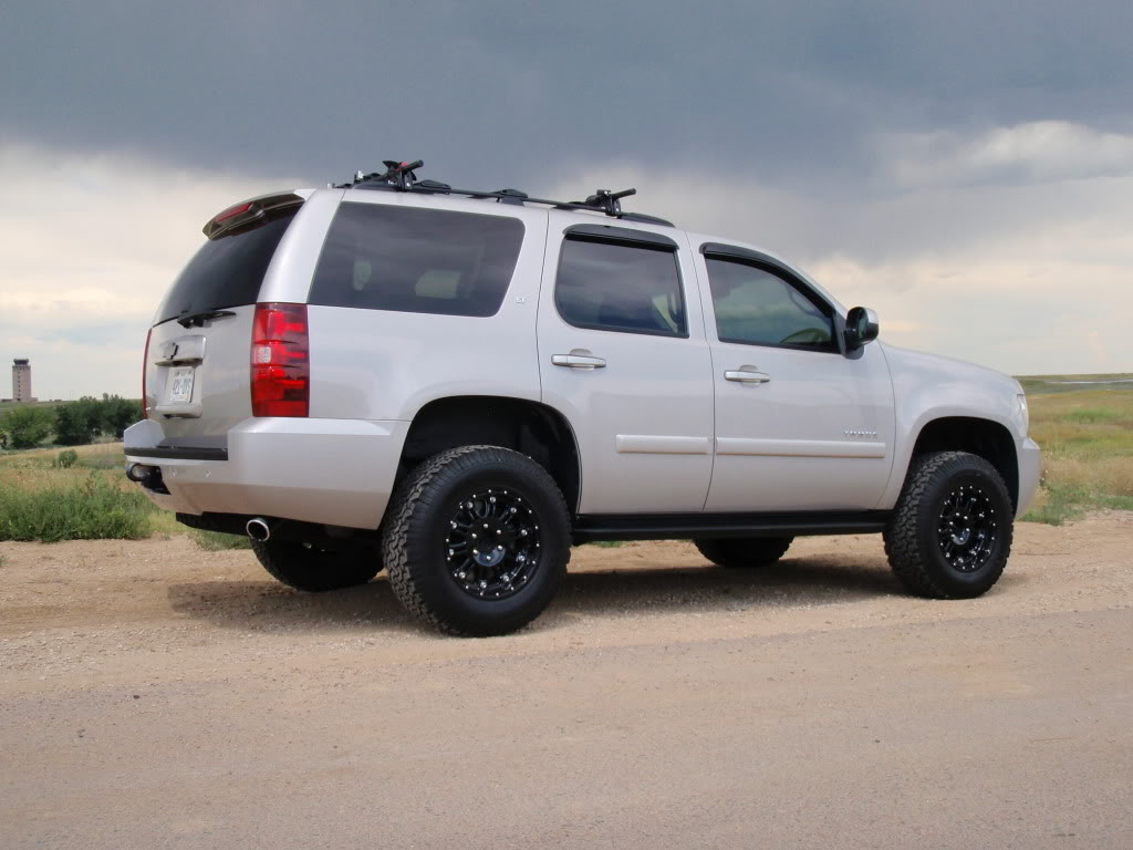

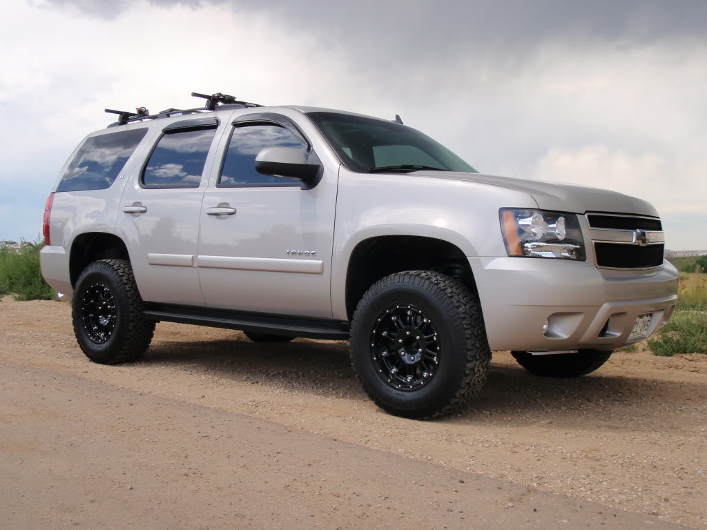

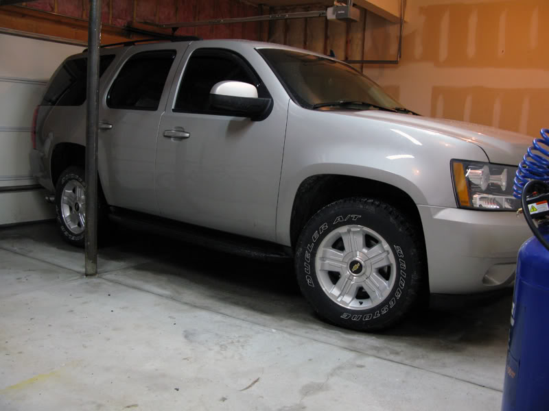

2007 Z71 Tahoe
This is a 2007 Z71. It currently has the 1.5" lift. Putting the additional .75" on this week. I am running 285/65/18 Nitto Terra grapplers. Little rub on the front left due to the windshield washer fluid box. I hope the extra .75" will fix it.

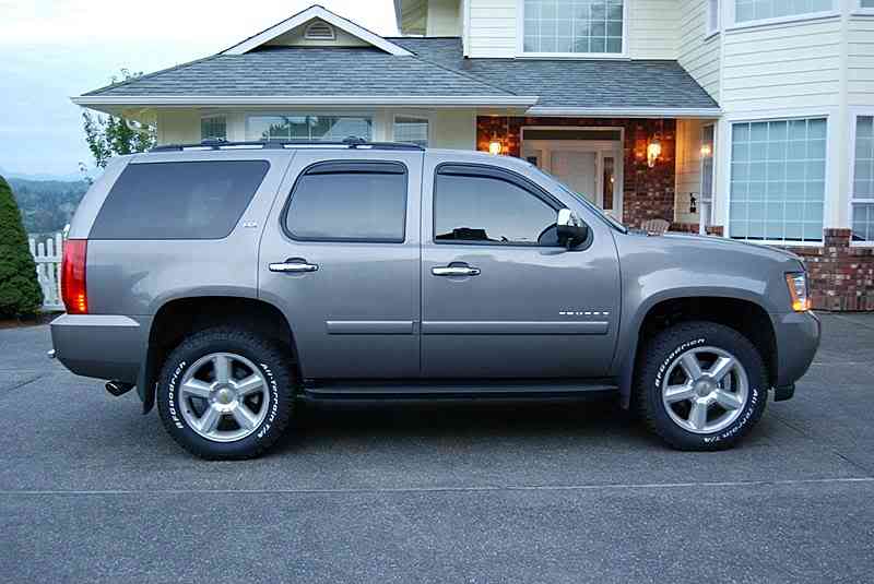

Hey Snomon, does your autoride/autolevel still work with the 1" spacer in rear?
I've also got an LTZ w/ autoride and want to do something similar to your setup.
Thanks!
Hello, yes the autoride/leveling does work with the 1" spacers and I did not mess with the adjustment rods.
Note depending on the trailer (if you have one) you will now need extra long drop stinger. I had to go from 6" drop to 8" drop stinger after the spacers.

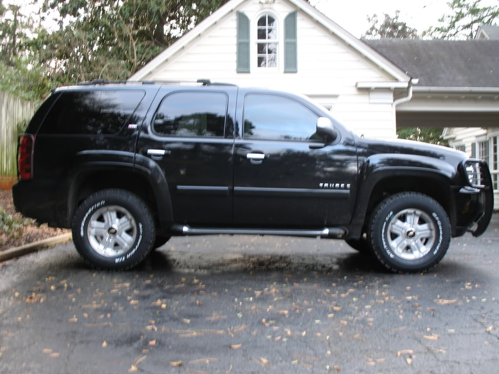

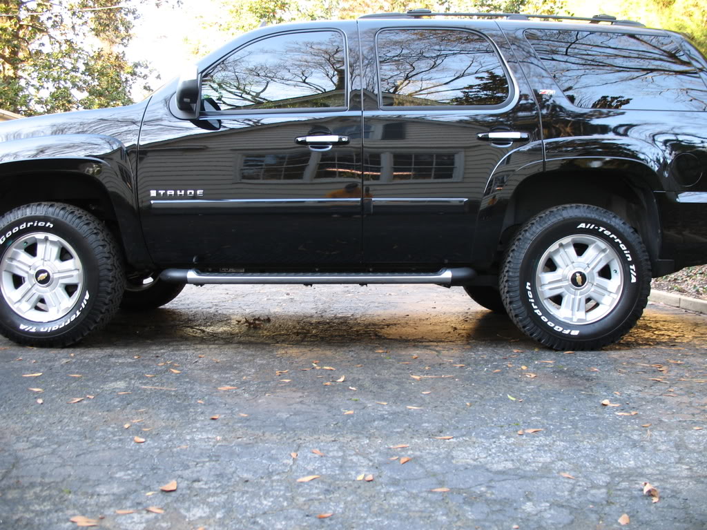

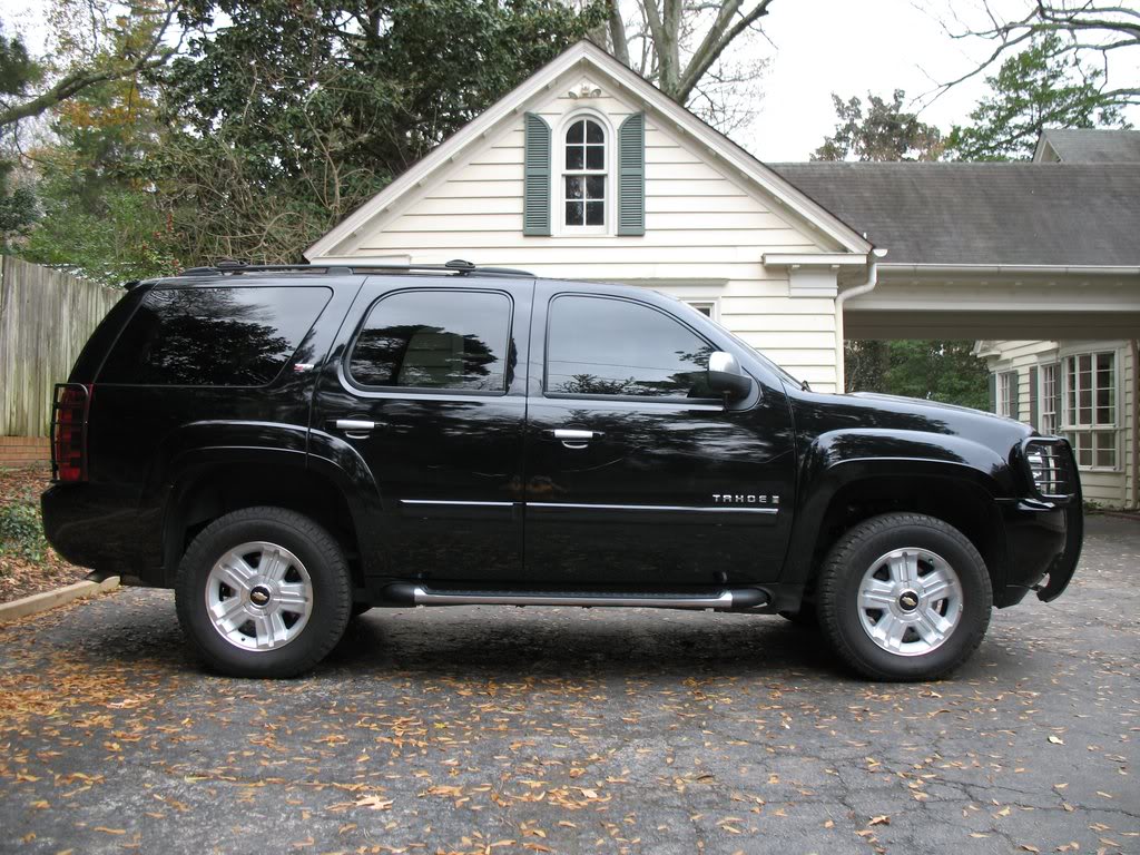

does anyone know if you can un-plug the auto ride and it be fine or has anyone had a problem with pluging it back in after the leveling kit was installed
No problems with autoride after my 2" front and 1" rear installed. I don't think they did anything special to disconnect the A/R.
