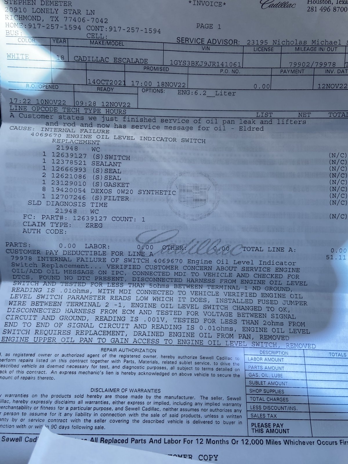

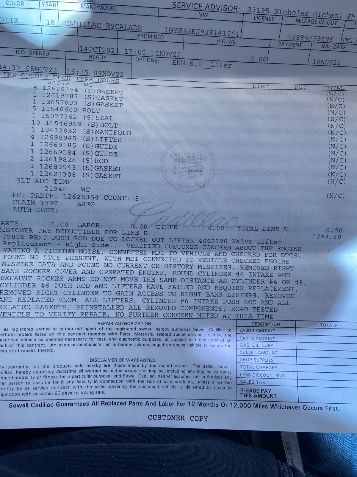

Yes it is easy to change. I would call your local dealer or gmpartsdirect.com and ask for the updated vlom. I have a 2018 Escalade now and when I get rid of it I will buy a low mile 2020 platinum than the first thing I would do is change the vlom and use Dexo 1 gen. 2 or gen.3 Mobil 1 oil with OEM oil filter. The 2021 and up has not grown on me yet. I love the rear solid axle truck frame k2xx suv. This is the last with the solid axle. I would invest in a torque wrench and when you reinstall the vlom I would torque to spec and use tread lock on the bolts for the vlom. You should also change the oil pressure sensor and filter as well. If you want to take it a step further than replace lifters at cylinder 4 & 6, lifter guides and rods. I am going to post here the receipt on the parts Cadillac changed when they did my truck.
Here is the part number they used in my 6.2 Escalade. 19433052

View attachment 400165View attachment 400167View attachment 400168View attachment 400169
WOW!!
I appreciate you sharing the service reports!
It looks like they changed the VLOM while replacing the lifter. And then the upper oil pan started leaking?
We are nearing 60k miles on our 5.3L and trying to convince my wife to be preventative about this…
So first steps are to change out the VLOM? Then….?

The oil pan seal was because there was a tiny leak which they found. I didn’t see any oil on my driveway but they did show me. Whenever they tell me something, I make them show me. There is an upper and lower oil pan seal on the k2xx. When I left the dealer and was driving home I saw the message to add oil. I panicked and thought they didn’t put oil in my truck. I found out there is an oil level sensor that tells the computer if you’re low on oil. I actually had oil in the truck so I am lucky there. I guess they must have damaged the sensor or whatever, so the dealer fixed it which required removing the oil pan again. The dealer didn’t charge me for it. So if you ever replace the oil pan seal then it would make sense to replace the sensor while your there and o-ring for the pickup tube. When doing major work I show up to the dealer and tell the service guy I left my wife’s diamond earrings or medicine so that they take me to the truck to get it. I will meet the mechanic working on my truck and hand him a $50 for lunch so he treats my truck right. I would recommend you replace the vlom to prevent this from happening to you.
