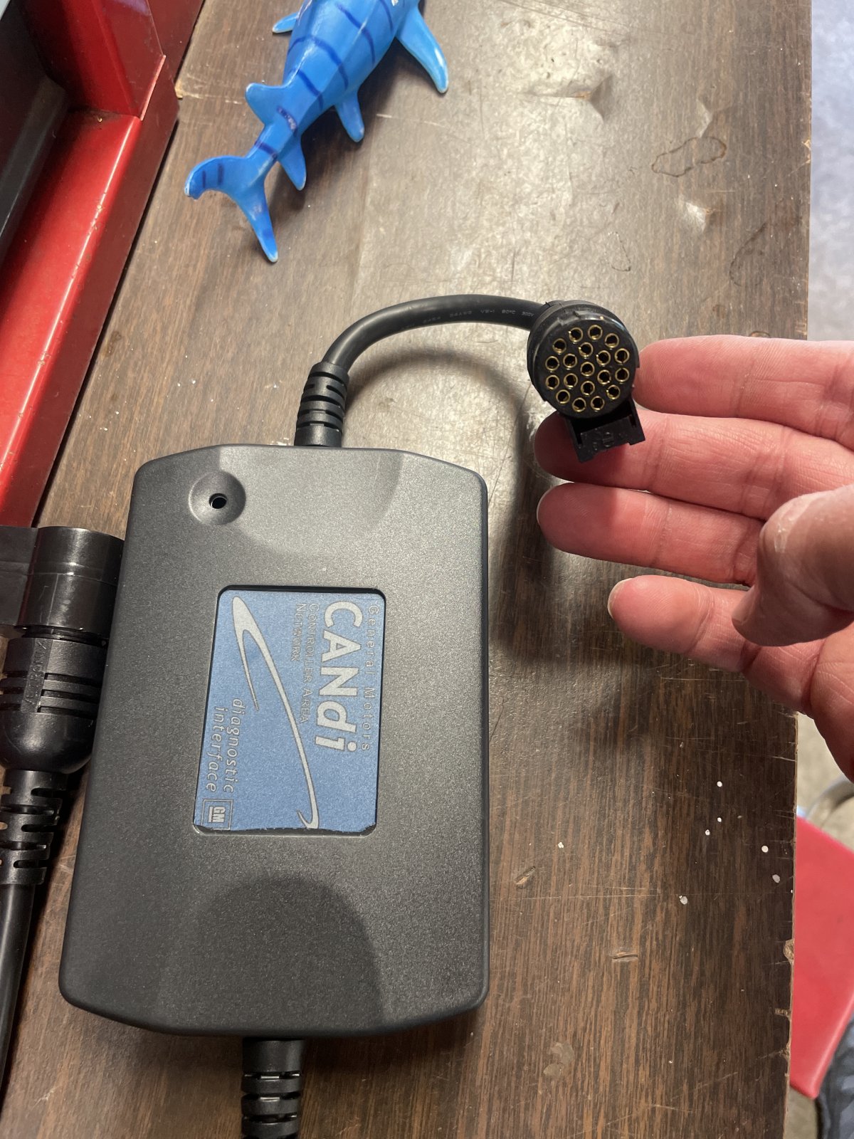

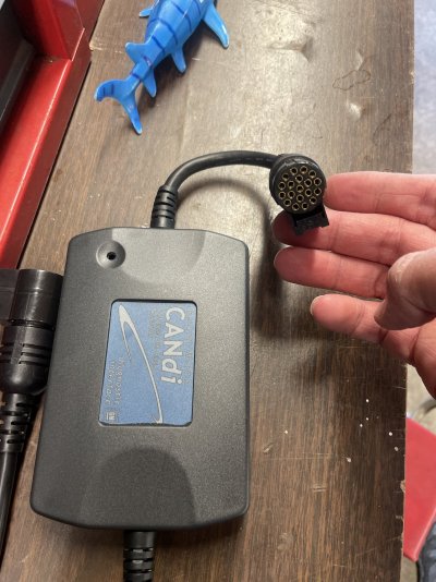

I just tried mine and i can get it to open and select but tells me candi mod not connected. Ran diagnostics on candi and it says pass but won't let me do any scans.

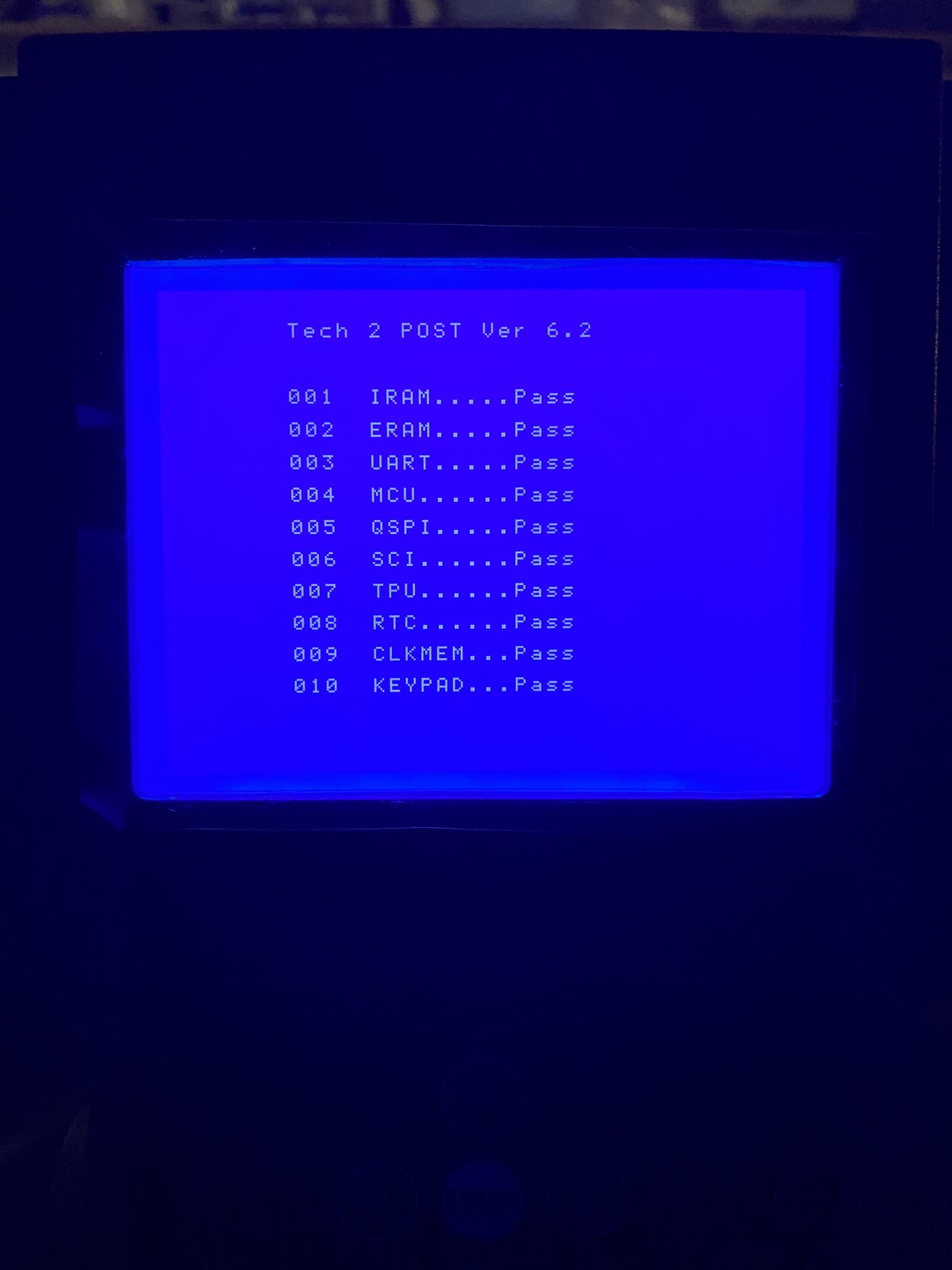

I tried everything i could find to read and it passes all the "test" . When i try ti do any diagnostic test it starts to populate the screen then says candi module not derected.

The connectors to the CANdi module and the Tech 2 cable can be VERY difficult to get together. I had to put a little lube on mine and work them quite a bit to get a good connection. Hopefully you can get the latch to latch; mine gets close enough to work.

I did double check the connection and they are latched. I will try a little dielectric grease later. I have had my fill tonight.. early morning coming.
