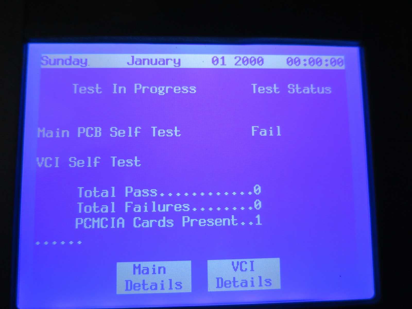

Well, I'm not having much luck. The ABS bleed function doesn't even show for a 96 or 97. Shows up at 98 but screen goes blank and nothing happens if I try it. When I try anything it either says it lost communication or the screen does nothing. And the screen contrast has reset twice now.
Anyone used this on a 96 or 97?

And for a 96 or 97 Automated Bleed is not there? I have Function Test but I get an error saying lost communication.
Can anyone tell me how long it takes to do an Automated VCI Self Test? I just have the loopback connector attached. Been going for a while now and I think it's hanging.

So seems I have an issue. And my unit won't finish a self test. I have only just hooked the battery back up and my pos alarm was screwing around, and the radio was cutting on and off (I can tell when the clock goes dark even if it's not on) whether I had the tech2 connected or not. So I still have my weird electrical gremlin. And I've read in here that even an aftermarket stereo can screw with the Tech2. So now I'm not sure if the issue is the unit or my truck, or both.

I think I got a duff one.
Contrast has reset a couple times
VCI test hangs at this point every time.
The GM User guide (P122) doesn't mention the Auto. PCB & VCI test but it stops here, won't respond and I have to shut it down.

You have to make sure that you power it up and connect the connectors EXACTLY where and WHEN the instructions tell you. I did some self-tests out of order and got error codes but they passes when I followed the instructions to a tee.

I followed the instructions in the GM User Manual to run the test. I left the VCI test running while I went to get groceries and it's still hanging. It must be a bad one.
Edit
I just went down and tried it again. No matter what I try I get a communications error that says something like 'lost communication, check the cable, check the ignition', or it hangs on 'starting communications'.
Wish I'd already tried one or could try someone else's to see if it is the unit and not my truck.

My Bluetooth OBDII reader works fine so it's unlikely an issue with my truck.
