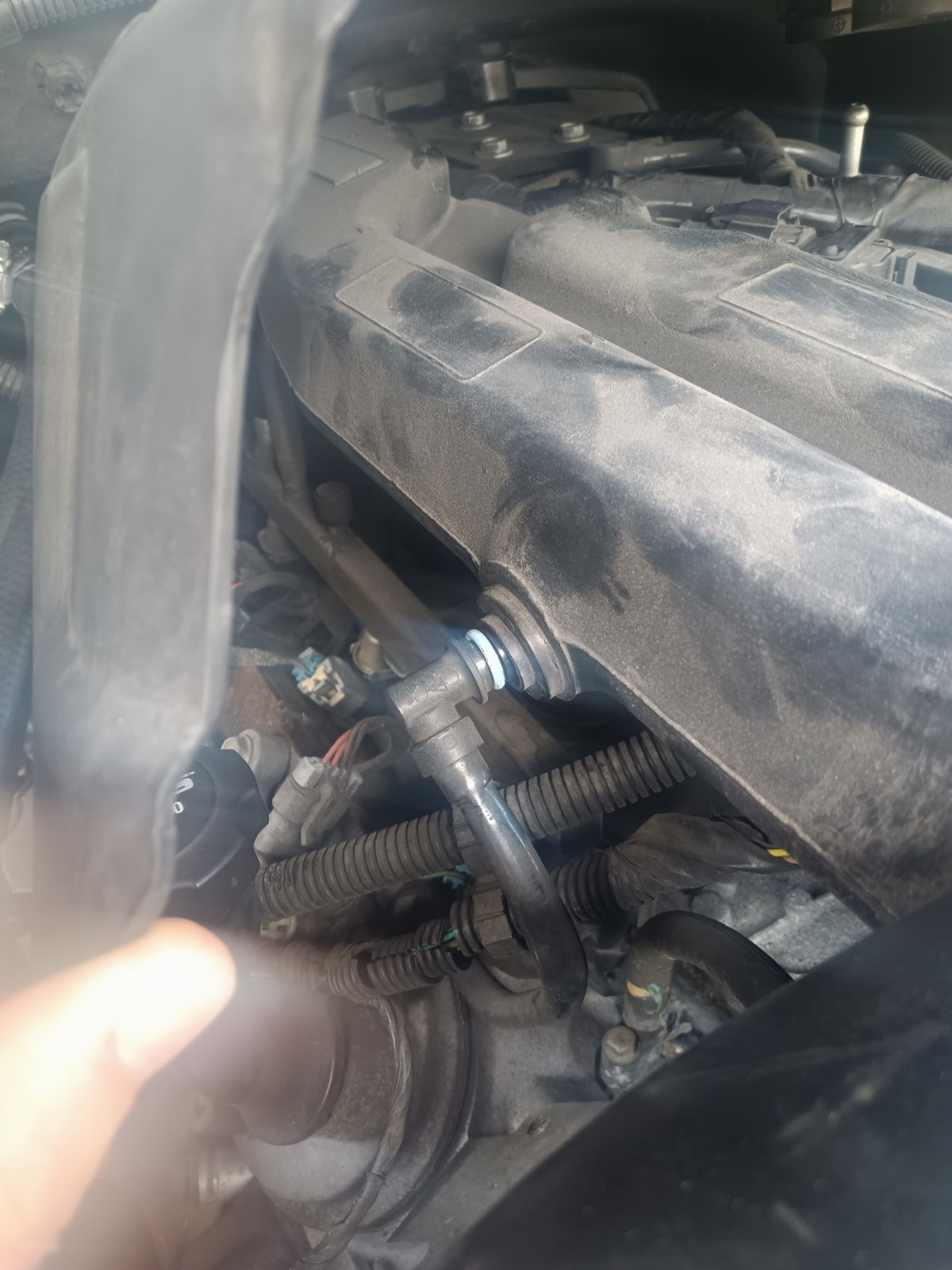

Minor update #2 - Took a look under the hood for any loose vacuum hoses or anything out of the ordinary and found this. That line with the 90 on it was just dangling and not connected. I reconnected and started to up. Check engine light is still on, I assume I need to erase/clear the codes in order for that to go off?
I looked at the freeze data -
short term fuel trim1 -0.8
Long term fuel trim1 25.8
Short term fuel trim2 2.3
Long term fuel trim 23.4
After reconnect that line, starting it, and turning it off, I looked at the Data (not freeze data)
short term fuel trim1 0.0
Long term fuel trim1 1.6
Short term fuel trim2 0.0
Long term fuel trim2 3.9
So it seems this may have been the culprit. Will clear codes, run and rescan.
There are 3 p0171 errors in the scan tool. each with a different descriptor - Permanent, Pending, Confirmed. I assume these are al;l referencing the same issue?
That will cause a vacuum leak for sure.
That'll do it!
