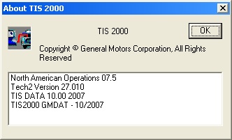

TIS2000 came on a CD with my Tech2, and also a USB dongle to activate it. As I recall, I had to have USB stick in the computer when I installed TIS2000, and everything worked after that. TIS2WEB is GM's newer system for programming. It is just a website that you pay a subscription to and use a web browser to access the programming features of the Tech2. I have not used TIS2WEB, so I can't tell you much more than that about it. I don't see the point in using anything but TIS2000 for the GMT800s though. I think about the 2007-08 MY you have to use TIS2WEB because TIS2000 doesn't contain the programming for the newer vehicles.
Exactly right AFAIK. Everything for the GMT800s and earlier should be on TIS2000 discs which come with the Tech-2 usually. I have it. I also use TIS2000 to view snapshots which some of you have seen me post about on here via youtube.
