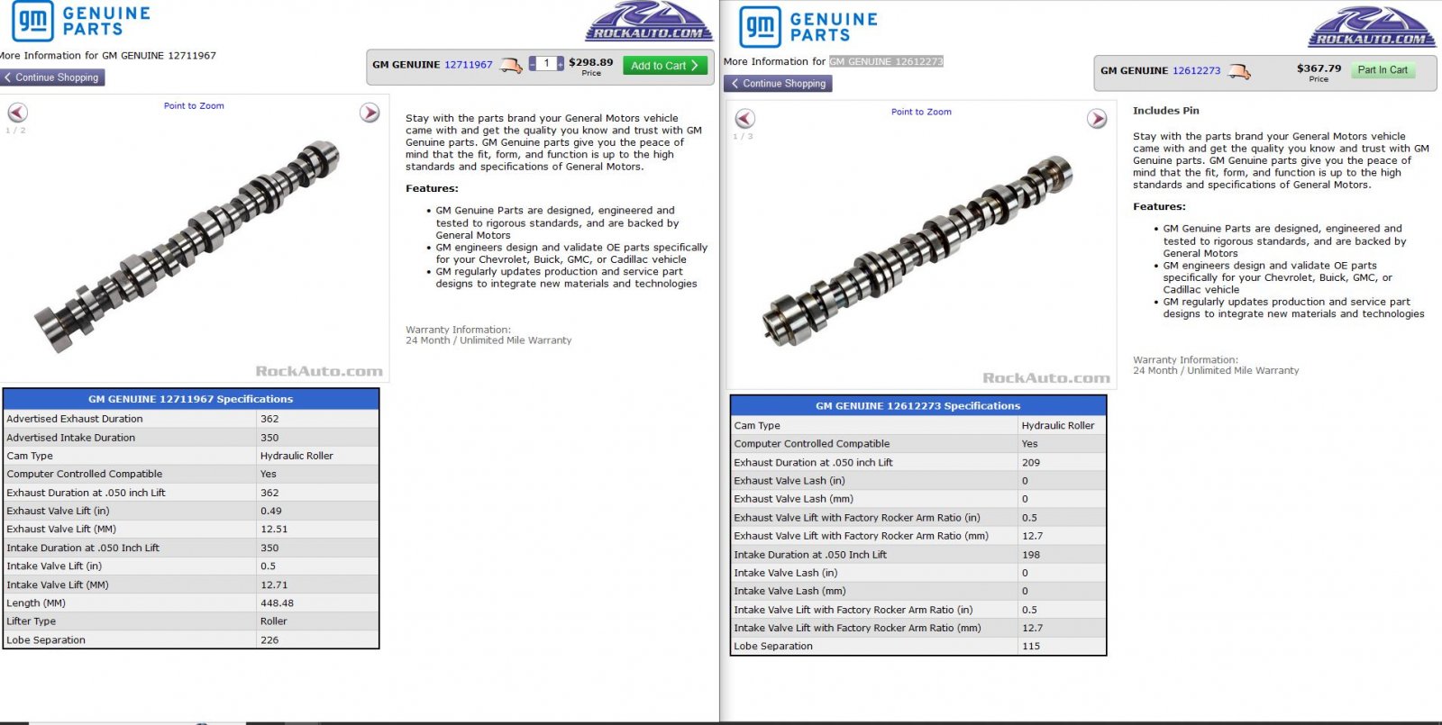

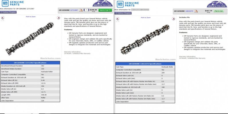

@Marky Dissod I have been looking all morning and I wasn't able to find one with the same lobe profile as the L33 cam that also has VVT, I wonder if someone else would know

some of those VVT cams are there but hard to find I guess. I need to fix my Truck ASAP so as much as I want to research and get a nice cam with good functions I guess I'm am going with the TSP package and the LS9 camshaft and lS7 springs they say everything is in stock so lets get this done and find a tuner. I have a friend that owns a place but im afraid he will want to tune it for the track and not the street lol

When I look up their packages its one of the options from GM item #28-12638427. I thought I read that, not looking to supercharge the supermarket go getter lol but wanted a little umph that the basic no thrills cam.
On top of that I need to fix my car with the quickness and some other made cams will take time. I thought I had seen an ls7 option but I guess I was mistaken.
