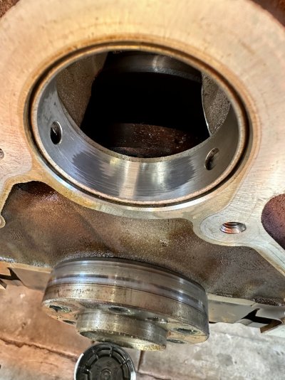

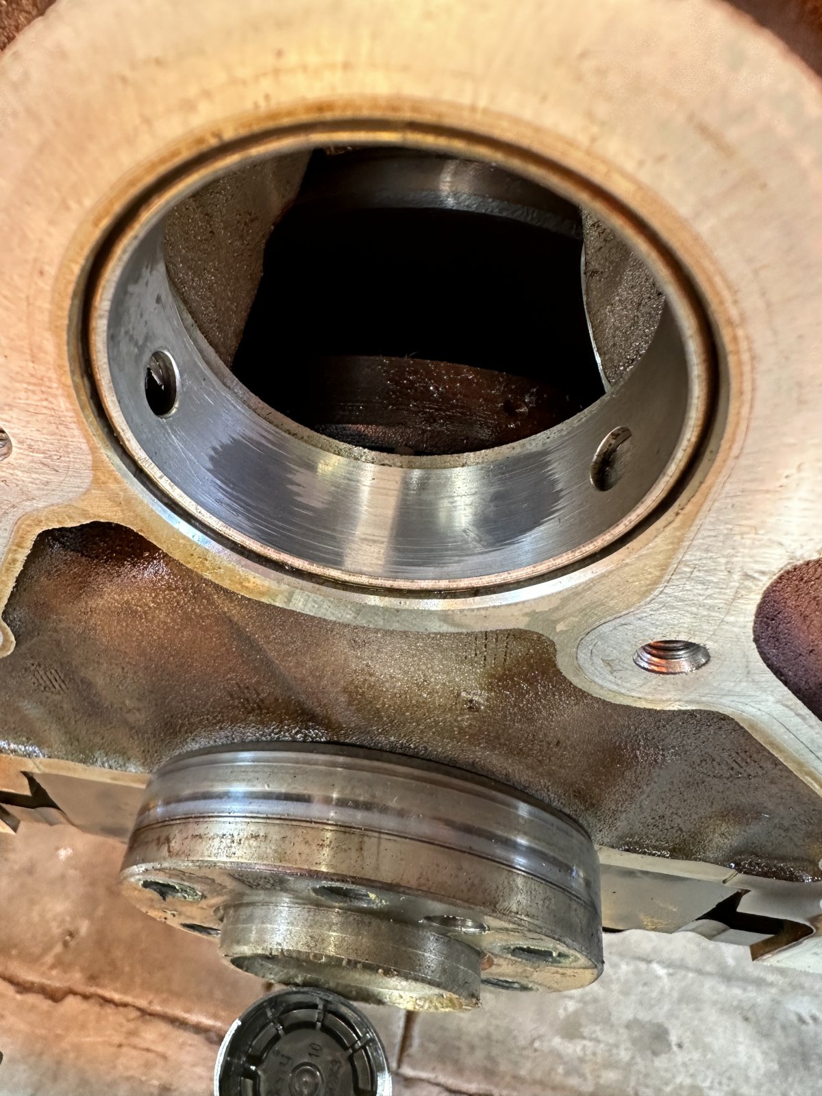

Hello my fellow contributors on this DOD journey, so the Engine is out and dissembled. one of the AFM Lifters has a shiny spot on the inner corner (I'll show pictures later) the cam is not chewed up at all (I was expecting some carnage but it has some uneven wear patterns kind of odd. My camshaft Bearings are a bit discolored, I showed pics to my cousin (works for Toyota) and he says his recommendation is changing out the cam bearings, I was hoping not to touch the bottom end but I guess I have no choice so this DOD is sending me down a rabbit whole to taking every bolt right out.
Will the main caps be reusable if not damaged or is it better to just get all new bearings since everything will have to come off?
I will post pics shortly
Lordy Lord!!!

Is that a rebuilt engine? Factory cam bearings would show copper in the worn area. That cam bearing is in great shape if it's original.
