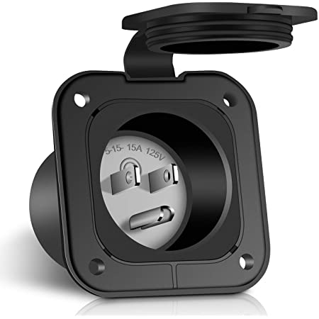

So my CTEK charger/tender came today. It has a conditioning mode, theoretically reversing some of the degradation a battery might have suffered over time. It will be interesting to see if the reconditioning processes reverse any of the apparent degradation the battery clearly has suffered.
I got it hooked up and it seems to be functioning. It is a whole lot quieter than the Diehard battery charger I was using to keep recharging the battery between uses.
Right now I am mulling what hard wired location I want for the pigtail that will be connected to the battery for ongoing tender duty. I have mixed feelings about having a convenient and unobtrusive place for the pigtail (say coming through the grill) as I can see myself in a preoccupied moment just backing the truck out and dragging the whole kit and caboodle down the street before I realize I forgot to disconnect the tender. That is one positive of having to open the hood each time to hook things up. I won't forget to unhook things with the hood up. Decisions, decisions...
Or you do like me and open the hood to hook the tender to the connector and then shut the hood so it’s locked inside and can’t get stolen, and forget it’s hooked up for a sec as I start to drive away. Luckily I heard the cord get tight and stopped. Haven’t forgot ever since though. I don’t have the tender itself mounted but I like to be able to just connect the little pigtail they give you to the harness I have permanently mounted in the engine bay, lay the tender inside and close the hood.
