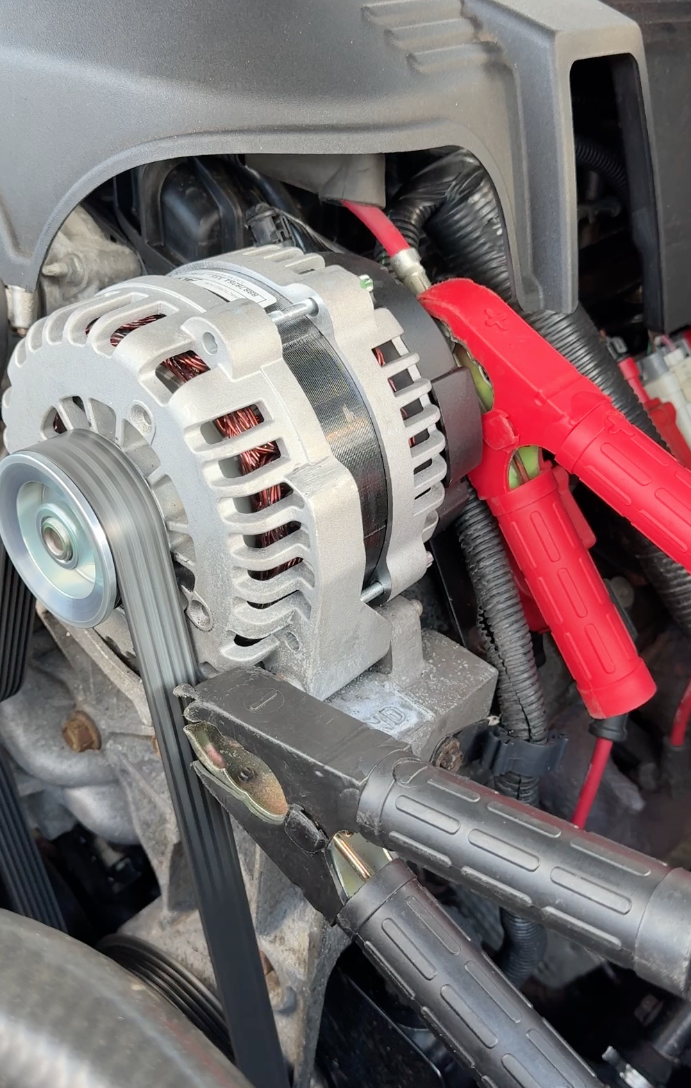

* Then I connected jumper leads (both + and -) direct from the alternator to the battery. No difference. Note: I forgot to disconnect the alternator wire though...so this may be a false test.

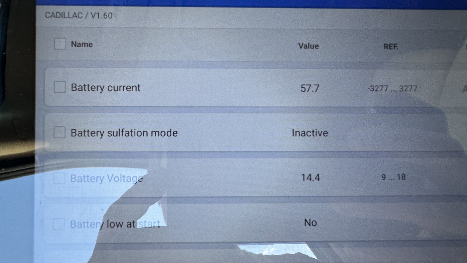

* Then i plugged in my OBD2 scanner, and checked the BCM for charging data. It appears to be pulling about 60A:
I wanted to double check this with an amp clamp, but unfortunately I only have an AC one, so it didnt work.

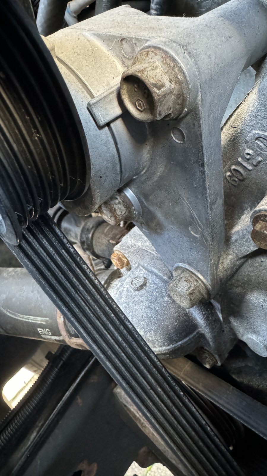

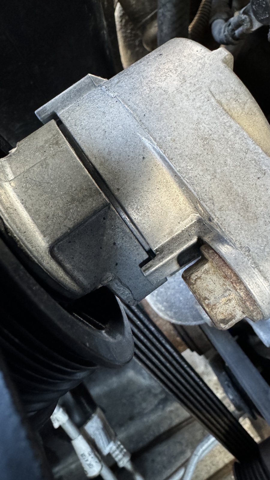

* Then I checked for tensioner markings. I couldn't find anything definitive, so here are some pictures:
