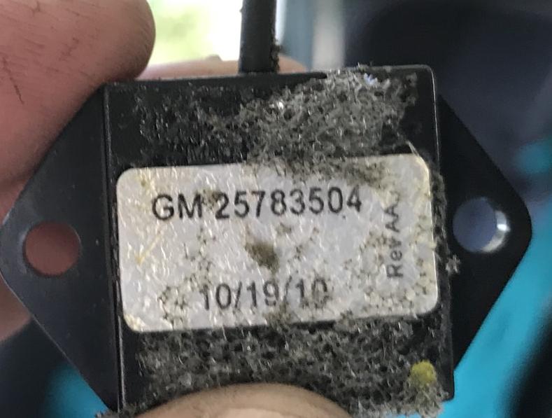

I'm pretty sure that " mic" was your aspirator for your HVAC system which is known to hum until you clean it out or replace it. Does it look like a small fan when you closely inspect it? The aspirator is above the driver, in the headliner. Hard to tell from that picture. The factory mics are in the center forward OHC usually.
Nope. Fan was in the other grille and yes it was filthy, but quiet.
Mic was very obviously a mic. I google the part number before cutting just to be sure. GM Part No.: 25783504 - Microphone Asm-Radio Volume Compensator Interior Noise. More pics of it HERE.
The Active Noise Cancelling (ANC) of the Bose system freaks out when you tap into it for subwoofer signal and feeds a bunch of noise into the system. There are no settings for it in the head unit software to disable it. By cutting a mic it disables itself. ANC doresnt work for crap anyways. Same exact issue and resolution as my Infiniti when I tapped into its Bose system.
