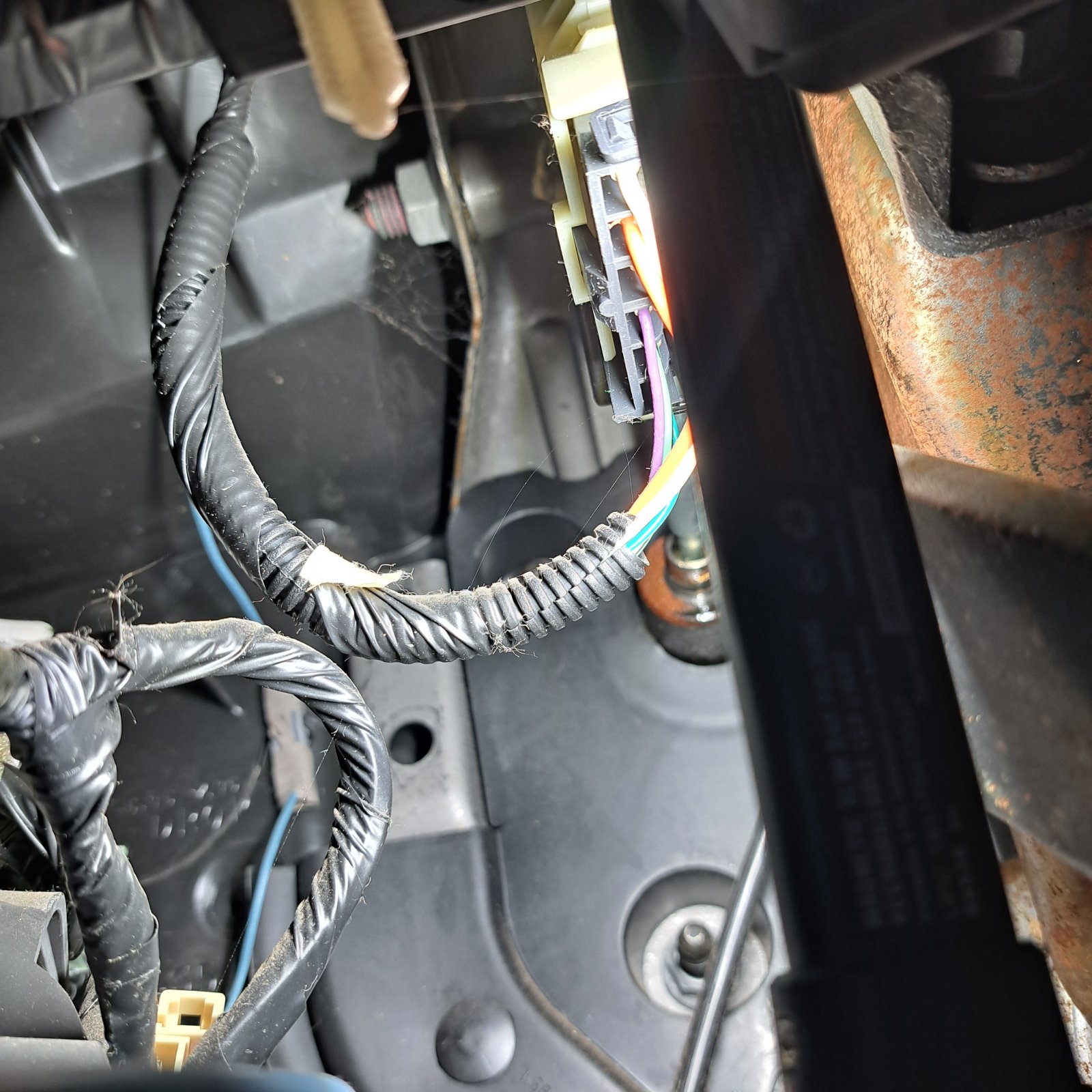

On the same Tahoe, it has hydro-boost brakes and when on a rough enough road or over bumps, there is a rattle noise under the dash on d/s and sounds close to the firewall. I checked and is not the lower collar bearing on the steering column and not the attaching shaft at bottom of column. Did find a lot of play at the upper brake pedal pivot. Has a large horizontal bolt with a threaded nut. Cannot seem to see or feel the other side of it to see if the bolt head is there. I was tired and did not spend a bunch of time digging. Also has P/S fluid seepage at back of hydro-boost at the firewall. See pics of seepage and threaded bolt. Bolt is at top of the pic. Anyone ran in to this before and know anything about tightening the bolt? Is there a bolt head or is it captured? Thanks in advance.

So now, more work in my future on this 2005 Tahoe that I did the door hinge pins on. I found a video that explains EXACTLY the rattle under the dash problem and shows what to do to fix. For info purposes, I have already ordered the bushing, gonna do the brake light switch while is off for bushing access and in my case, I am going to remove the driver's seat for way better access for me. At 6'4" and 280 pounds, I need some room. In the video, that I am supplying the link for, it is also a hydro-boost brake system with the exact same p/s fluid leakage/seepage that I saw on her Tahoe. The video is a Suburban.

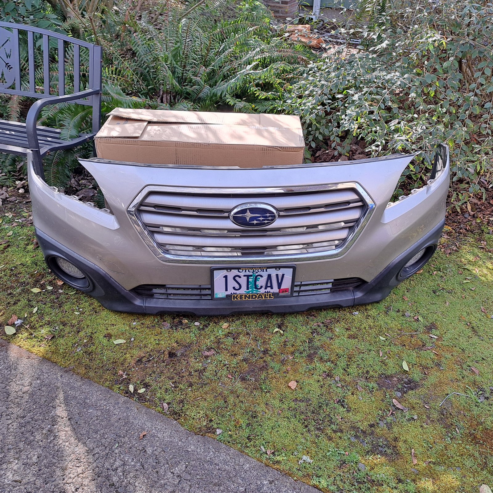

Replaced both headlamp assemblies on this 2017 Outback. Involved complete front bumper facia removal, detach fog lights, remove brackets that the facia clips press in to so that they snap out and back in to place, found that someone had to be in there before because one of the bracket bolts were missing. Found a replacement bolt and installed. The rest of the attaching bolts are black and my replacement bolt is grey. Also found that an attaching bracket across the top had not been reinstalled as should have been. You can see where there was no shadow of where the bracket tabs should have been and where I realigned and set tabs as should have been. Some sloppy previous work. All that is required to remove the bumper facia is clips removal. Yes, the AL guy was a 1st Cavalry vet in Vietnam. The battery was filthy so I cleaned it. See pics:
