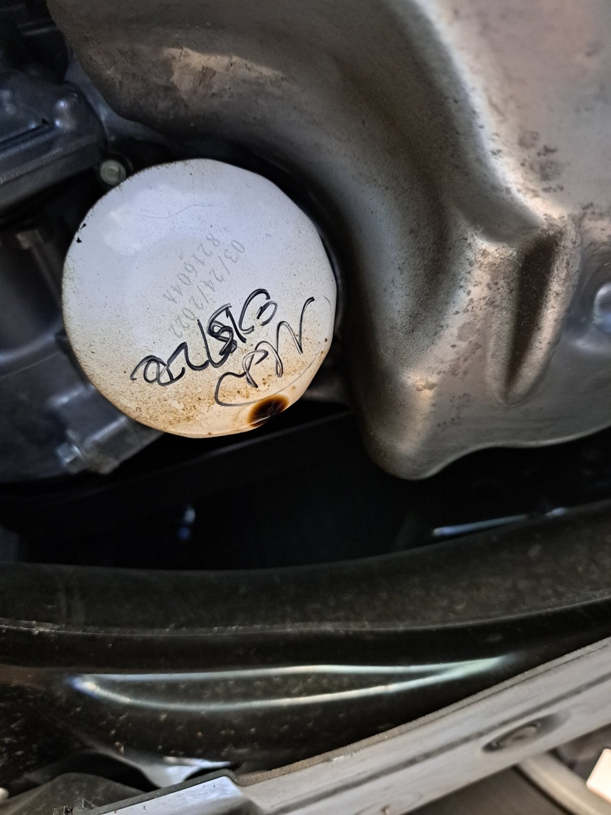

The Escape owner said he wants me to change the oil and filter on it soon. I told him 25+ on labor because not all oil filters are the same. He said he was told it is a PITA on the filter. The turbo plumbing is in the way. I told him I would be fair. He said no problem paying whatever. The recent coolant leak work went ok and he gave me a $50 tip. He is a vet and I will work with him. I usually figure out a way that is pretty easy to get at the filter. At least it is a spin on filter and not a cartridge.
