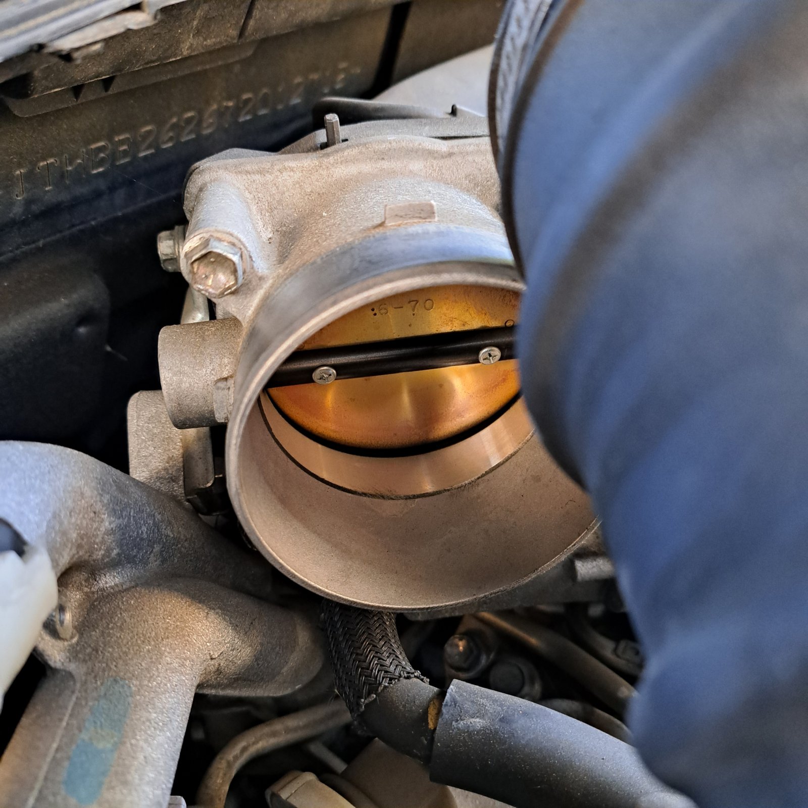

I am going back at 1:00 today, for tacos, to see her about the cracked ignition coil and get the ok to order in the set of 6 Denso ignition coils and the throttle body seal for when I clean the throttle body. Looks like when the coils come in I am doing all 6, clean the throttle body and do a battery cable end service. I think the valve cover gasket oil leak will have to get worse for her to do that. From RA the set of 6 coils, seal, shipping and discount come to $237.68. The same Denso coils and seal, at AZ, comes to $411.24. The coils at the dealer are $108.79 each. She is seeing the value of doing business with me for the use of the discounts.
