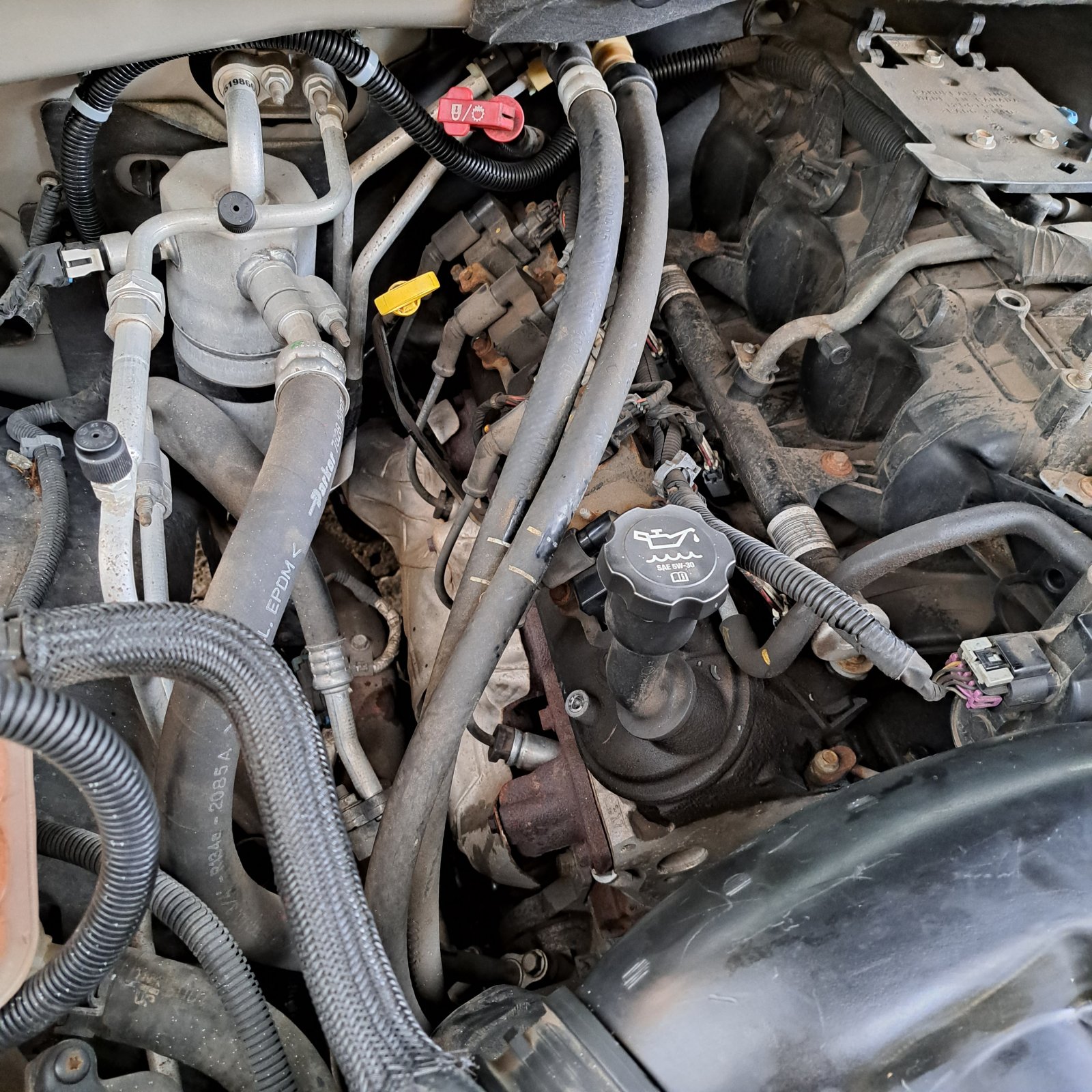

I also road tested the truck this morning and was able to load/accel the engine and make it misfire any time I wanted and for as long as I wanted. It does feel like a torque converter locking and unlocking but I still believe it is a misfire for two reasons: I heard a small backfire this morning and I can accel hard when in Park or Neutral and feel the misfire but not as bad because I am not pulling the truck weight, like when driving.
See pics, all taken with engine running:
View attachment 406493View attachment 406494View attachment 406495

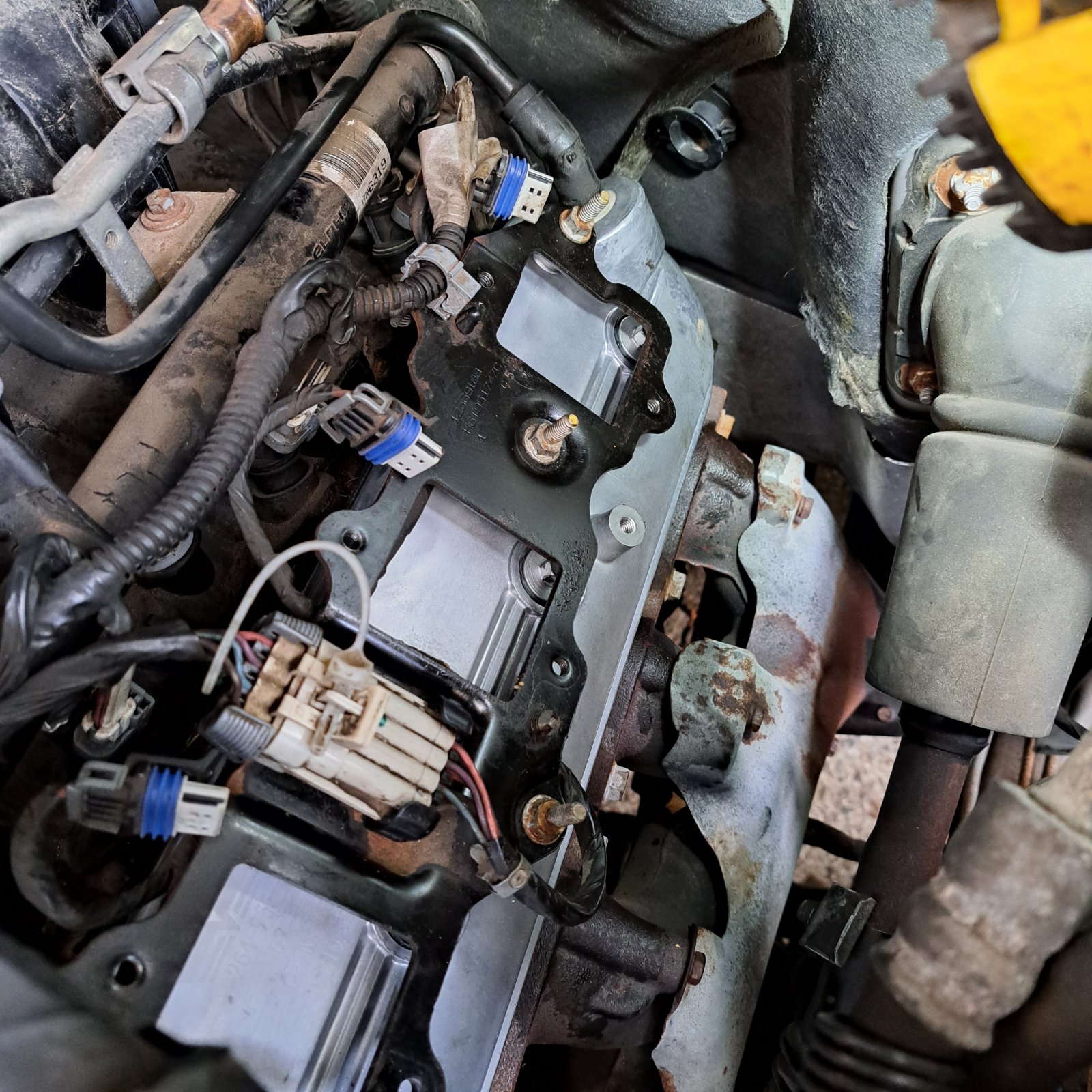

I drove the F150 to my friend's shop in J.C. and during that drive I experienced many severe misfires and actually got it to throw a CEL one time. Found numerous misfire counts on cylinder #3 and the code was a P0303. Also had misfire counts on #7 and #5 but very random and low. He then told me something that I had never heard before. The #3 and #7 cylinders/ign. coils are directly under the cowling water trough at back of hood. Water gathers there and will drip down and directly below that are the ignition coils for #3 and #7 cylinders. When looked at the coils, there was signs of dried up water/dirt mixture that gathered all around those coils. I was gonna replace the coils anyway, so ordered them today from RA. The new design plugs had been changed 30k miles ago but will look at plugs at #3 and #7.
