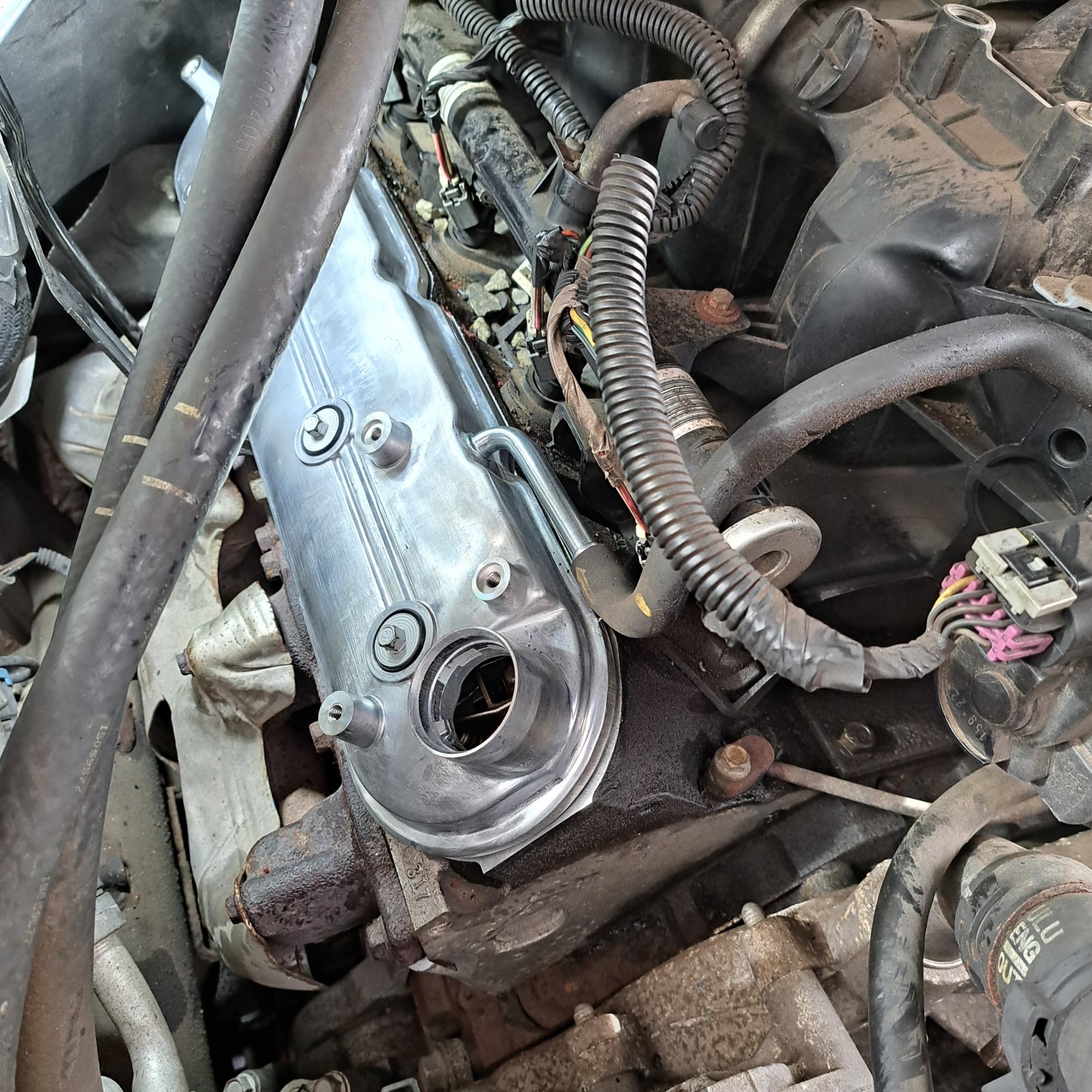

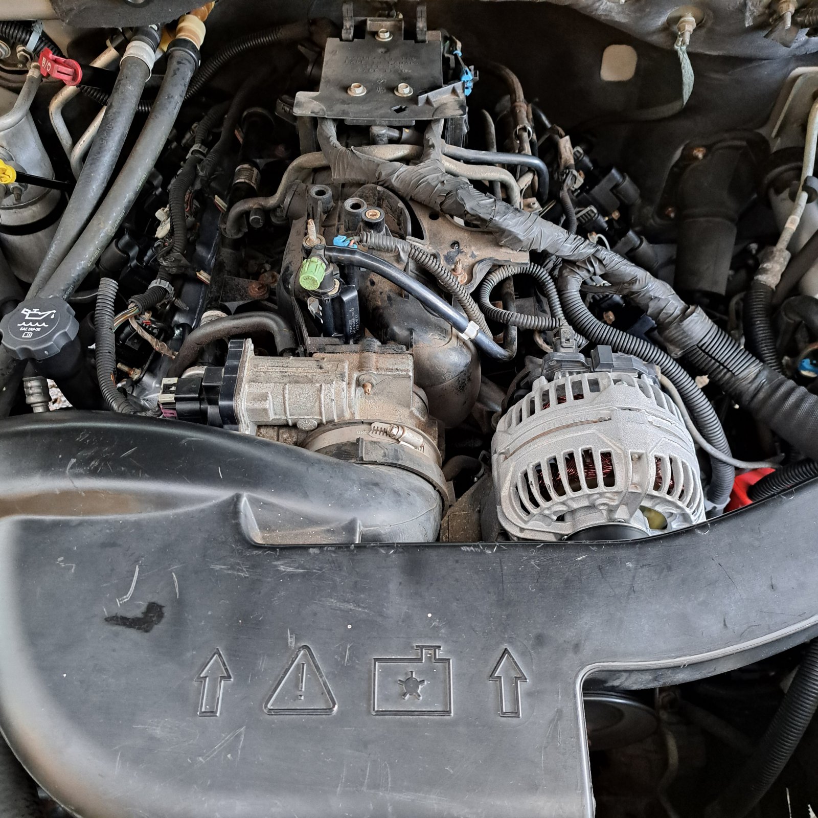

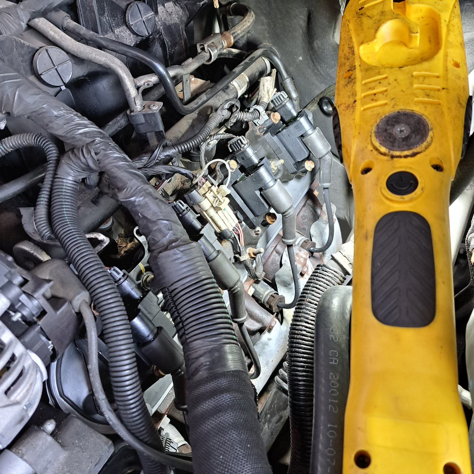

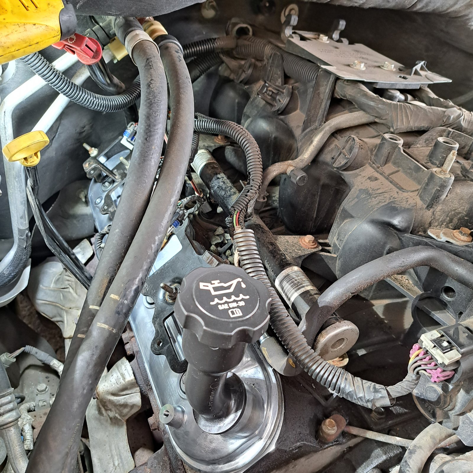

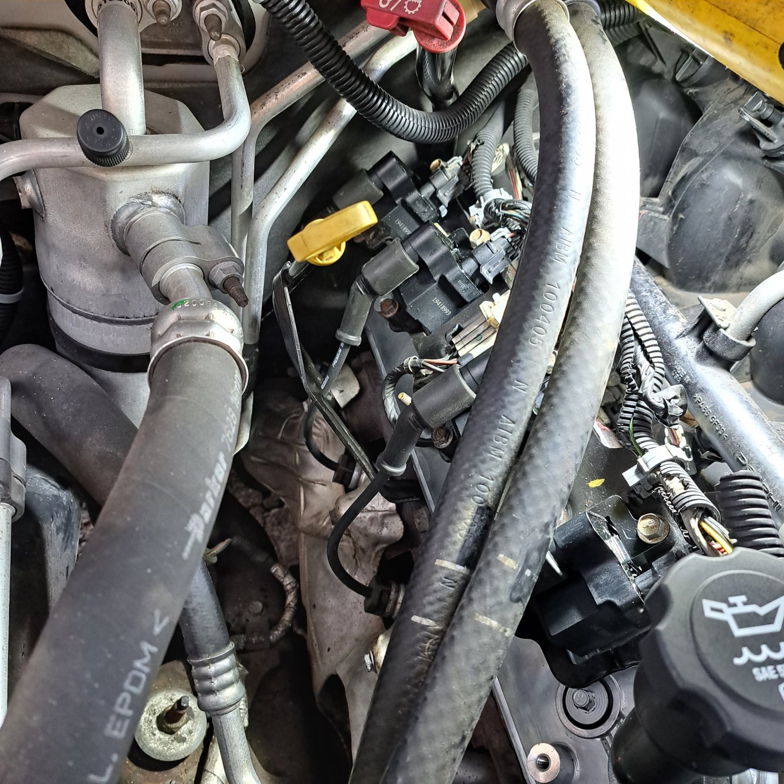

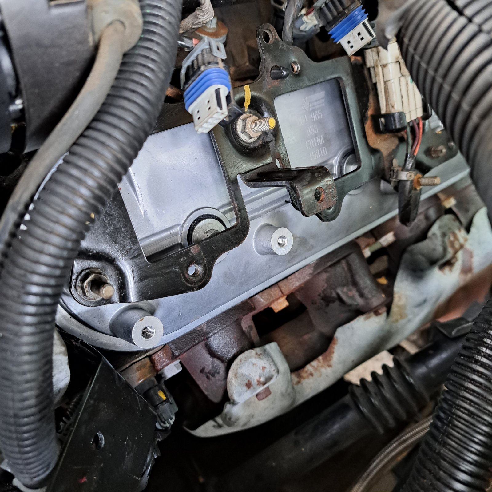

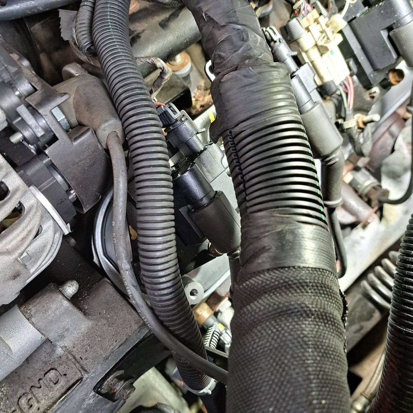

Rest of the F150 parts came this morning and was tempted to start on work today but am waiting till in the morning. I had my VA appointment for Wednesday and played phone tag and even went to VA and still no replacement appointment. This is *b*u*l*l*s*h*i*t*. I am getting the run around and I have a legitimate concern that I need looked at. Nothing major, I hope, and does not keep me from working and carrying on about my days. Just a run around that a vet is not supposed to go thru. Thanks Brandon.
I fired up my little air compressor and attached my blower nozzle and blew out all around the ignition coils. Once I pull the coils, I will be blowing out the holes as well. Gonna look at the plugs on #3 and #7. The rest of the work is pretty straight forward: air filter, serpentine belt, brake and power steering flush and changing fluids at both differentials. Gonna be taking a break at 11:30 for tacos with a friend from the AL. We do the tacos every Tuesday and Thursday. It will be a long day and this neighbor is one that I have agreed to do the labor at $60 an hour because he was my first customer on the block when my labor was $60 an hour.
This morning I moved his truck over and parked in front of my garage. When I did that, I found the park brake light was on, even though the park brake was not set. I told him and it is easy to remove covers to access the harness connection at the back of the d/s of cluster. All I did before was flex the circuit board and the light went out but after sitting for 4-5 days, it has settled back in place and turned the light on. We have 4 options: Flex the circuit board again and install a small wedge of something in there to hold it and not allow for it to settle again and turn light on, don't touch it and let it stay on, remove the cluster and circuit board and attempt a solder fix or buy a new cluster from Ford because I have looked and looked and cannot find a new circuit board, only a complete cluster, to the tune of just under $600 at FOMOCO. Has to be ordered in and I would need to see about the mileage set up on it. I see them as low as $385 at OE Ford Parts suppliers but am unsure about those. I think this is a last resort and he wants me to just put a wedge in place. He is gonna tell me in the morning.

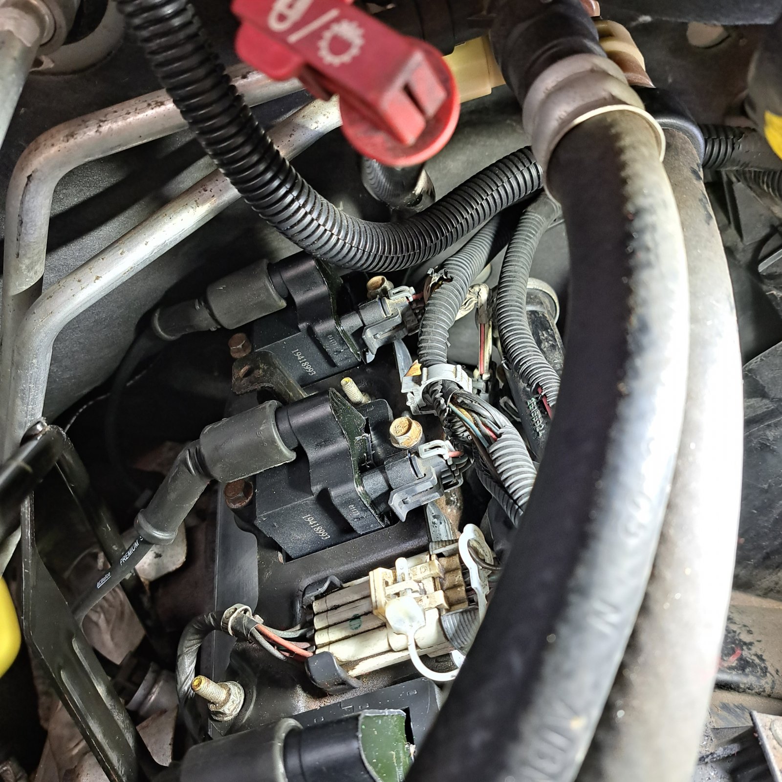

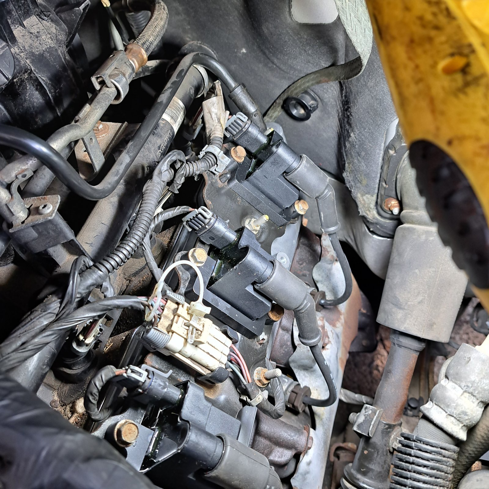

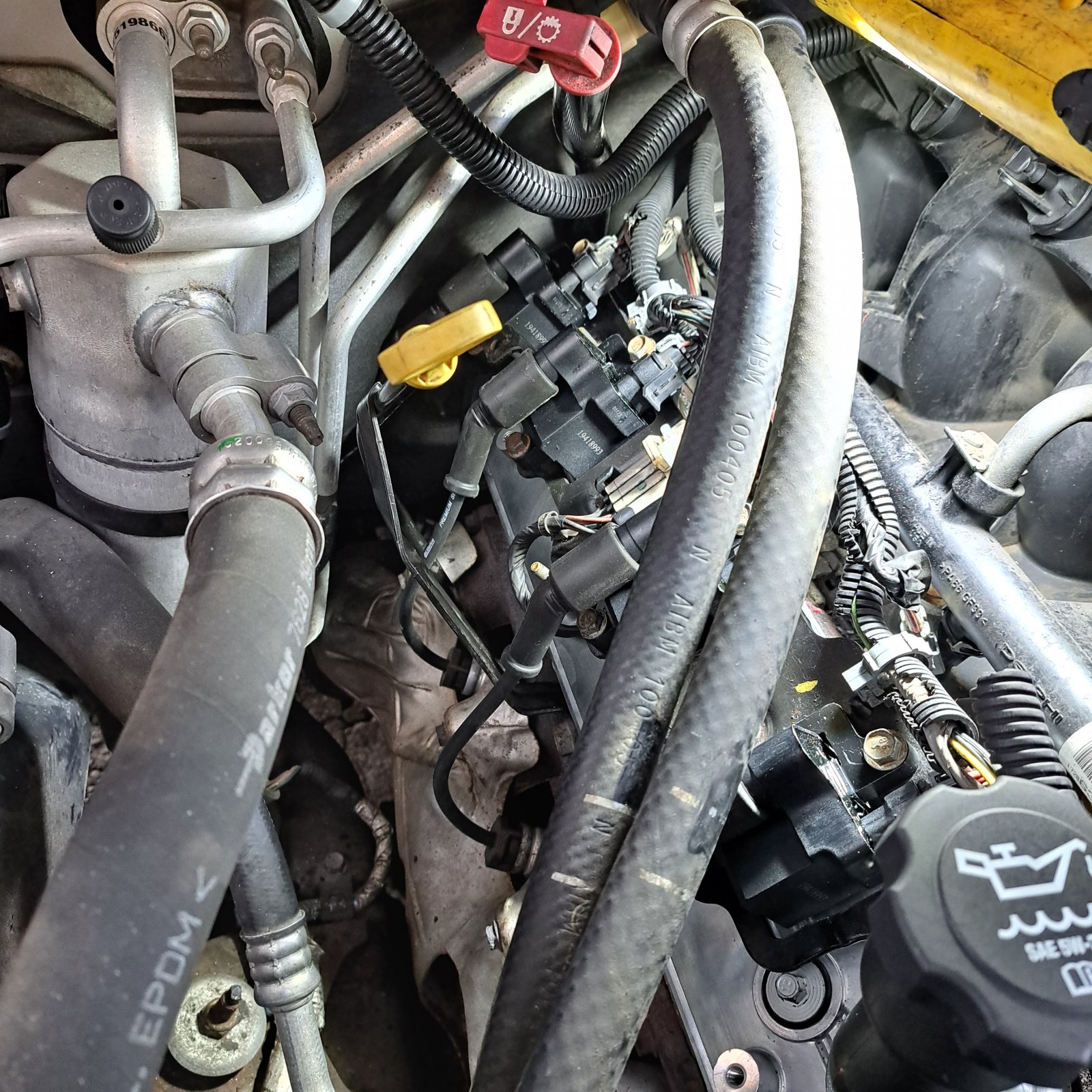

Started at 7:30 on the F150 and finished at 4:10. Had 2 trips to AZ as well. Decided to do new plugs with the coils and added on new front hood lift struts. Some of the time was eaten up by figuring out how to wedge that circuit board for the park brake light. In behind that circuit board in the dash cluster there was a space about 3 1/2" before you got to the hard plastic tunnel for the defrost vent. Used Gorilla tape and wedged a used roll of Duct tape in there and it pushed it forward and shut out the light. I left the covers off and drove to AZ for the hood lift struts and back with no light on. He was happy and I had it back together in 2 minutes.
The 2 cylinders that I got the misfire counts on, #3 and #7, both had ugly looking boots and the tops were gummed up with signs of the water leaking down from the cowling and mixing with dirt. The 2 plugs did not look as good as the others so we did all new plugs too. Put it all back together and road tested with customer and there was no misfire. Did the brake flush, power steering flush, serpentine belt, air filter, fuel filter and changed fluid in both diffs. I agreed to charge him $60 an hour for 7 hours. He bought me some lunch and he also paid for a new 9/16" inch magnetic spark plug socket, because all I had was 5/8" and 3/4". I had taken a couple water breaks and he does favors for me, so I felt 7 hours was fair. By the way, the old dealer installed plugs were either too tight or too loose and I gotta say, the plugs are a PITA to do.
