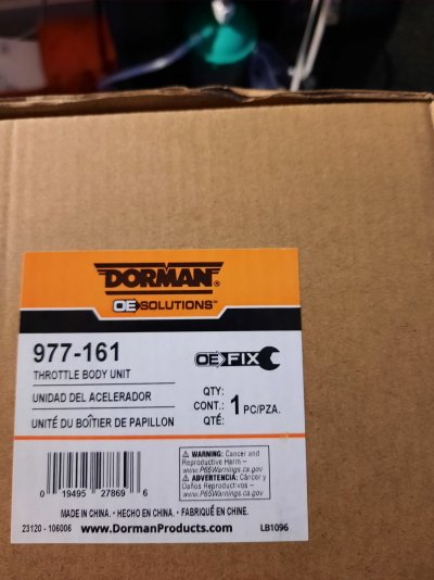

I figured out by looking at a Zurich scanner that it had a code for the throttle body and the throttle body position sensor. The live data showed the pedal was only registering 23% when I had it half way to the floor. So I went to rock auto and ordered a Dorman throttle body with built in tps sensor and had my step son install it and thus far I have no more cold start dying issues nor does it smell rich. I am thinking it's fixed but the real test will be letting it sit overnight and then go start it in the morning and see what happens. I'm happy right now though. We looked at the old throttle body that had 235k on it and the flapper was stuck open. So I think that is what was causing the issue. For future reference I used Dorman part #977-161.
I'll update this post again in the morning to let you guys know if it truly fixes my issue or not. If it does I'll proceed with my Flowmaster 10 series install.
