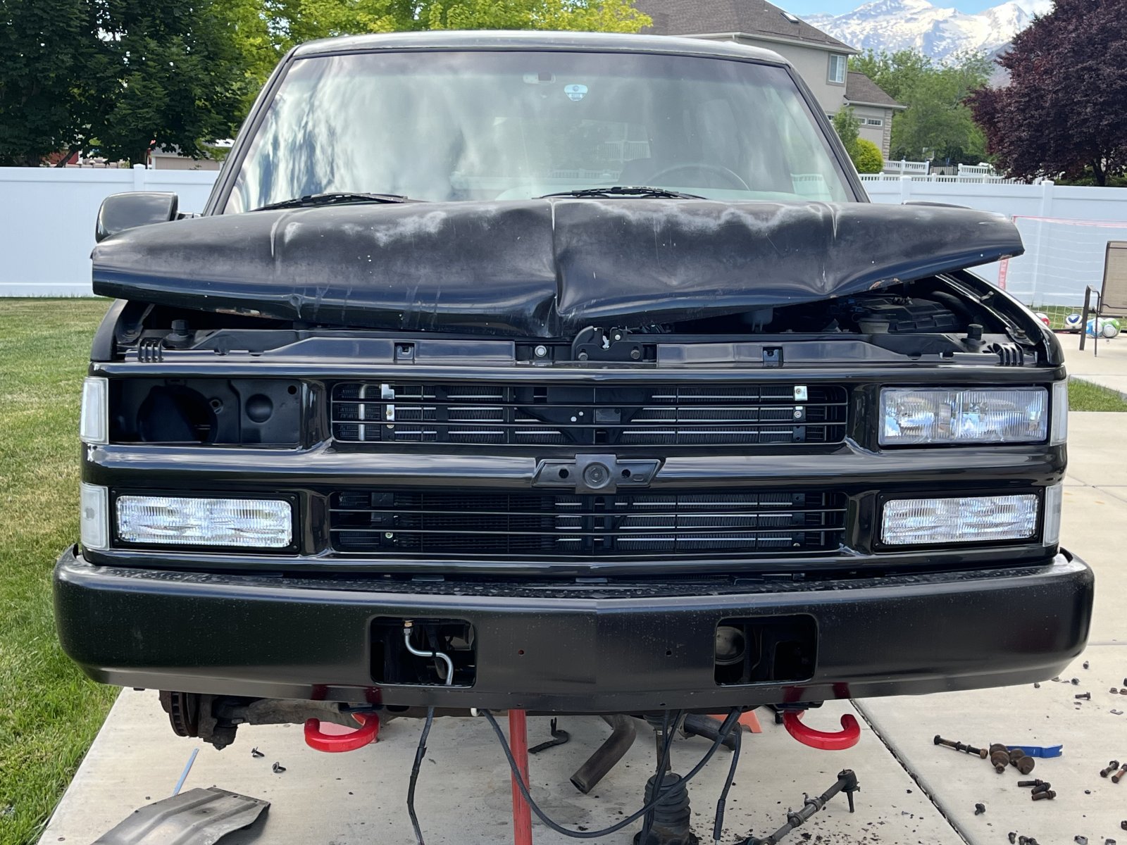

Little bit of work done, removed the front right damaged fender and inner fender well. Also removed the broken hinge roller pin, put in a new AC Delco water pump.
Tomorrow I’m going to tackle the door hinge pins and get that squared away, then start on putting the new fender and inner fender well on

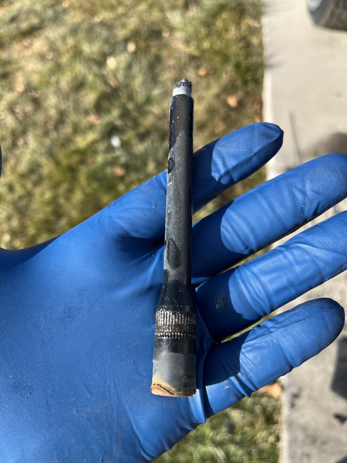

Got the steering gear removed today, have a new “83” unit to go in. Also I had a damn hard time with these Dorman door roller pins, decided I would just order new bolt in ones from Cunningham Machine since I already ordered their door hinge bushings.

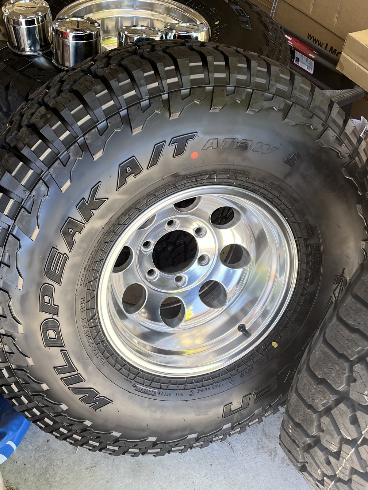

My new Cunningham Machine door rollers and pins came in a day ago, I had previously just bought the bushings, but I attempted to put in the doorman rollers.. what a joke

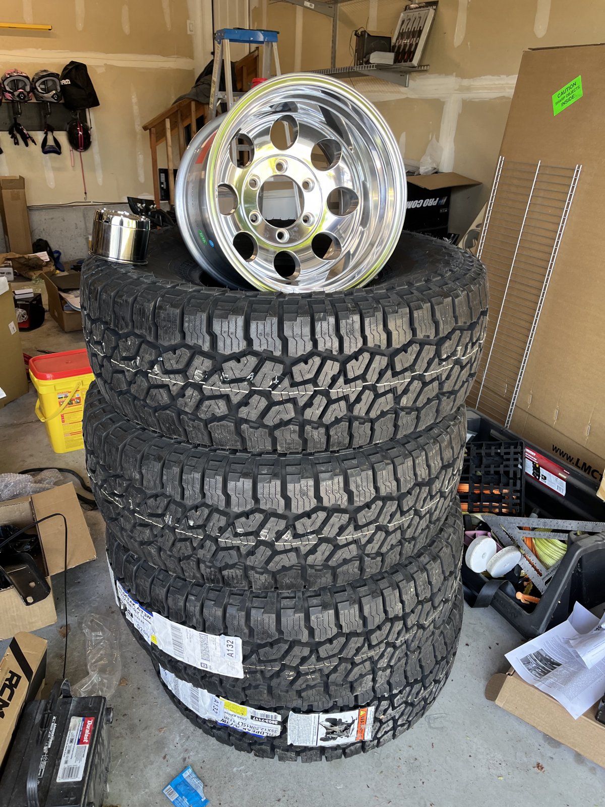

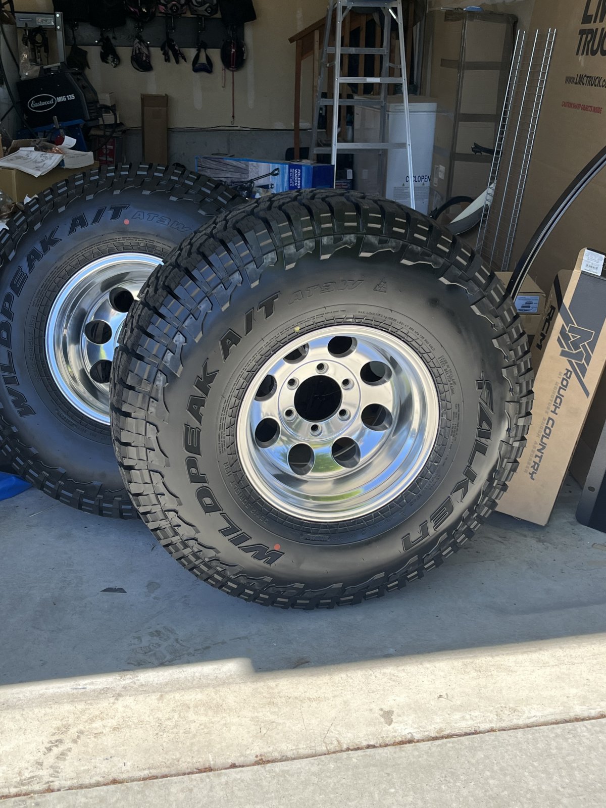

I also got my new Procomp Wheels from Summitracing, 15x10’s to go on once I put on the RC 6” lift kit

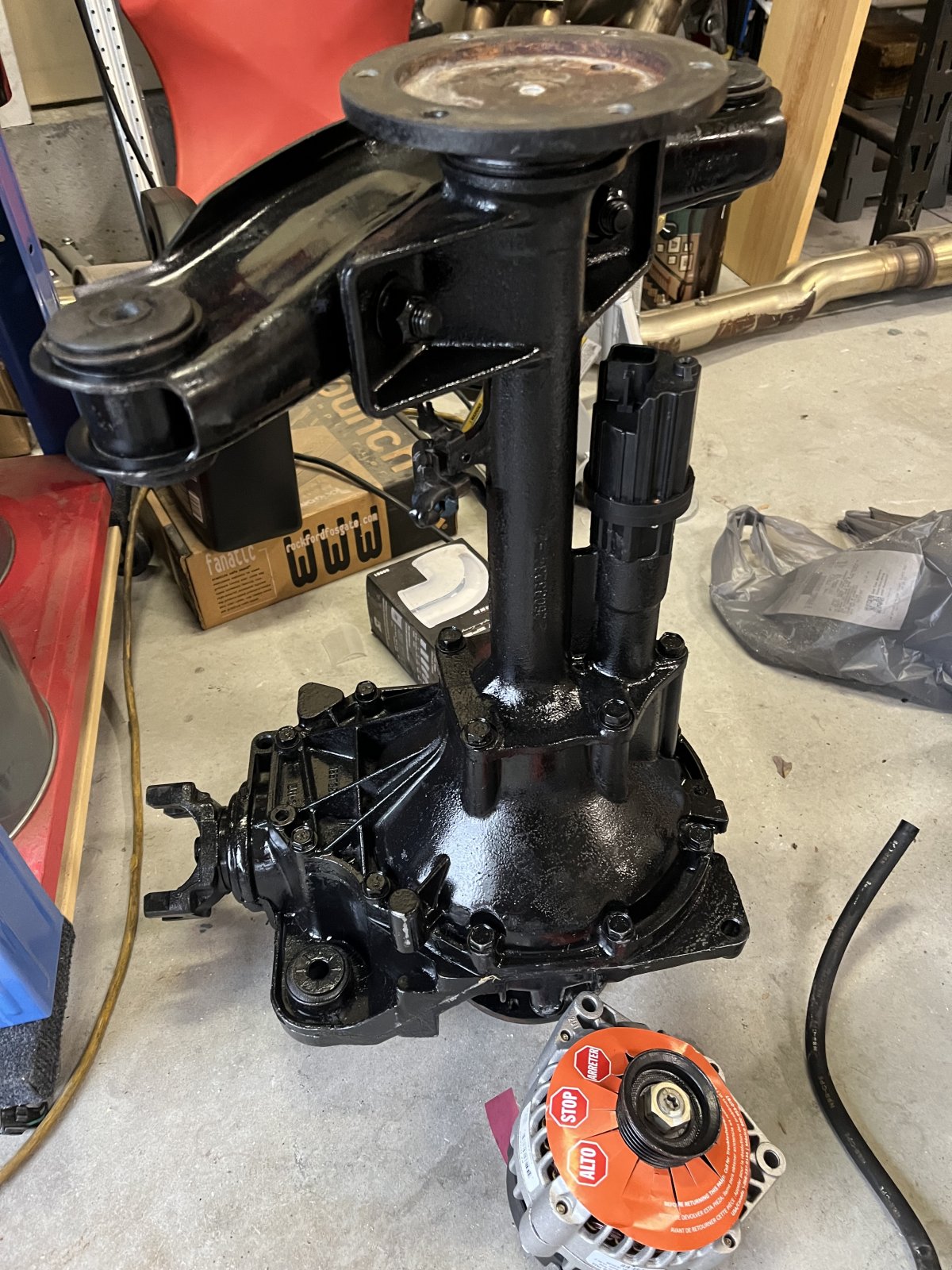

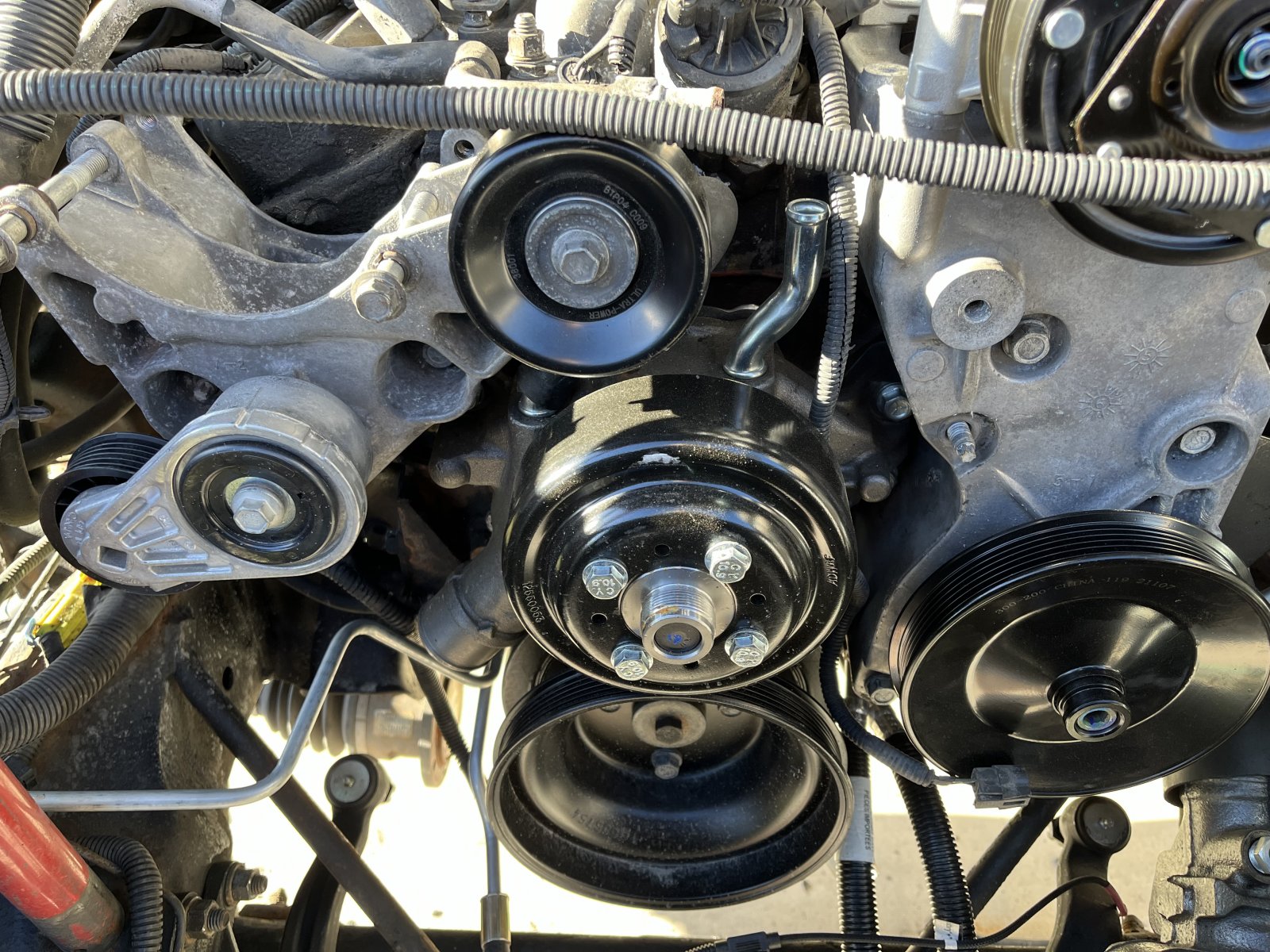

Update: got the axels out, and wrestled the front diff out, I took it out completely in prep for the Rough Country lift. Probably gong to send it to the shop to have 4:56 gears put in it. The I removed the oil pan and put it in the parts washer, probably going to have to wire wheel some parts of the outside and repaint.
I also picked up a new melling 155HV oil pump, shaft, and a cloyes timing set. I’ll take more pics tomorrow but here’s 1 for now
