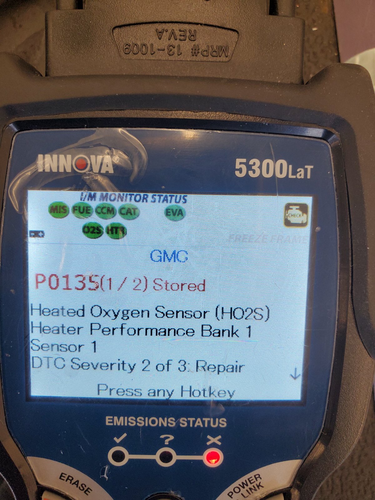

Really appreciate all the help I am getting. The Vehicle saw 42F so of course the check engine came back on. Fuel port door does show an E85 sticker.
PS vehicle came with a shift manipulation software change, OEM code readers cannot get past whatever this software changed. Autozone code reader ended with an error, and miss identified the vehicle as some 1215 chrysler and gave code report was bd2, as coil, sparkwiring and plugs. O'Reilly code reader did see it as GMC but did not not identify the vehicle model but produced a PO135 code(1/2) Stored, image below.
If O'Reily code is correct, clerk mentioned the O2 sensor can be cleaned. Is other then wire brushing needed?

I have never heard of anyone cleaning an O2 sensor. If you are going to go through the hassle of removing it from your exhaust pipe to try and clean it, replace it and be done with it.

Since the code points to the O2 heater, why not measure the resistance of the heater element in the sensor? Also, is the fuse for the heater good? Getting power all the way to the O2 connector?
