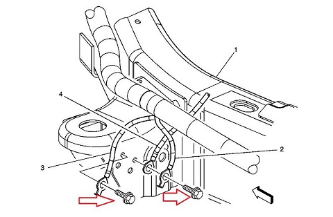

Did you inspect ALL of the electrical ground points on the motor and in the engine bay to ensure that they are clean and tight? Many otherwise unexplainable issues end up being ground-related issues.
@Joseph Garcia
No I didn't. This is one of those times you can look back on and say, "That's how I learned that."
So thanks!
How many of these things am I looking for?
