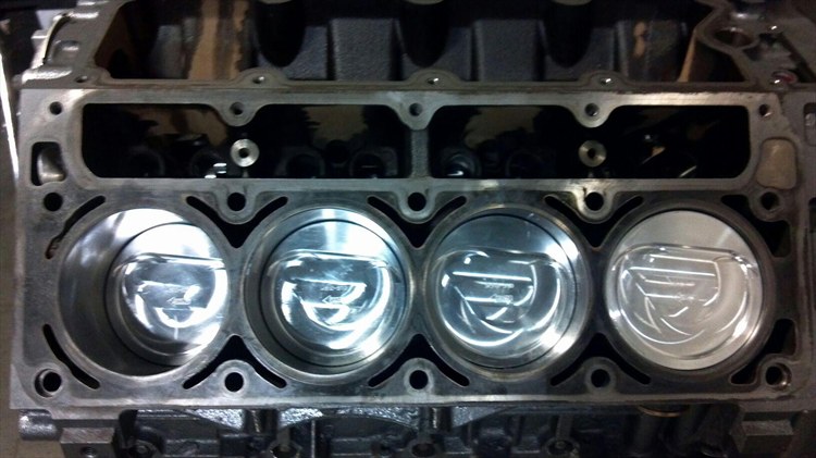

Well since i had 80% leak down in about 6 cylinders i pulled the motor out and that's what i found!!! sent the block/heads out to the machine shop to do a .030" over bore and mill the deck to 0 but i have not found a set of pistons i want run yet and i have been thinking about getting a complete stroker kit but i dont want i really dont want to throw away the forged h beam rods cuz i only got like 5k miles out of this build config. ....anyways any build configs or set ups u all may like to see be done plz let me kno and any advice would be greatly appreciated! thank u to all
any1 unfamiliar or curious with what i had, heres it is ...

From the pics of those pistons I would suspect that the bottoms of the bores were not deburred prior to assembly which caused excessive skirt wear at BDC when the piston rocks in the bore. After boring and honing there is usually a sharp edge at the bottom of the bores unless your machine shop deburrs it.

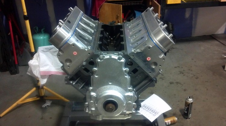

LQ4 built n/a quick build history
70k miles lq4 with stock 4.000" bore when pistons n rods were installed....story goes!!!...i had accumulated over the last 4 years everything for the build and wasnt really ready to put it all together but the transmission went out n i ordered up a performabuilt level 2 with 2500rpm stall tqconv.(based off motor specs i was bout to build minus pistons,rods)and since i dropped the trany/transfr i decided to jus pull the motor and install the top end..once the motor was broke down to a short block i pulled the trigger on rods n pistons. parts showed up when i wasnt at the shop and my boy took the liberty of installing the bottom end with out any eye witnesses to verify his so called blueprinting which didnt require any build sheet or hand notes on scratch paper or any references/books NOTHING@ALL?????!!f**kin guy.but he was my boy(not nemore)!!!So yeh i pretty much knew how he did it! cig.and beer in one hand a drill all cocked sides ways every which way but straight while honing:( but after inspecting the cross hatch/hone cuts in the cylinders it was time to move forward with the build and went ahead and built the motor in sequence and once installed in the truck checked compression and ran through all the standard systems tests n checks which were all in spec or no issues...the truck ran very strong and consistent up until i started to feel a mis. n i screwed up n over revved then yeh lol i knew the missfire was mechanical n thought i blew the rings or jus lost compression cuz of who did the bottom end...and now here we r!! .....thank u to all!

Were the rings a file/fit style? Did he even bother checking the end gap or piston to cylinder wall fit?
Sorry about your luck.
.030 over should be fine for a 6.0. If you want to have it sonic checked, some 6.0 blocks have enough thickness in the bores to go pretty large, .065 (6.2l size) or even larger.
