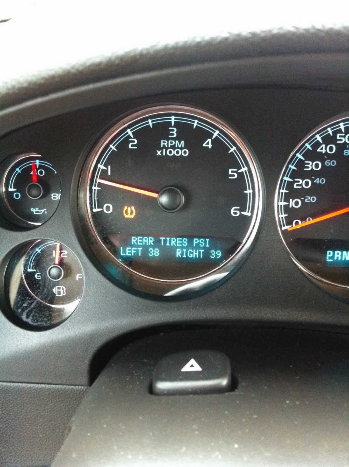

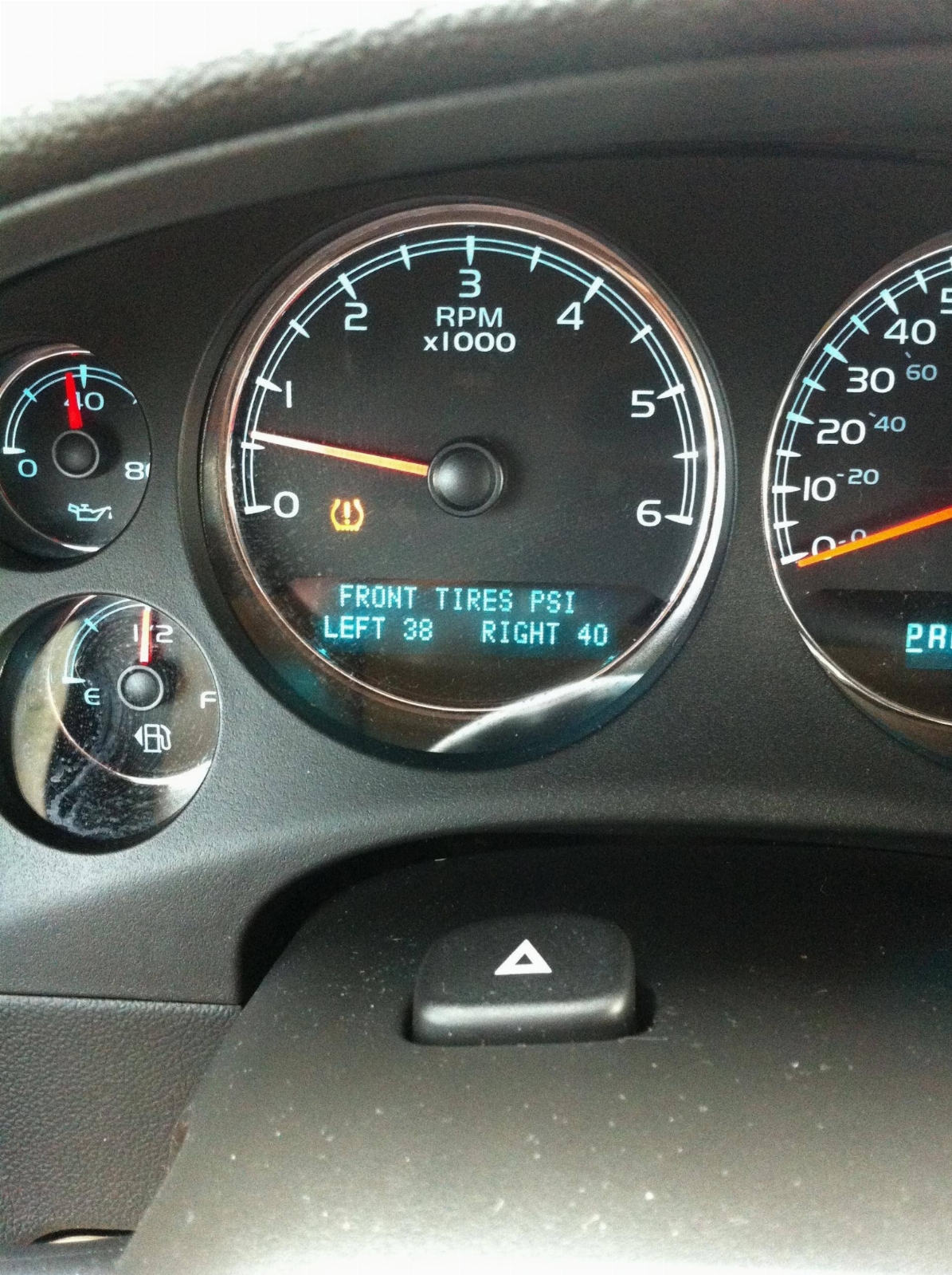

So I drove about 3 miles this morning already and the light is still on. After driving a little bit and the tires heating up, three are reading 34psi and one is reading 35psi. It's so weird because I took a long road trip a few weekends ago (about 1,000 miles) and I inflated the tires to between 38 and 40 psi for the trip and the warning light never came on. That's why I assumed a tire must have been underinflated rather than overinflated. I don't know why that would change and suddenly it's warning me about overinflation.
Anyways, I've got about an hour commute to work in a little bit, so hopefully I'll see the light turn off during the trip.

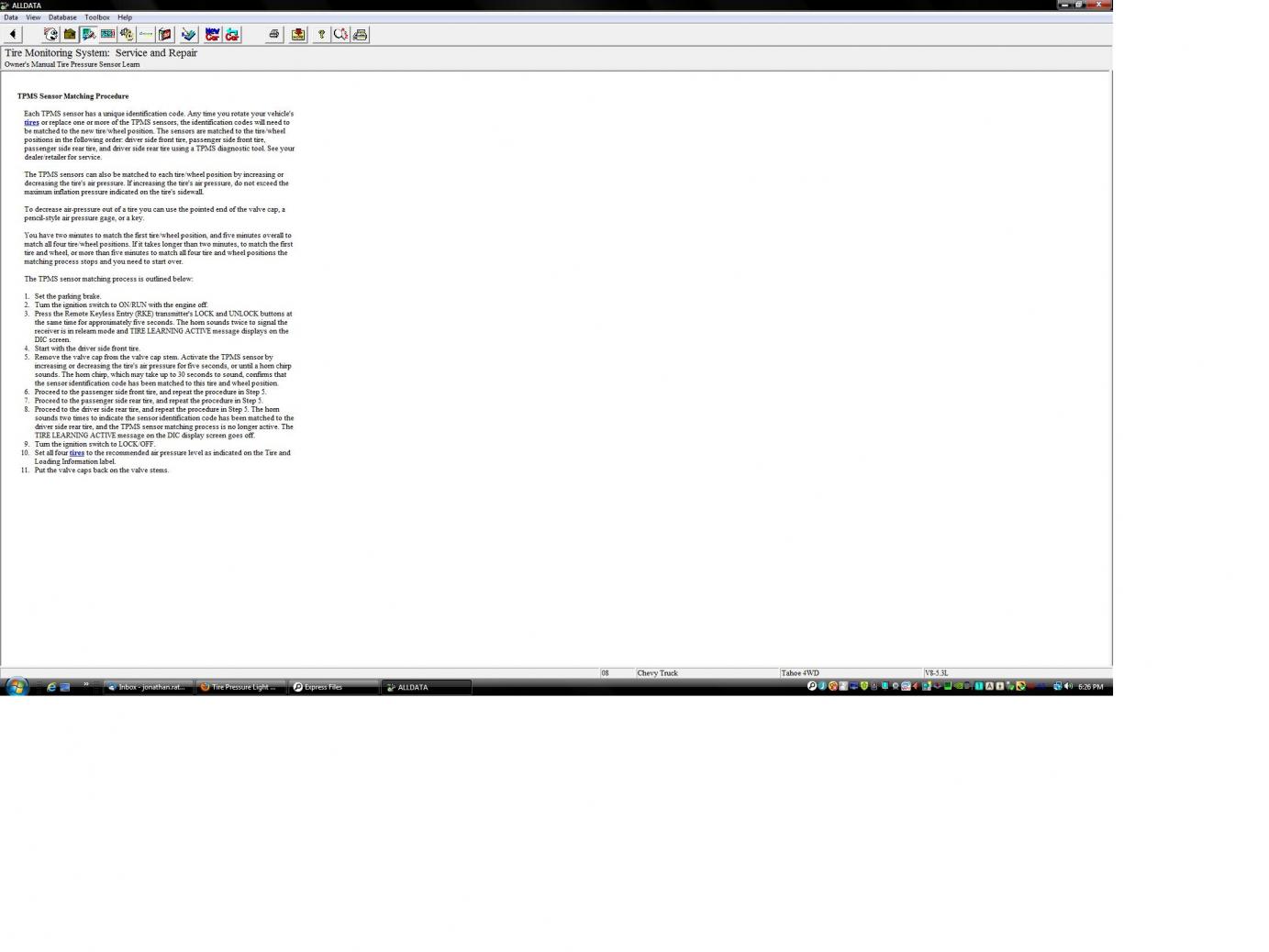

I would just go through the procedures to "relearn" the tire pressure you have now, there is a step by step in the owners manual. Hopefully that will reset everything for you.
