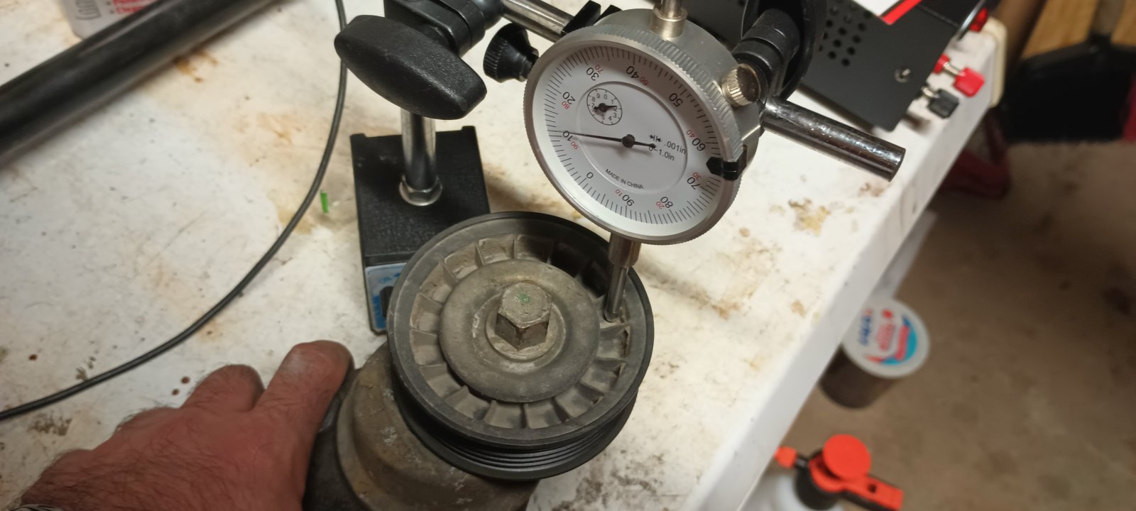

I just checked the tensioner of one of my trucks. I only measured 10-20 thousands and looks like it's in the actual plastic wheel. Not a lot of movement. Looking at your video again looks a lot more on yours.
Thanks for checking yours out. Pretty sure that's the issue, but it isn't really old
