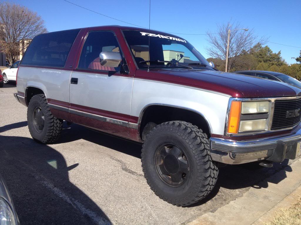

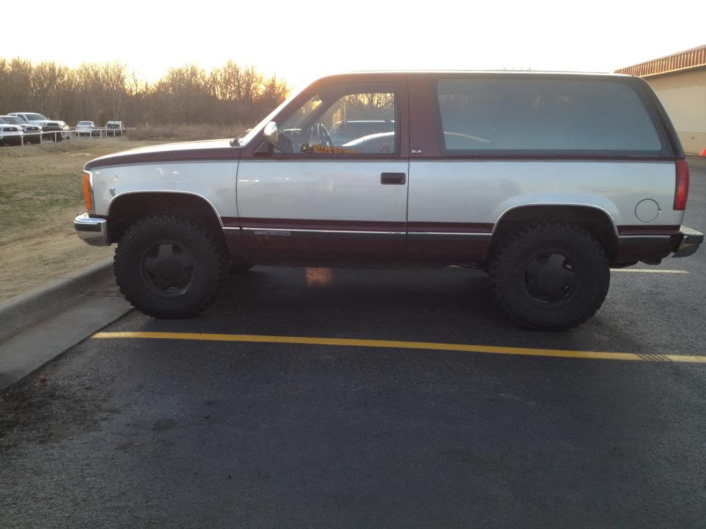

As far as ride, it depends on how much you crank them. Max out the TB and you will get a rough ride. And yes you can clear 33s but 285s are 33s so you won't see much difference with height Heres pics of my truck with the front cranked and the tires. Hoper this helps
