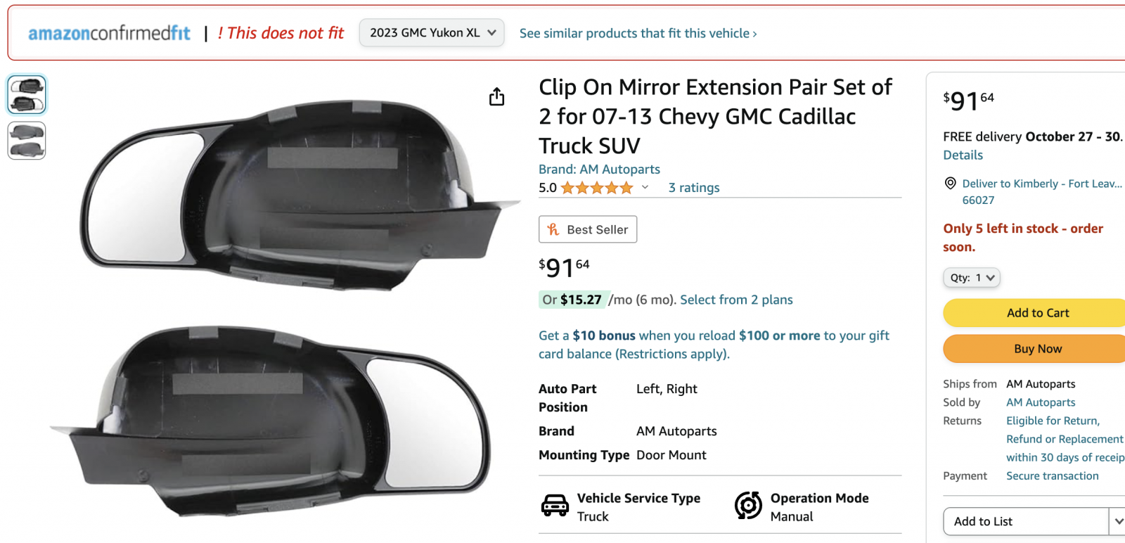

Thank you for your comments and yes we will be using a good WDH. Also does anyone know where to find good clip on tow mirrors, I do not want the ones that have straps. Thank you again.

We had two pairs of the clip ons (one on our sierra and one on my tahoe) and I will warn you, they were great while on, but those suckers were so hard to get off I thought I'd be ripping the entire mirror off with it. If you always want them installed, go for it, but if you want them to be easily removable don't get ones like this pic.
Thank you noted. And yes main thing I will make sure the dealership we buy the RV from gives us good wdh and sway bars
