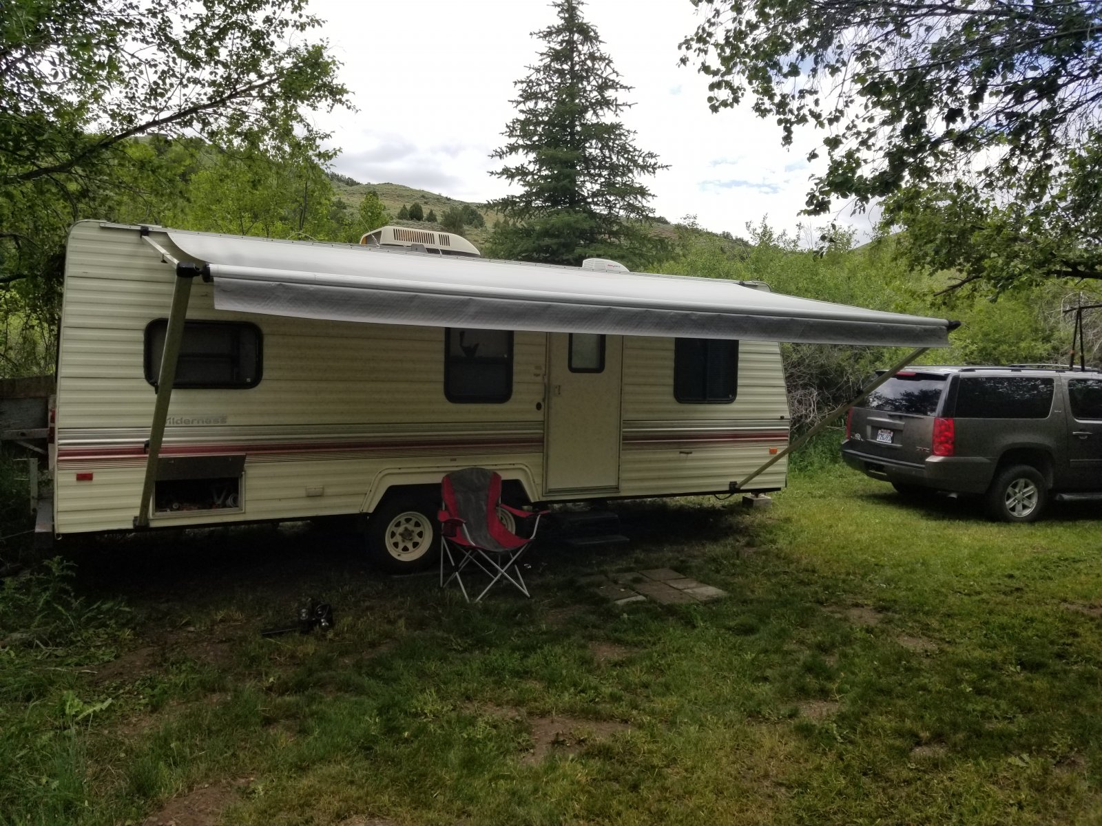

I managed to get a pic this weekend, not hooked up but gives a good idea.
Nice! You might just want to replace the radiator with those miles on it. DO NOT get an aftermarket radiator as they do not have the built in restrictors that keep the temperature in check.
