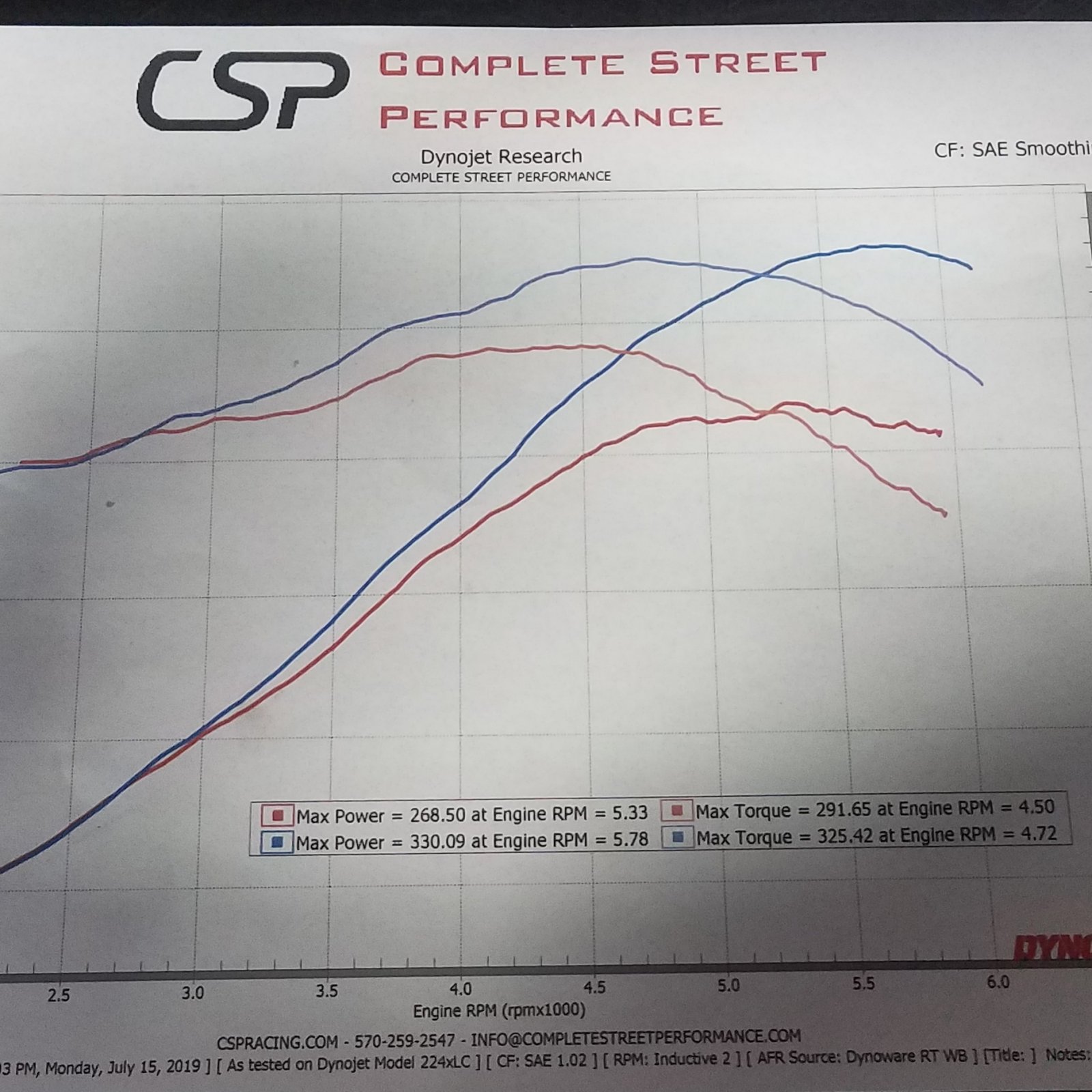

Did a bunch of motor work to give it a little more pep.(currently getting tuned)
