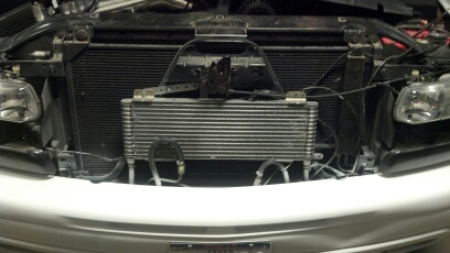

You got a good one then, the 4L60's are widely known to be unreliable. Towing just a 10ft trailer with ATV on it you might be able to tow with tow/haul on and in D depending on your gear ratio. I always drove in 3 unless I was on the highway with my '07 tahoe. Do you have a trans. oil cooler? it is an option, if you do not have one...get one, even when not towing it will reduce operating temp of the trans which will help prolong the life of the trans.

I ran a Long Tru-Cool 30k on my tahoe and it was more than enough even with a higher stall converter, towing 6k with it and temps never broke 140-ish. Alot of people opt for the larger 40k model, but to me it is way overkill on an otherwise stock truck/suv.
