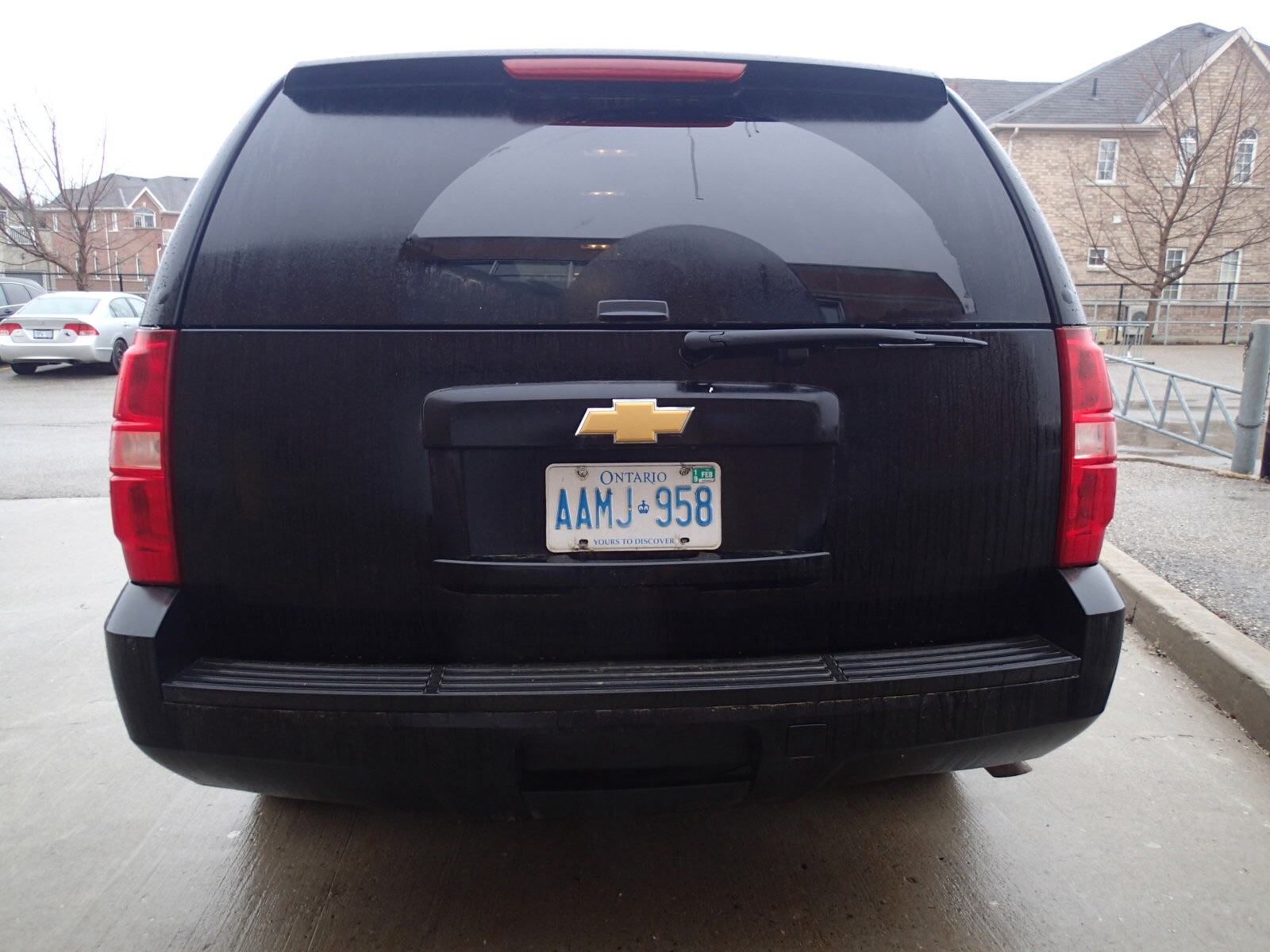

I'll post pictures and details when I get one found...if you know any sources in southeast area let me know.
---------- Post added at 11:26 PM ---------- Previous post was at 11:04 PM ----------
I haven't found one yet except I can get one from GM new but it would be rather pricey. I have a few sources in this area I will try next week. GM did tell me that the straight metal bumper piece you can see in the picture can be removed and replaced by the OEM piece, which is why I am thinking it will be more plug and play.

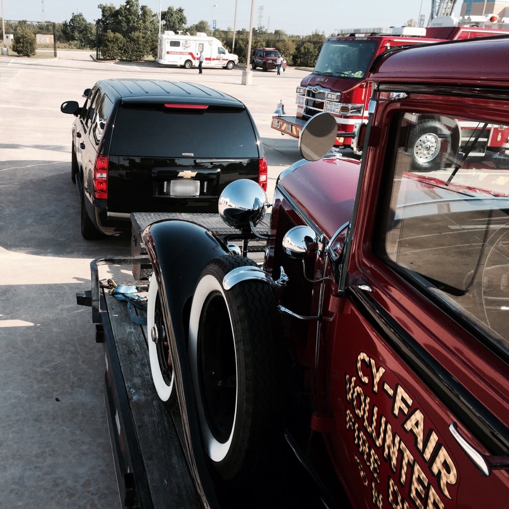

I wanted to re-open this thread, as I'm looking to tow with my PPV as well. The difference is, I'll be towing our department's antique Chief's vehicle to events, which weighs 3500 lbs + 18ft trailer.

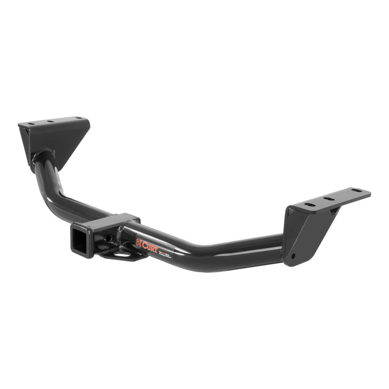

First off, the hitch below is built SPECIFICALLY for the GMT900 PPV. It's $130, so there you go.
http://www.amazon.com/CURT-13161-Cl...TF8&qid=1442938204&sr=8-1&keywords=curt+13161

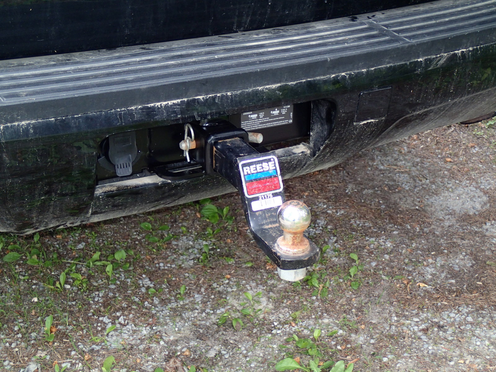

That hitch is NOT something I'd want to tow very much with. Maybe a lawnmower or yard waste but not a 3500lb vehicle.
You need to find one from a yard. They are referred to as "rebar". Look at car-partsdotcom and browse through there site or call local yards.

992dr, I believe you're right. All of the City of Houston PPVs look to have them, and the 10 we got came from a department in the Tampa, FL area, and all of the ones I saw from there had receivers. It looks like it would provide a convenient tow hook hookup spot on the back of the truck should the truck get stuck in the mud, which is a common issue around here.
It seems some folks see PPVs local to them that don't have them, so yeah, it's probably a line on the order sheet and the department has their standard selections. IIRC, single or dual spotlights are also optional. Our truck has a single.
