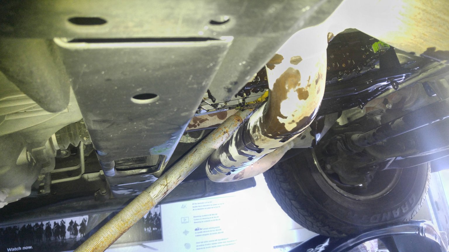

The shift linkage is located on the driver's side of the trans. The two Torx screws are on the top looking at it from the ground towards the rear of the trans. Those of us with a 4WD or AWD will need to remove the front D-shaft from the front axle to gain better access. It will rest on the exhaust Y-pipe. Some have done it without removing it, but I couldn't tell you how.

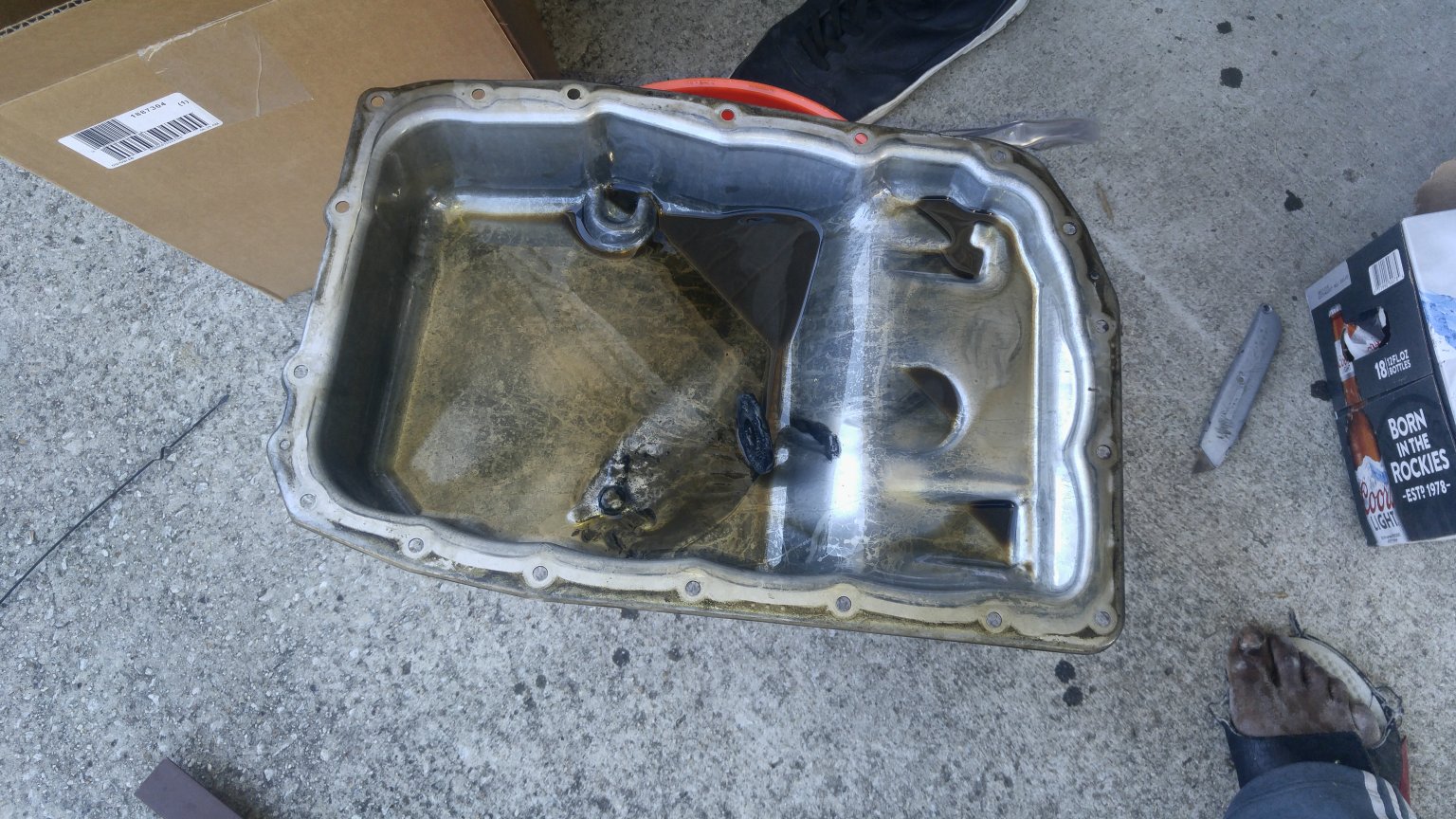

Let's turn our attention to the pan. Here's a shot of mine after removal.

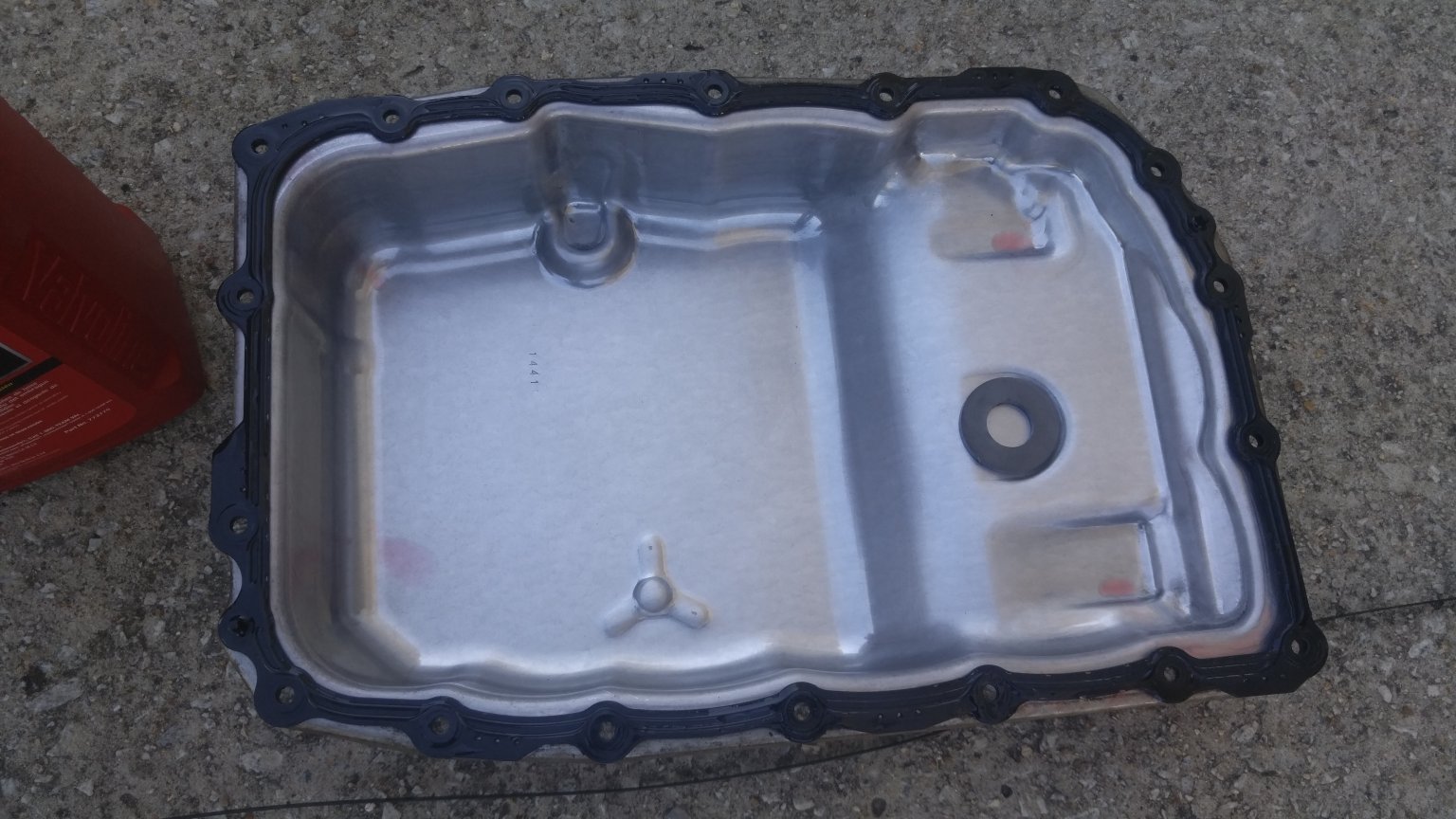

Remove the old gasket and clean the pan and magnet. Use a couple of bolts to orient the new gasket and secure the pan back to the trans. Replace the remaining bolts and get them finger tight. Torque them to 97 in-lbs. Next, replace the rear Torx screw on the shift linkage bracket and tighten the front one.

I had to unbolt the front driveshaft, remove the shift linkage (PAIN), and unbolt the rear of the y-pipe to get the pan out. The y-pipe was the worst because a bolt broke and I had to spend time after the flush drilling it out and replacing it with new stainless hardware.
