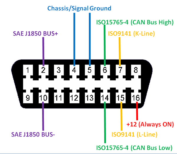

I have a 02 Escalade out the blue the trans seemed like it shifts from first to 3rd an that’s it No grinding slipping whining or anything before that also when you plug the obd2 in it gets power by not reading codes I hear lighter is on the same fuse I changed fuse again it has power just not reading any suggestions if not it’s going in the shop

IIRC there's more than 1 12v outlet fuse. Been a while since I looked in the electrical bits box
Grab yourself a DMM and verify you're getting power to the 12v pin as a first check

Make sure your OBD port works! Take a look at a wiring /fuse/ground diagram. I think problems are connected.
Unless a OBD2 signal line from PCM is grounded, the port has nothing to do with the transmission whatsoever. The port is merely an extension of existing wiring. But I imagine if the OBD2 signal from PCM was grounded that could definitely cause some havoc.

And it makes it tough to get trans codes. Ground and short issues after 20 years? Leaky computer plug? Lots of possibilities, but I'm not there to look. He likely has other electric issues along with this.
