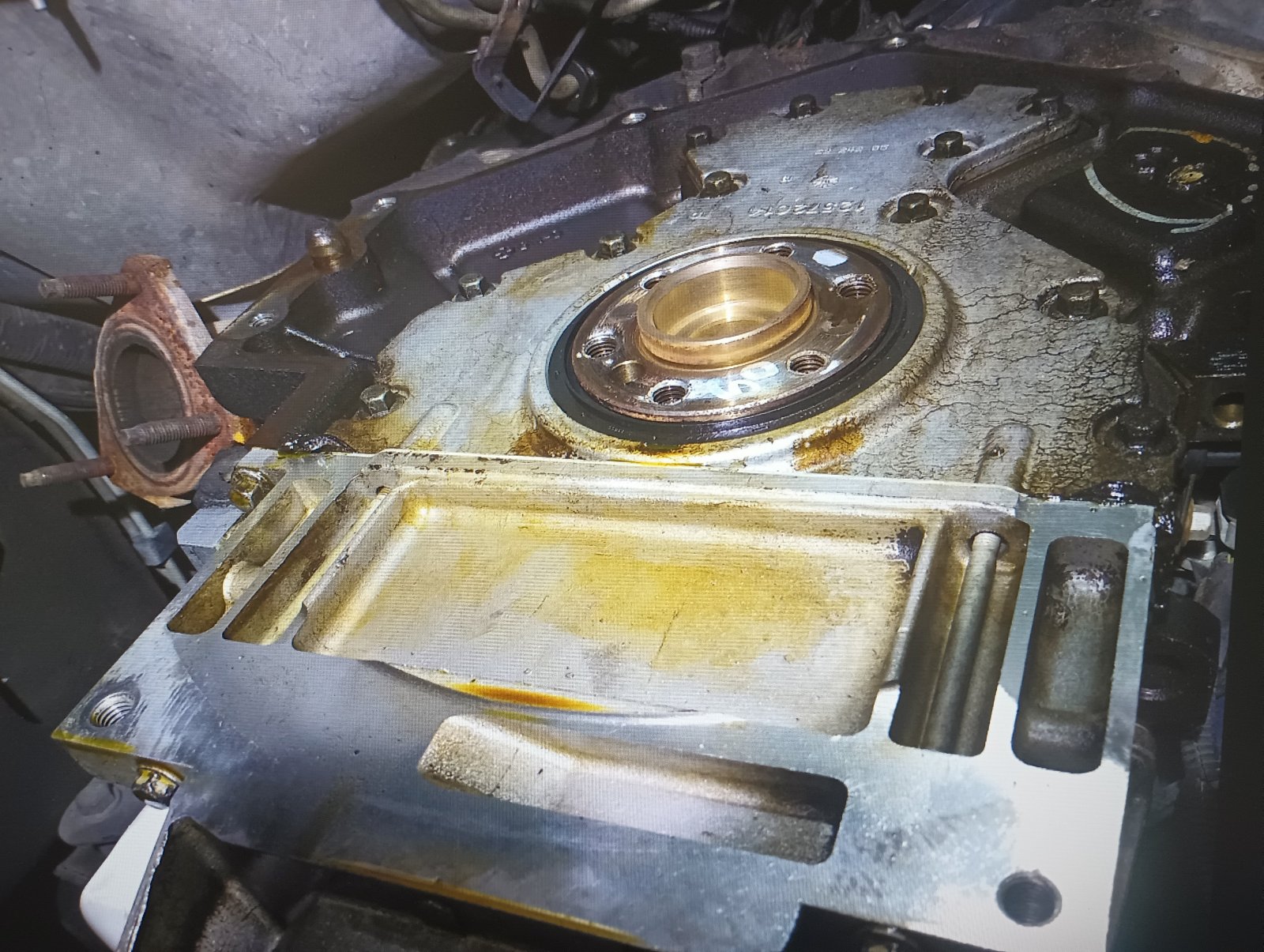

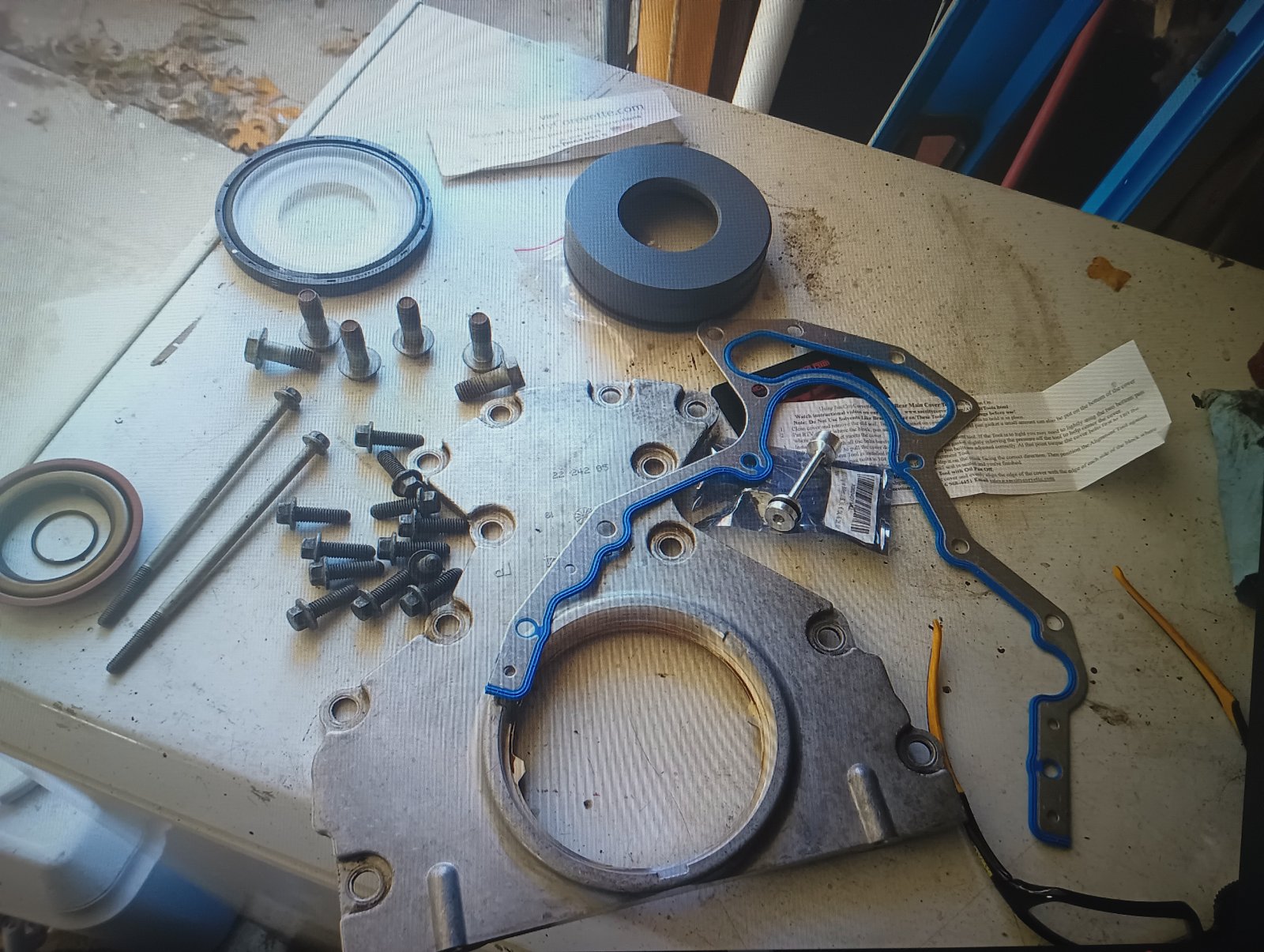

I did the rear seal last year on my LQ4/4L80e/2wd suburban. I had the bright idea to replace the front pump seal and lock up o ring on the transmission "while I was there." Of course, the local parts store gave me the wrong pump seal, so I had to go hunt another one at a different place. But putting damn heavy torque converter back was the biggest pain. I was working under the truck and had lift it over my head while the transmission was on the transmission jack. My upper body ached a good few days :confused:
