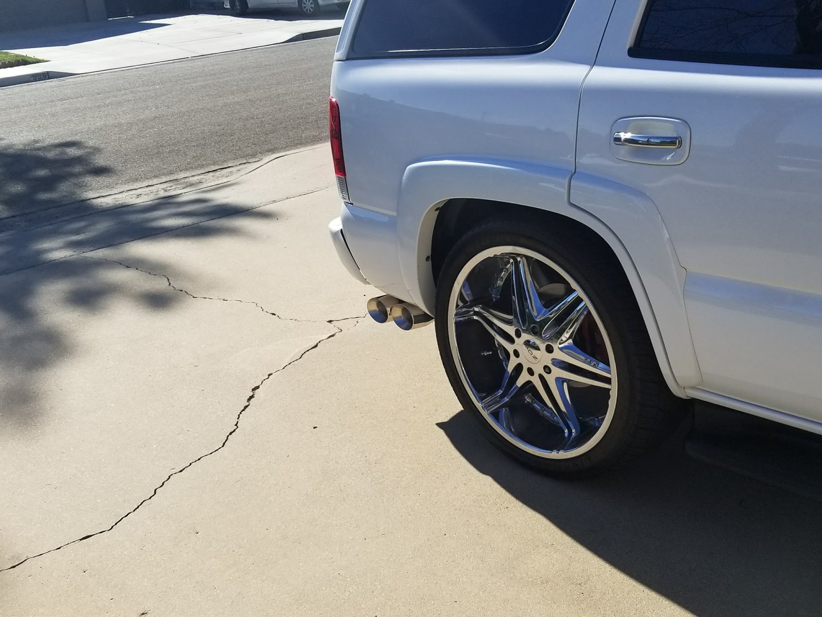

Took the ***** out on my driveway so she could dry and get some sun, Since all it knows is being in the garage
I also went ahead and finally put my bumpstops that I had for more then 3 years and finally now decided to put on, lol Thanks to @Fosscore
