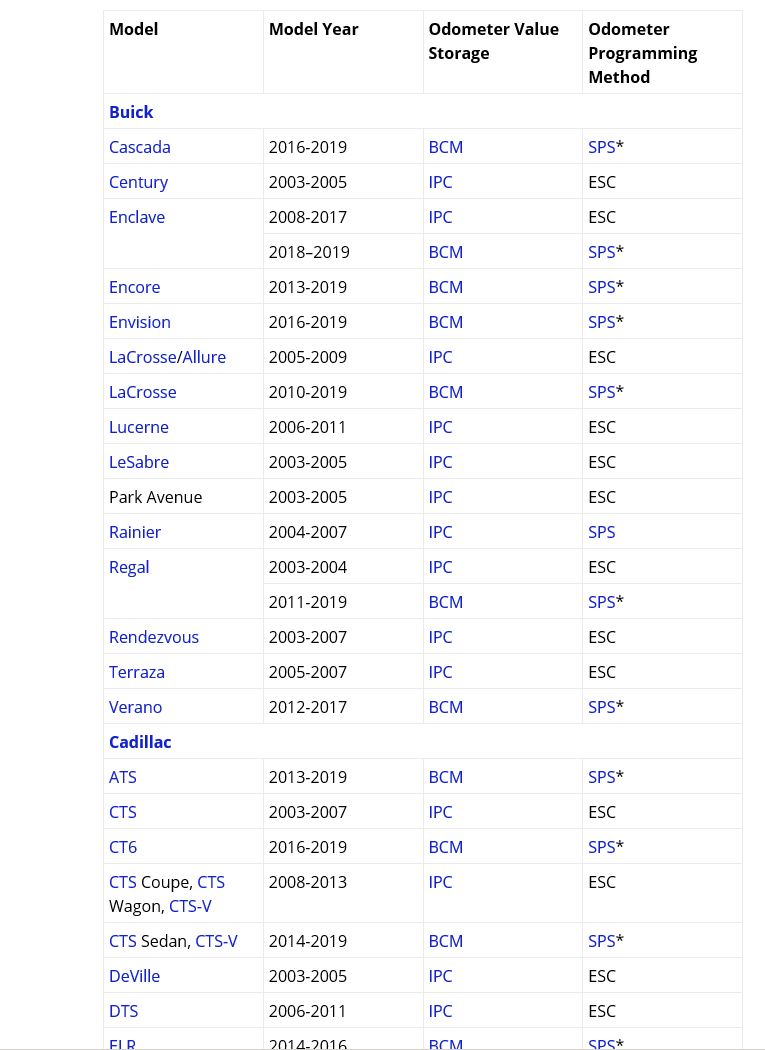

it's not very hard to pull the micro chip (eprom or aka flash) and reprogram it off the cluster it only takes 10mins to desolder it and solder it back on(plus reinstall of the other stuff)
with eprom reader , Serial cable and a hex editor
is all you need to change the miles on pretty much any car....
