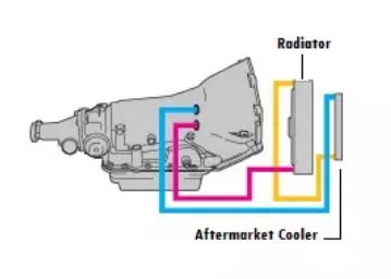

Is your trans still plumbed through the radiator, then to the Tru-cool?
The fittings on that thermostat look like just a barb fitting used with rubber hose and a clamp. Don't use a worm gear clamp, it'll leak in winter. Use a spring clamp.
Yeah I kept the radiator cooler connected. Somebody told me and I didn't know any better, that I'd not need the thermostat because I'm going through the radiator cooler.

Great question, I couldn't say, I need to trace the lines. I had really thought it was trans, radiator, cooler, then back to trans but honestly, I've never traced it.

Dumb question - because someone already probably covered it..... Assuming the "cooler" inside the radiator is still in play, which side would you cut into to attach an additional cooler? I like the idea that when it is cold the radiator might quickly heat the trans fluid to what it needs to be.

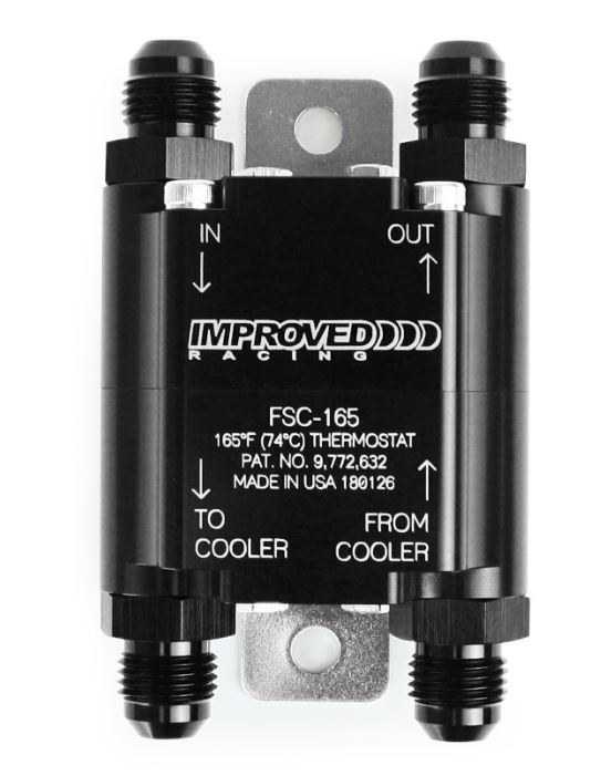

A thermostat I like is this one that comes with 6AN fittings and can be ordered with different thermostat settings. A bit pricey ($159) but in the grand scheme of things not so much.
