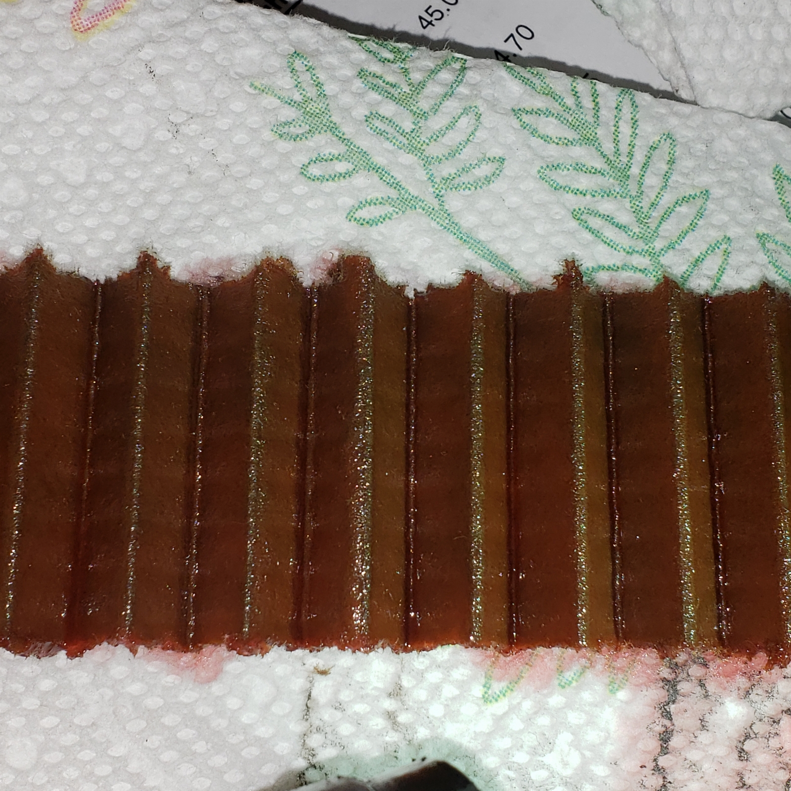

Haven't established a change interval yet. I did a trans service - drop pan, change fluid, filter, gasket, etc and popped the inline one in there at the same time. Ran it for 1000 miles, changed it, and it's been in there ever since. ~8kmi ago. I'll probably take it out at 15k and see how it looks, adjust from there. I'm not terribly worried about leaving it in too long. The filter has a bypass valve so worst case, it reverts to 'stock' if it gets plugged.
I just cut the soft part of the line going from radiator to external cooler and chucked it in there. Was afraid to commit to it until I knew how well it performed. Been on my list of things to tidy up
The larger granules are from me cutting it open. This is 1000mi use, transmission extraordinarily well maintained. Just proves that stuff still settles out, and the trans filter is more or less a mesh. Changed first filter out early figuring it would get the dirtiest, the fastest.
Magnet caught some fine stuff. Even with 2 transmission pan magnets. Filter caught some small metal debris. ~popcorn salt sized
For the power steering one: I chucked it on the return line coming from the steering box. Have yet to open it up. Probably won't for a while. P/S is a pretty basic system, not a ton in there to shed large amounts of metal. And my fluid has been well maintained
