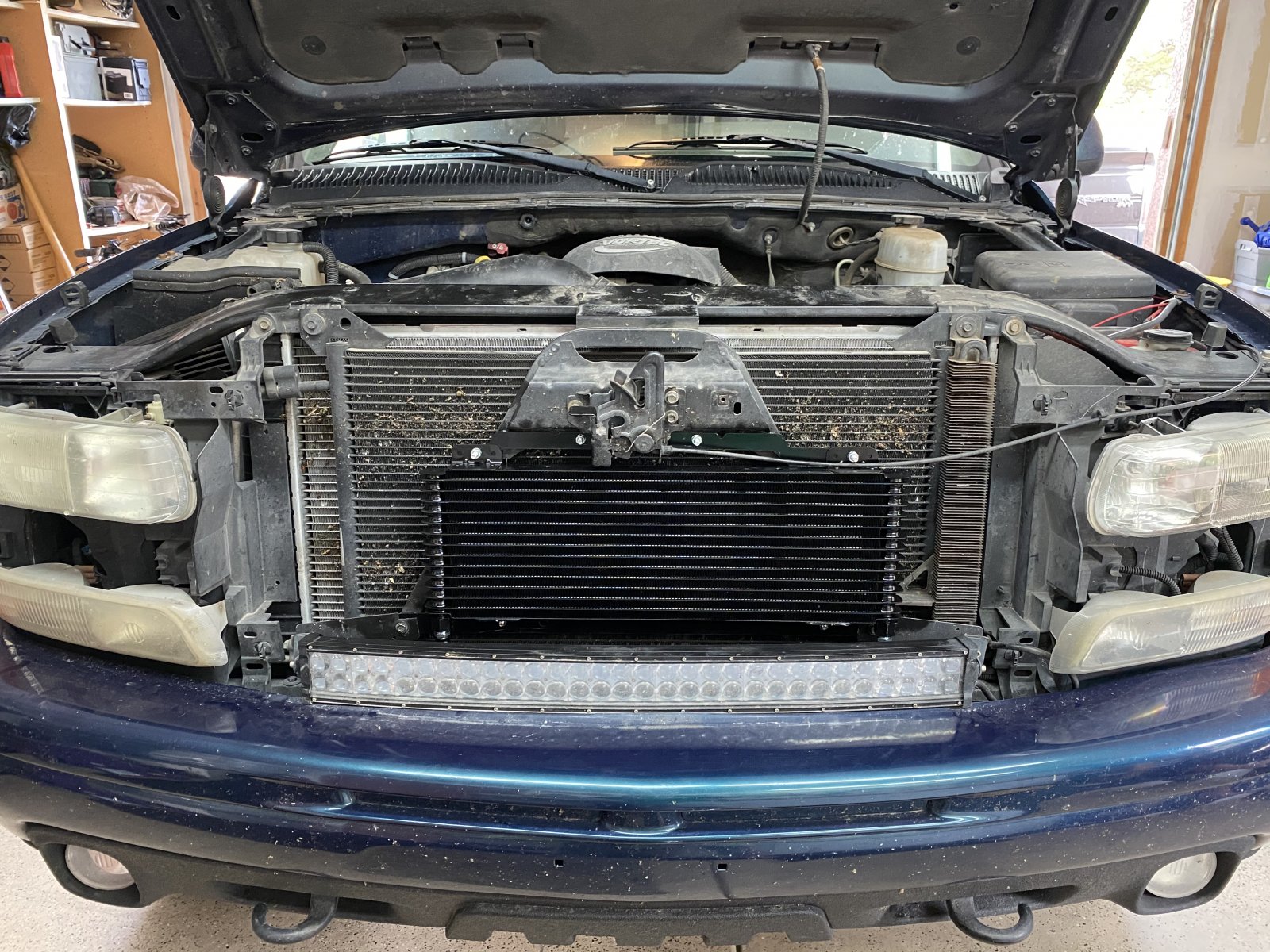

I just installed about a month ago a Trucool 40k on my 2002 Chevy Tahoe Z71, 5.3L (260,000 miles, first owner). I also had previously installed an instrument cluster from a 2001 Yukon Denali which has a transmission temperature guage. The result of the new transmission oil cooler has been a 40 degrees drop in temperature. Lately it as been around 100 F in the Houston area. My transmission temperature never goes above 150 degrees.

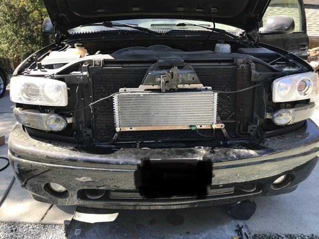

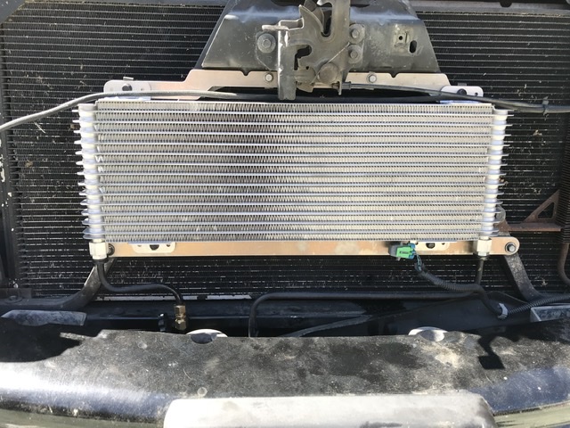

I used the original lines and connected the cooler to them using the rubber hoses provided. Also attached the cooler by just drilling a couple of holes and using the small brackets provided. No need to buy additional brackets. Installed it with the input and output on top.

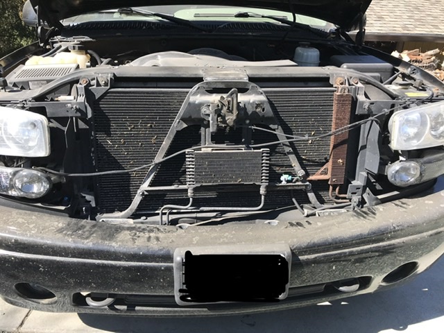

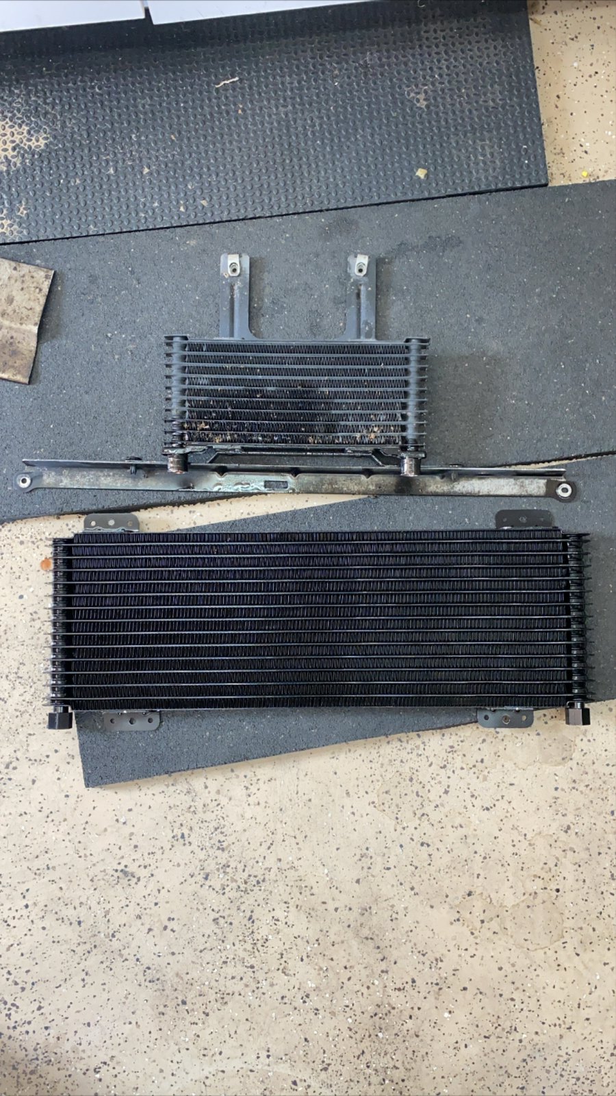

I hope you don't mind a post, but I just installed a TC 30K cooler, because it fit better between the beams, behind the lower grill. I left the rad. and external coolers in place, and plumbed it in series with the hose they provided; just cut the factory aluminum line and clamped the hose to the open ends. I still see ~160F on the gauge, but that's down from 185F in similar conditions.

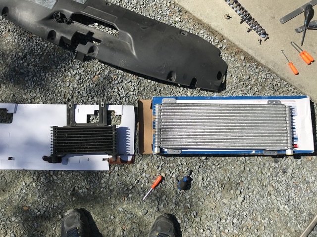

I used Glenns bracket on my Denali and the other one of that forum you referenced for my Tahoe, Glenns hands down is the better buy. The guy from the forum took forever with no communication and I thought it was supposed to come with the fittings maybe I was wrong on that part I don't remember well enough. What I do remember was wondering if I just gave my money away.
Glenns bracket comes with quality hardware and easy to install instructions. I used the compression fittings on both installs keeping the factory lines with the factory quick disconnects.
Expect to be about 30 degrees cooler running temps.
