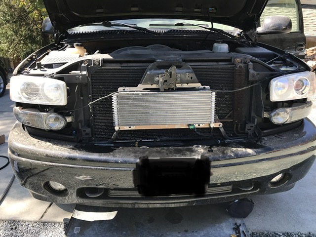

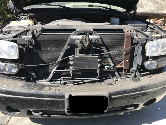

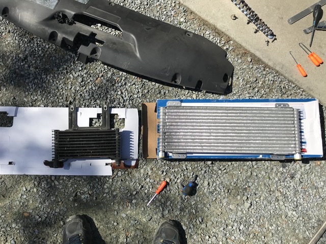

Used the stock fittings with no leaks. It has been a year. Just started towing. Even in the mountains my temps haven’t gone over 175 with my loaded travel trailer. Weight is between 5000/5200 pounds. Elevation 5000 feet. Will be going up to 9-10 k soon.
