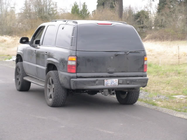

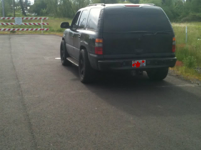

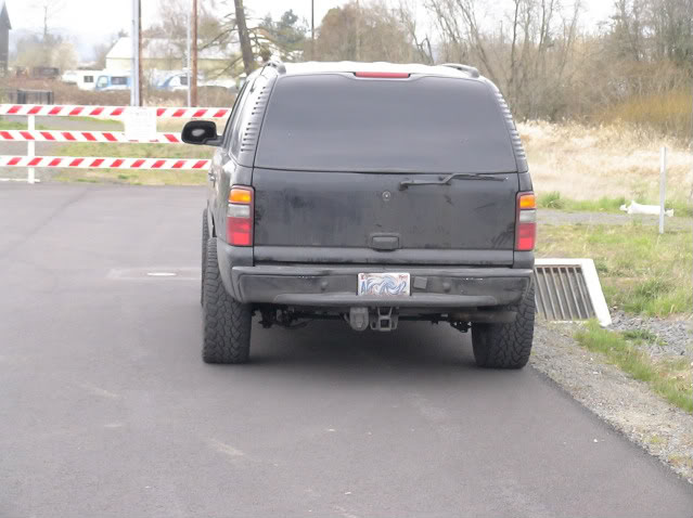

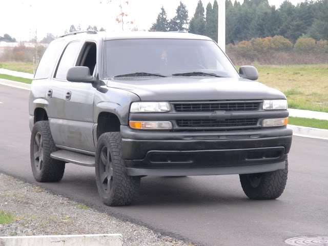

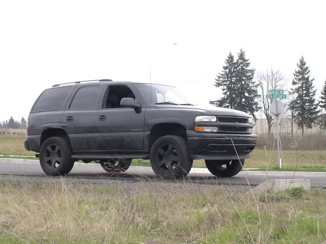

These pictures are OLD pics, most of these parts are already INSTALLED!
I need to install: GEARS, CAM (232/238 - 236/242 and Re-Tune after the 2"lift.
Do the 305/50/20 rub
slightly on articulation, both front and back. Im a 2wd. Not enuff to hurt anything if you drive with sense. I also have my t-bars maxed. Thats why Im planing a 2" lift.
