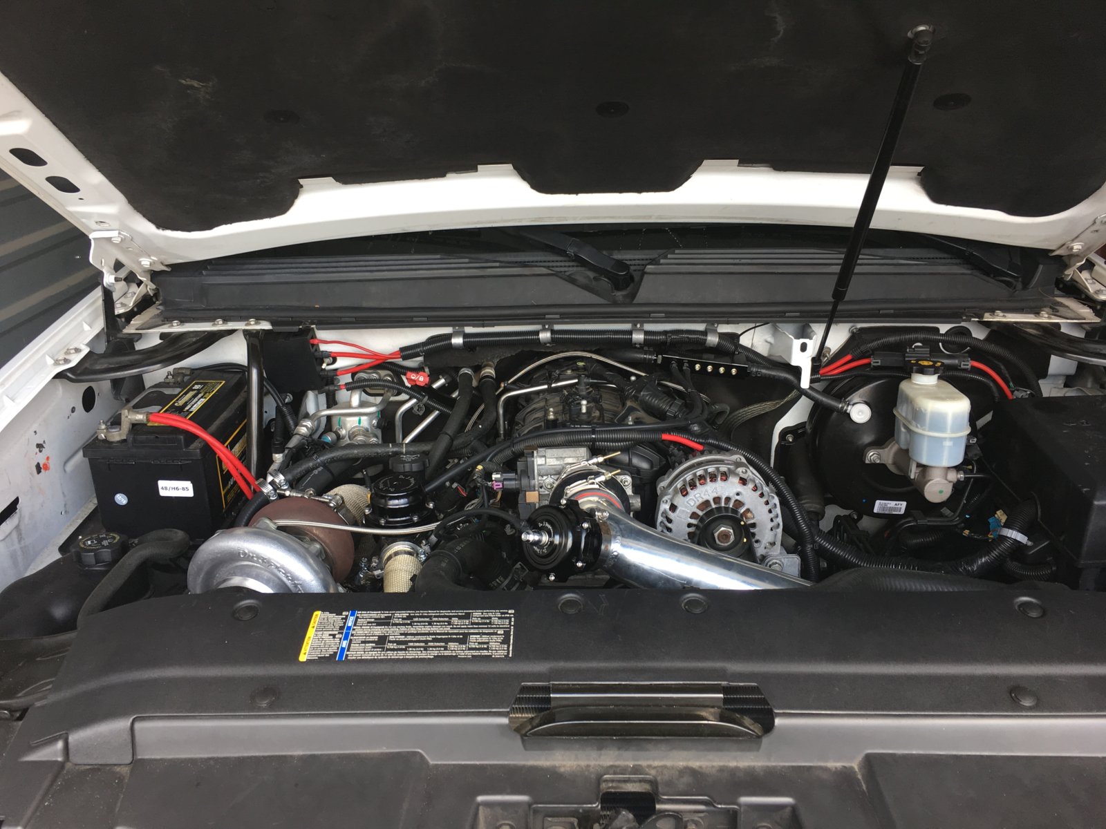

Did everything mount up no problem? Like the inner cooler? I saw some people having to make there own mounts for it
The kit comes with brackets for the intercooler which worked well. But to be honest if I were do it again I'd probably go with the trick performance kit for simplicity and what seems to be more quality parts in regards to V band clamps and T bolt clamps etc.
