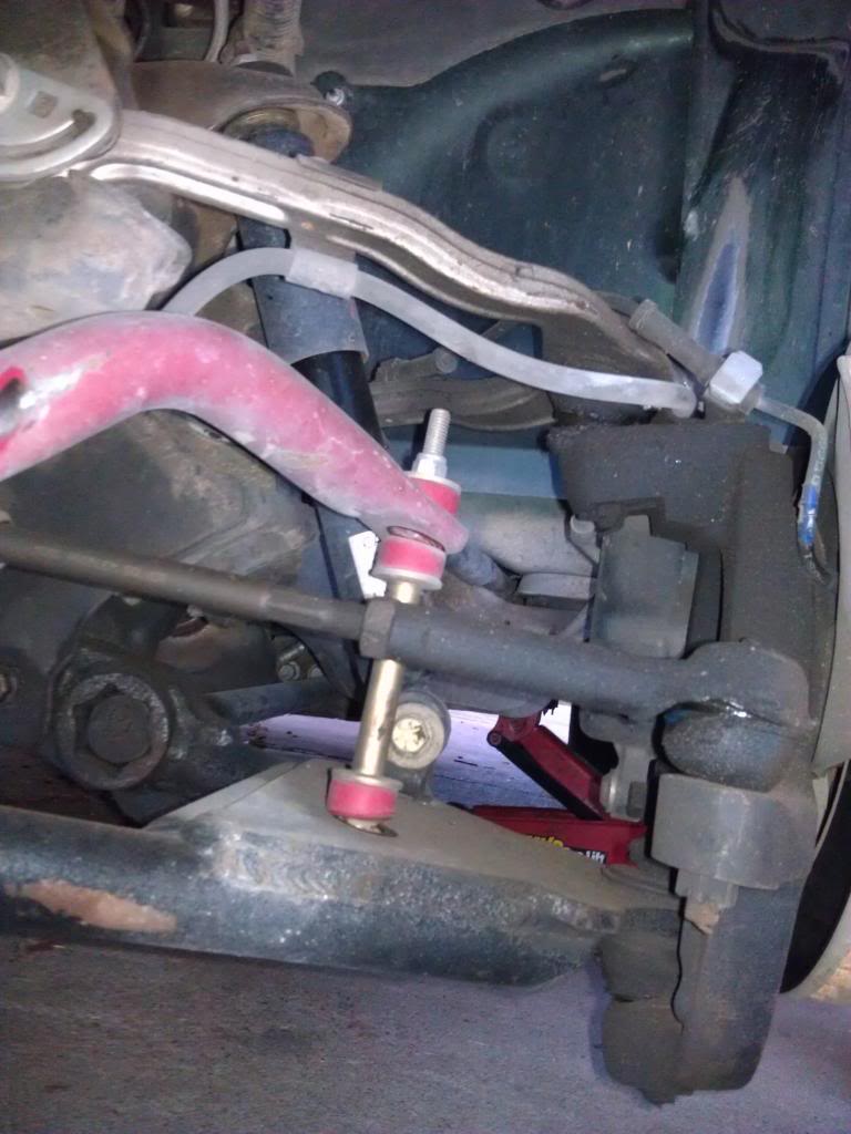

Hey Trace (MeanGreen03) Can you post a pic of your front setup? And side shot? You have drop arms and spindles right? Just wanting to see what it looks like. I have been contemplating throwing on some DJM arms I've got laying around. But want to see what the front would look like with both drop comps installed. And how low it gets.
Thanks

Ya I know. Asking to see his drop setup. Not upper arm setup. Pretty sure I read he has lower drop arms and drop spindles. That's what I want to see a pic of. I Just have never actually seen a pic of Tahoe dropped with arms and spindles, or setup that is. Seen supposed side shots, but never the actual suspension setup.
Thanks
Sure thing, will do. I'm switching my rims so I'll have the wheel off anyway. I bent a rim but they are discontinued and I can't find a set with the backspacing I need so I'm going back to a stock setup. But forewarning my tahoe doesn't sit as low as others with the same components for some reason. I have yet to figure out why...

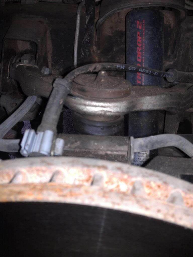

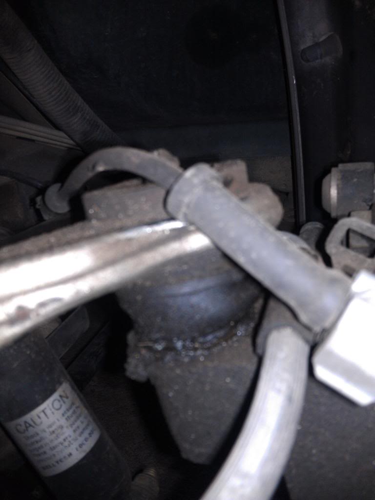

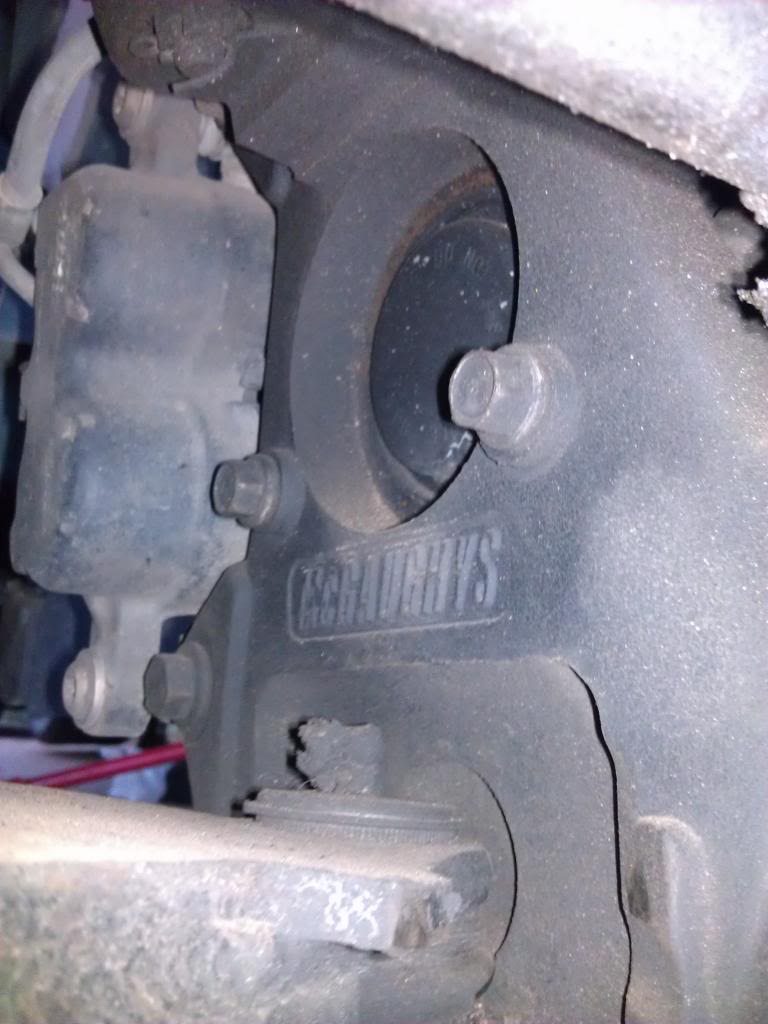

Here you go:
Mind you, I'm also body dropped. Like I said I have no clue as to why I don't sit much lower.

Only difference is spindle but you should sit a lot lower. How much are your key bolts turned in?
My drivers side is all of the way in and the passengers side is all of the way out. The passengers side is still a tad higher but I'm out of adjustment. I'm pretty much the same height all of the way around so I'm ok with it. It really wouldn't be too drivable if it were much lower with my 24's unless I got some smaller tires.
