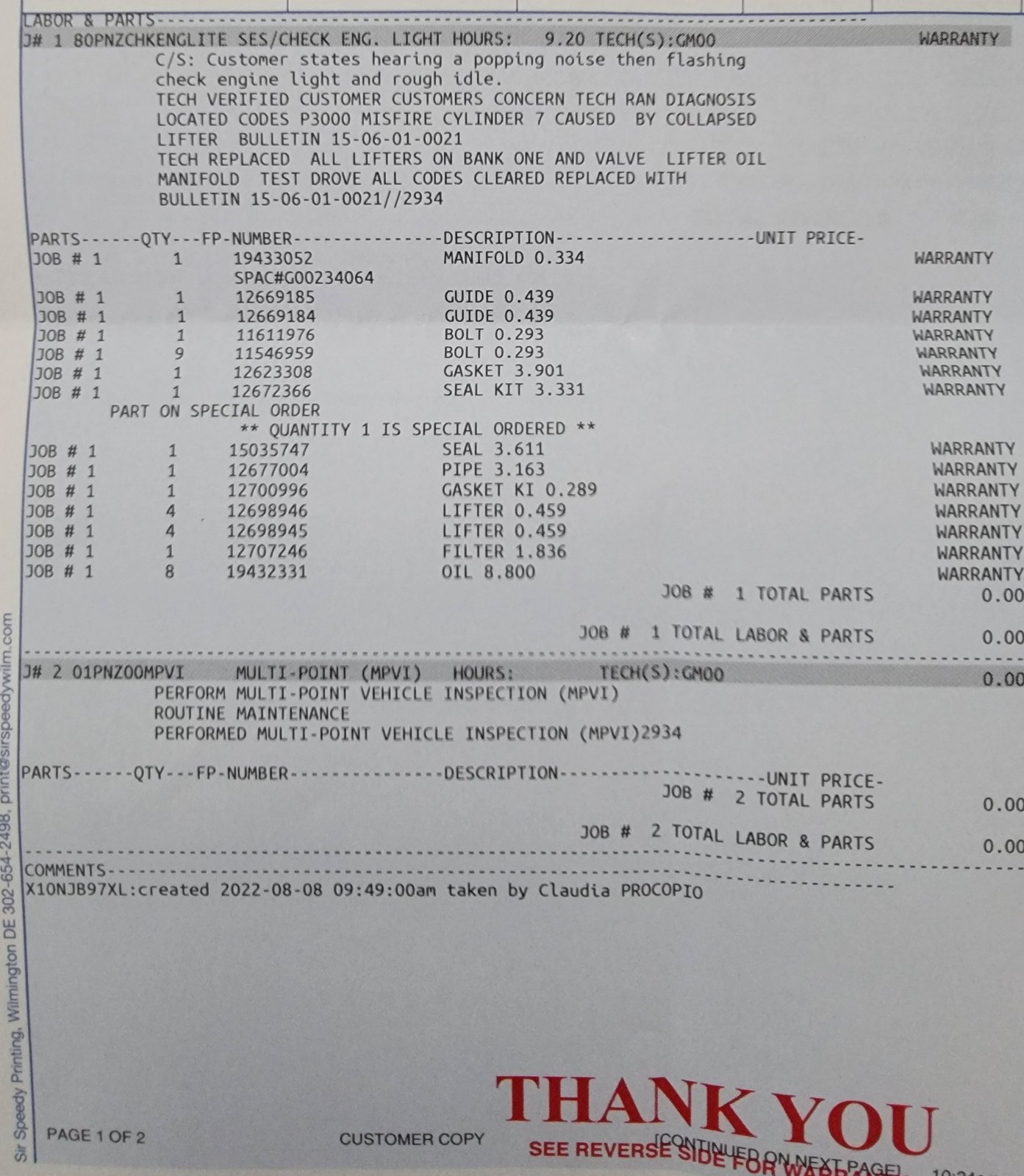

Yea, I knew an exhaust manifold problem/broken, just did not make sense to me and others here.
Yeah, exactly. I'm no mechanic but exhaust manifold didn't make sense at all. I think it's a little sad that two "service advisors" at this dealership didn't know enough about the repair to explain to me exactly what was going on. I hope their mechanics are more competent but I definitely won't be going back here for service again.
Lifter manifold oil assembly (LOMA) which controls the AFM. Makes sense seeing as you had AFM issues and misfiring. Probably just got lost in translation...
YES! That was the part that he said was on backorder. I believe he said it was the part that was redesigned to help alleviate this issue going forward?
