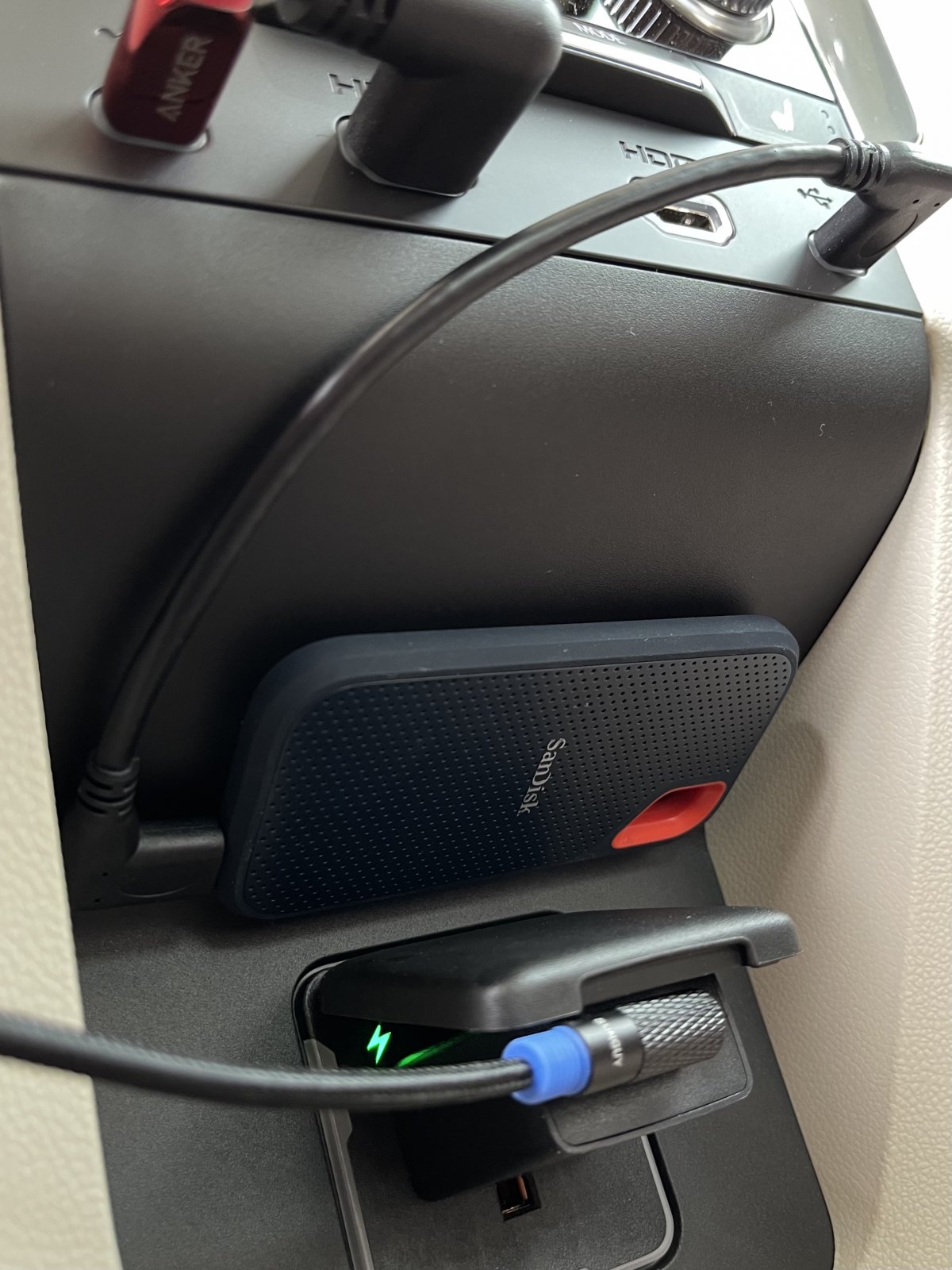

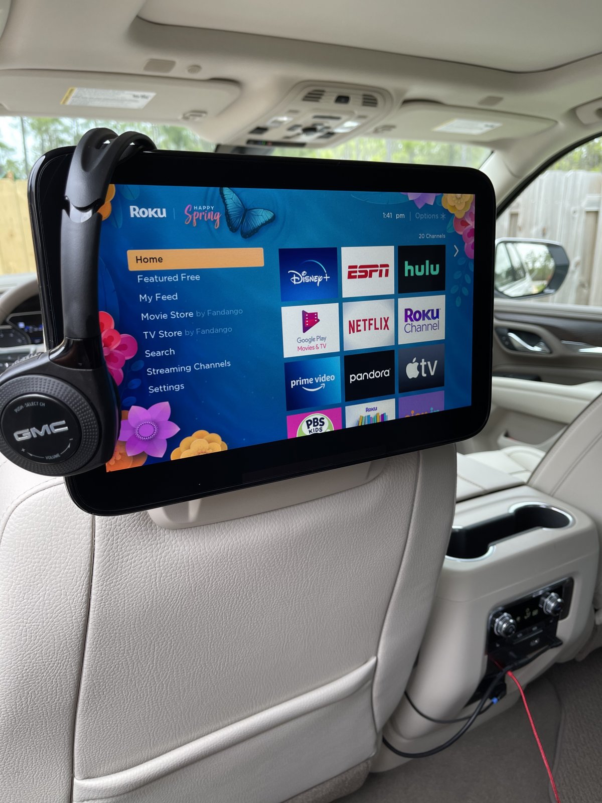

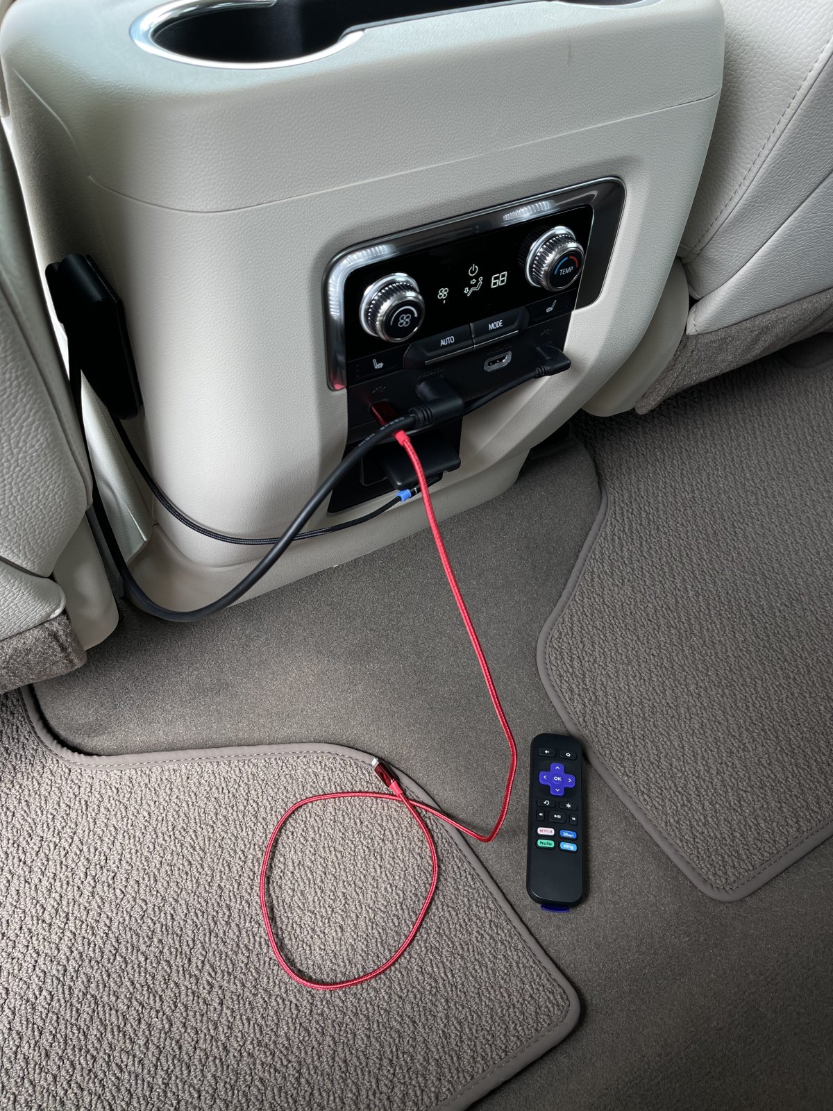

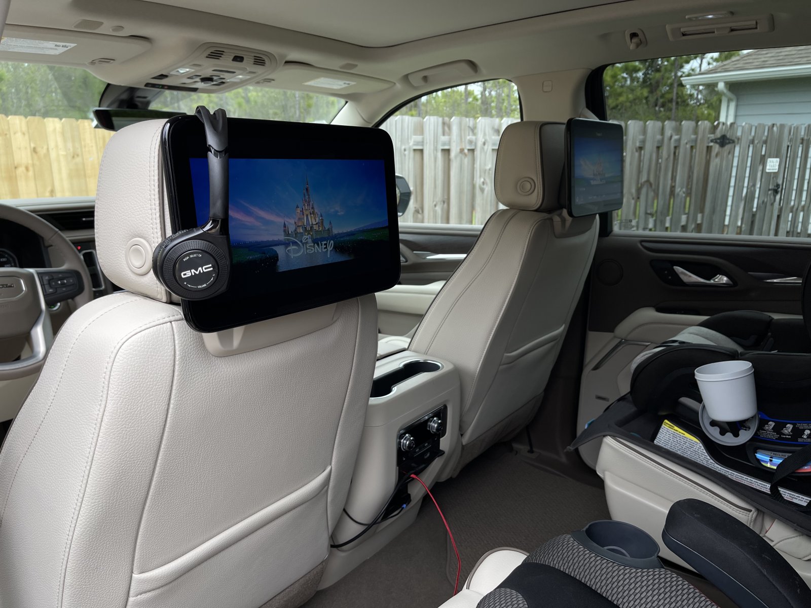

We have a Roku Express HD plugged into HDMI 1. I mounted this to the driver side of the console with double-sided sticky pads. It is low profile enough that it doesn’t seem to interfere with the seat at all. I went with this side because the older kid who will be operating the remote sits behind the driver. We signed up for the unlimited data plan for the in-vehicle WiFi for $15/month through Onstar/AT&T. It works great for the Roku and even an additional iPad connected to it at the same time, even in our small town. With the Roku, the kids can stream shows on Disney Now, Disney +, PBS Kids, Nick Jr., Netflix, Prime, etc. And the quality is great.
I also have a 500GB Sandisk SSD plugged into a USB-C port. I have about ~25 movies on the drive that can be viewed on either screen. The drive is formatted NTFS and works great. I used another sticky pad to stash it above the power plug, but it can also be held in place by the door for the plug.
