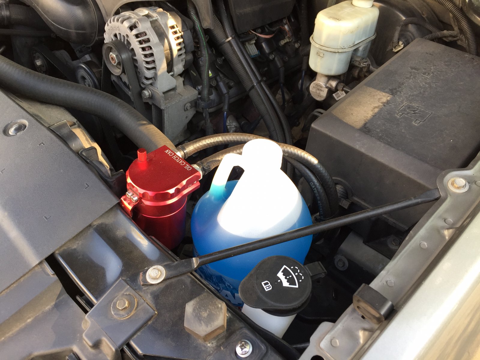

I found alternate location for my catch cans (dual system) to keep the 2nd battery tray empty. Used 1 1/2" aluminum angle, there are 2 holes predrilled under the front radiator plastic cover. On the firewall side I removed 2 plastic retainer clips for the top plastic trim there is metal under those so I used that as an anchor point for the little can. So if you want a second battery or storage this is an option.

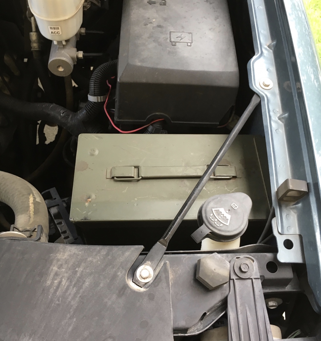

Wow! Thanks for all the replies! When I get back home I am going to look at the local surplus store for an ammo box with a seal that will fit there. I figure on storing my jumper cables and some other items in there. Will post when I have it done.
View attachment 251450 View attachment 251451
I'll have to see if my 2012 can have the can mounted in that area.
I didn't drill any holes where I have it, a hole was already there and a bigger hole is next to it that allows me to reach in and attach/hold a nut on the back side.
Also, with the tray underneath, it allows me to place a small butter tub under the drain valve and let it drain while doing other stuff instead of standing there having to hold it.
